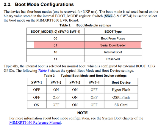

Secondly,  have you already tried to re-gain debug access by setting the MCU into serial downloader mode?  Basically the process is as follows:
  • 1) set boot mode pins  (on SW7) to 01.
  • 2) do a reset and a mass erase.
  • 3) return the internal boot config (and reset again), which by default on the EVK is 0110 on SW7.
  • 4) Finally, try to debug  one again.
