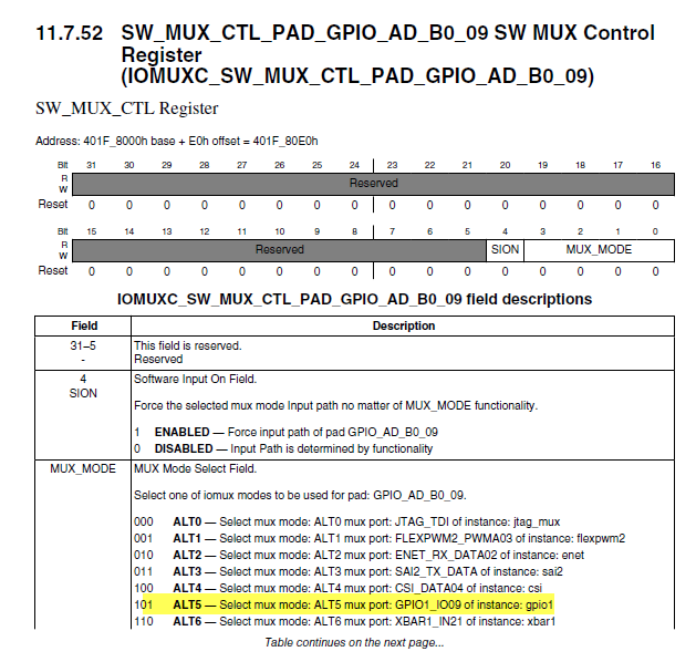

Note the bold section I highlighted.  Every example I've ever seen uses the IOMUX.  How do you connect a signal directly without the IOMUX?  I don't ever plan to use pads for multiple functions or for test and function at the same time.

   So, you need to check the pad which you are using, whether it is just one function or not.

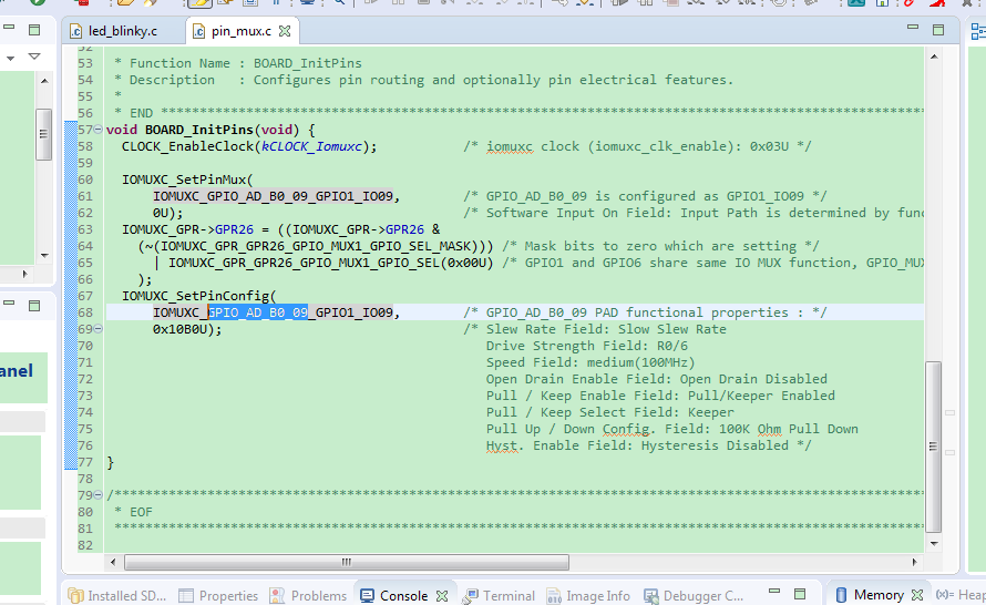

  Take the SDK led_blinky code as an example, it is using the GPIO_AD_B0_09 as the GPIO pin, so you need to check the GPIO_AD_B0_09 pin, whether it is just one function or not.
You can find it has a lot of functions, and the default function is ALT0:
So, you need to configure the IOMUXC.

I'm still confused.  The paragraph in the manual makes it sound like if the developer doesn't need to use a pad for multiple things there is some mechanism for using it directly without IOMUX.   But from what it seems like you're saying if the pad itself has multiple functions you have to use IOMUX whether or not the developer is not using more than one of the functions (and if the pad itself only has one function then you don't have to use IOMUX)?
