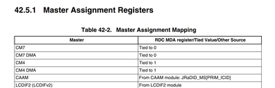

2. What is table 42-2 of I.MXRT1176 is trying to convey and how to use these values?

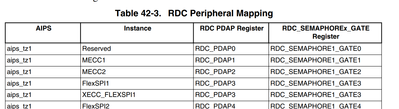

3.What is the table 42-3 is conveying and how to use those values?

2. 42-2 is the Master allocation mapping table. Each row in the table represents a master device, and the second column represents the register that determines the domain id to which it belongs. Some of the master in the table have domain numbers that are not determined by the RDC_MDA register, but by other modules or registers. For example, the domain number of CAAM is determined by the JRaDID_MS[PRIM_ICID] register of the CAAM module.
3. Each peripheral is managed in the RDC by two registers. One is the resource domain assignment register RDC_PDAPn with a corresponding resource domain, and the other is the semaphore locking register RDC_SEMAPHOREx_GATEn in the RDC_SEMA42 module. Together, they control the accessibility of the domain for that peripheral.
