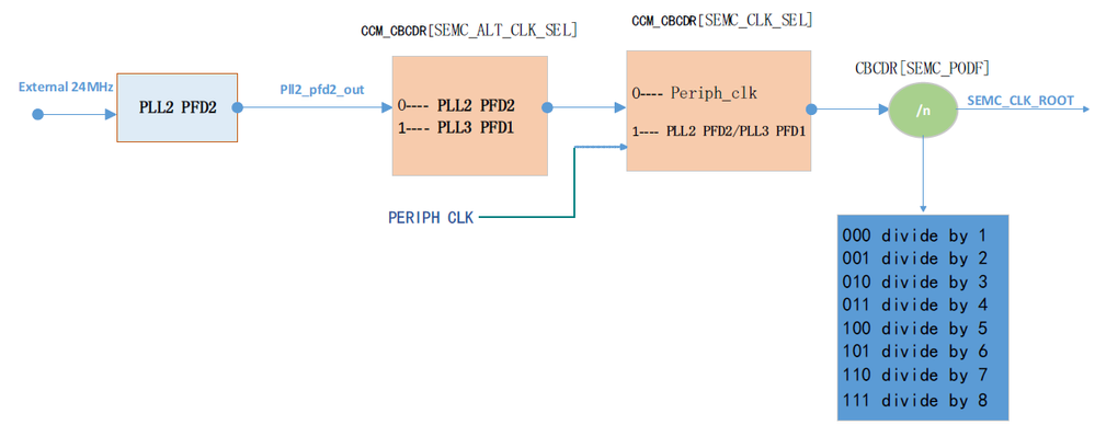

  1. The path of SDRAM Clock in Clock Tree
                According CCM clock tree in i.MXRT1050 reference manual, we can abstract part of SDRAM clock, and draw it’s diagram below.

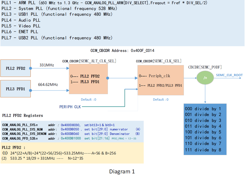

  1. Descriptions for Diagram 1

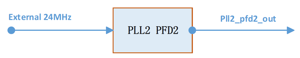

(1) PLL2 PFD2
① Registers related to PLL2 PFD2
---CCM_ANALOG_PLL_SYSn (page 767, in reference manual)
Address: 0x400D_8030h
important bits:
bit[15:14]---- select clock source.
Bit[13] ----- Enable PLL output
Bit[0]------- This field controls the PLL loop divider. 0 - Fout=Fref*20; 1 - Fout=Fref*22.
---CCM_ANALOG_PLL_SYS_NUM(page 768, in reference manual)
Address: 0x400D_8050h
important bits:
bit[29:0]--- 30 bit numerator (A) of fractional loop divider (signed integer)
---CCM_ANALOG_PLL_SYS_DENOM (page 769, in reference manual)
Address: 0x400D_8060h
important bits:
bit[29:0]---- 30 bit Denominator (B) of fractional loop divider (unsigned integer).
---CCM_ANALOG_PFD_528n (page 769, in reference manual)
Address: 0x400D_8100h
important bits:
bit[21:16]----- This field controls the fractional divide value. The resulting frequency shall be 528*18/PFD2_FRAC where PFD2_FRAC is in the range 12-35.
Computational formula
PLL2_PFD2_OUT=(External 24MHz)*(Fout + A/B) * 18/ PFD2_FRAC
③ Example for PLL2_PFD2_OUT computation
CCM_ANALOG_PLL_SYSn[0] = 1  // Fout=Fref*22
CCM_ANALOG_PLL_SYS_NUM[29:0] = 56  // A = 56
CCM_ANALOG_PLL_SYS_DENOM[29:0] = 256  // B=256
CCM_ANALOG_PFD_528n[21:16] = 29                       // PFD2_FRAC=29
PLL2_PFD2_OUT = 24 * (22 + 56/256)*18/29 = 331MHz (330.98MHz)

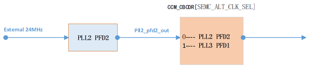

(2) Clock Select Register : CCM_CBCDR
Address: 0x 400F_C014h
important bits: SEMC_ALT_CLK_SEL & SEMC_CLK_SEL & SEMC_PODF
bit[7] --- bit[SEMC_ALT_CLK_SEL]
0---PLL2 PFD2 will be selected as alternative clock for SEMC root clock
1---PLL3 PFD1 will be selected as alternative clock for SEMC root clock

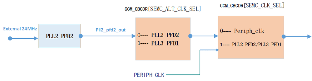

Bit[6] --- bit[SEMC_CLK_SEL]
0----Periph_clk output will be used as SEMC clock root
1----SEMC alternative clock will be used as SEMC clock root
Bit[18:16] --- bit[SEMC_PODF]
Post divider for SEMC clock.
NOTE: Any change of this divider might involve handshake with EMI. See CDHIPR register for the
handshake busy bits.
000 divide by 1
001 divide by 2
010 divide by 3
011 divide by 4
100 divide by 5
101 divide by 6
110 divide by 7
111 divide by 8
  1. Example for configuration of SDRAM Clock
Example : 166MHz SDRAM Clock
---- 0x400D8030 = 0x00002001 // wirte  0x00002001 to CCM_ANALOG_PLL_SYSn
---- 0x400D8050 = 0x00000038 // write 0x00000038 to CCM_ANALOG_PLL_SYS_NUM
---- 0x400D8060 = 0x00000100 // write 0x00000100 to CCM_ANALOG_PLL_SYS_DENOM
---- 0x400D8100 = 0x001d0000 // write 0x001d0000 to CCM_ANALOG_PFD_528n
---- 0x400FC014 = 0x00010D40 // write 0x00010D40 to CCM_CBCDR, divided by 2
