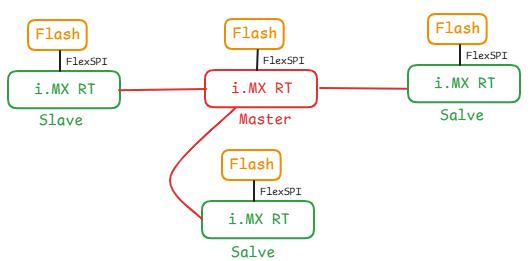

2.2 Shared Flash Architecture (Master-Slave with Flash Sharing)
A single Flash device is connected to multiple i.MXRTs. The master i.MXRT controls the POR_B (Power-On Reset) signal of all slave i.MXRTs, enabling shared access to the same Flash.
Boot Process:
1. The master i.MXRT boots first in Non-XIP mode.
2. The master sequentially releases the POR_B signals of slave i.MXRTs, allowing them to occupy the Flash and boot in Non-XIP mode one at a time.

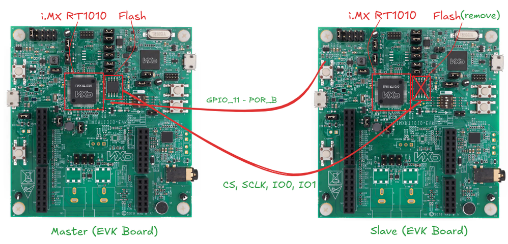

3. Hardware Platform Setup
  • Master Board: MIMXRT1010-EVK
  • Slave Board: MIMXRT1010-EVK
Rework:
  • Remove U13 (Flash) from the slave board.
  • Retain U13 on the master board and fly-wire it to U13 of the slave board (only CS, SCLK, IO0, IO1 are required for low-speed boot).
  • Connect GPIO_11 signal of the master i.MXRT1010 to POR_B of the slave i.MXRT1010 (Pin3/4 of SW3).

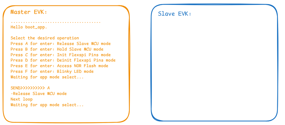

The boot_app is also derived from the SDK's hello_world. It supports receiving simple UART commands (A, B, etc.) for various tests. Currently, six test commands are supported:
Commands Target Device i.MX RT Description
'A' Master Drive master i.MXRT's GPIO_11 high to pull POR_B high and release slave i.MXRT from reset.
'B' Master Drive master i.MXRT's GPIO_11 low to pull POR_B low and hold slave i.MXRT in reset.
Commands Target Device Description
'F' Salve Toggle GPIO_11 periodically with a timer to blink the D25 LED.
'C' Master or Slave  Initialize Flash-related pins for FlexSPI functionality.
'D' Master or Slave  Restore Flash-related pins to default GPIO state.
'E' Master or Slave  Erase, program, and read U13 Flash.

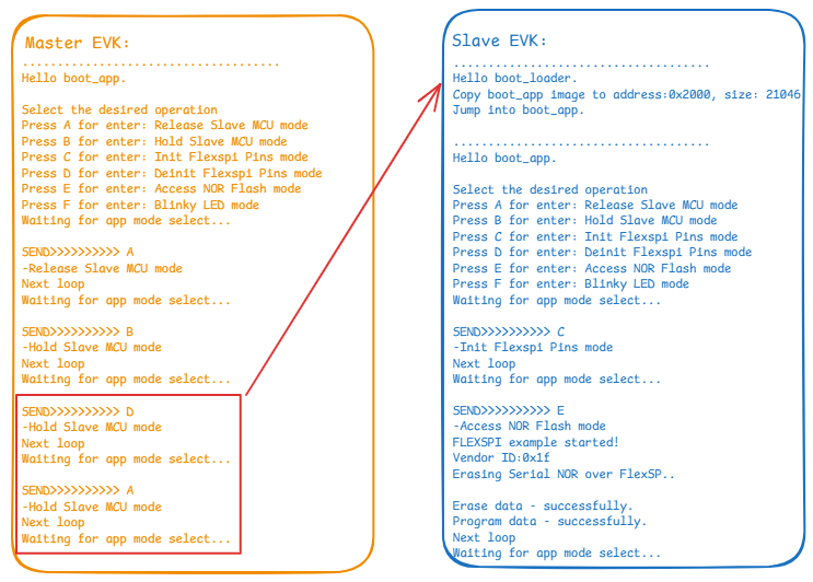

Notes:
  • Commands A and E may cause conflicts when both master and slave i.MXRT attempt to drive the same Flash through FlexSPI pins. Before executing Command A (to release the slave), the master should first execute Command D, calling the following function to restore FlexSPI pins to GPIO mode. Otherwise, the slave may fail to boot normally (BootROM configures these pins as FlexSPI during boot).
void bsp_deinit_flexspi_pins(void) {
    IOMUXC_SetPinMux(IOMUXC_GPIO_SD_06_GPIO2_IO06, 0U);
    IOMUXC_SetPinMux(IOMUXC_GPIO_SD_07_GPIO2_IO07, 0U);
    IOMUXC_SetPinMux(IOMUXC_GPIO_SD_09_GPIO2_IO09, 0U);
    IOMUXC_SetPinMux(IOMUXC_GPIO_SD_10_GPIO2_IO10, 0U);
    IOMUXC_SetPinConfig(IOMUXC_GPIO_SD_06_GPIO2_IO06, 0x10A0U);
    IOMUXC_SetPinConfig(IOMUXC_GPIO_SD_07_GPIO2_IO07, 0x10A0U);
    IOMUXC_SetPinConfig(IOMUXC_GPIO_SD_09_GPIO2_IO09, 0x10A0U);
    IOMUXC_SetPinConfig(IOMUXC_GPIO_SD_10_GPIO2_IO10, 0x10A0U);
  • Commands C and E are typically used together. If the slave has already executed them and remains active, the master must either:
    • The Master execute Command B to reset the slave which resets FlexSPI pin configurations
    • The Slave to execute Command D before running C/E.

  1. Power up both boards.
  2. Download the boot_loader (containing embedded boot_app) to Flash.
Quick Test:
  1. Sending Command A initially may not start the slave properly.
  2. However, after executing Command D followed by Command A, the slave boots successfully.
  3. Both master and slave boards can read/write the shared Flash normally, verifying the feasibility of this innovative shared flash boot method.Sam_Gao_1-1750239829328.png
