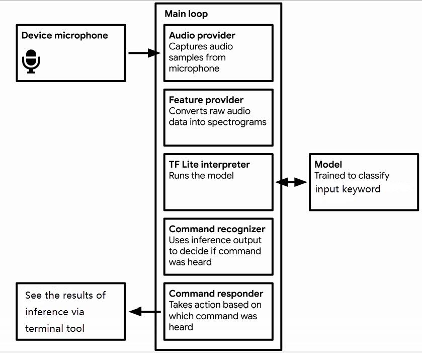

Figure 1 shows the components that comprise it.
Fig 1

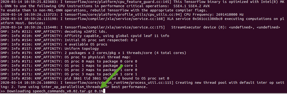

Once the downloading has completed, some more output will appear. There might be some warnings, which you can ignore as long as the command continues running. Later, you'll see logging information that looks like this (Figure 3).
Fig 3

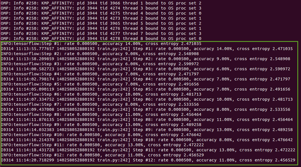

This shows that the initialization process is done and the training loop has begun. You'll see that it outputs information for every training step. Here's a break down of what it means:
  • Step shows that we're on the step of the training loop. In this case, there are going to be 30,000 steps in total, so you can look at the step number to get an idea of how close it is to finishing.
  • rate is the learning rate that's controlling the speed of the network's weight updates. Early on this is a comparatively high number (0.0005), but for later training cycles it will be reduced 5x, to 0.0001, then to 0.00002 at last.
  • accuracy is how many classes were correctly predicted on this training step. This value will often fluctuate a lot, but should increase on average as training progresses. The model outputs an array of numbers, one for each label, and each number is the predicted likelihood of the input being that class. The predicted label is picked by choosing the entry with the highest score. The scores are always between zero and one, with higher values representing more confidence in the result.
  • cross-entropy is the result of the loss function that we're using to guide the training process. This is a score that's obtained by comparing the vector of scores from the current training run to the correct labels, and this should trend downwards during training.

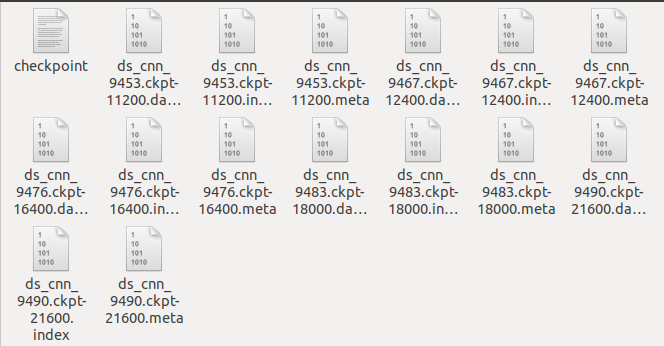

  • checkpoint
    After a hundred steps, you should see a line like this:
    This is saving out the current trained weights to a checkpoint file (Figure 4). If your training script gets interrupted, you can look for the last saved checkpoint and then restart the script with --start_checkpoint=/tmp/speech_commands_train/best/ds_cnn_xxxx.ckpt-400 as a command line argument to start from that point .
Fig 4

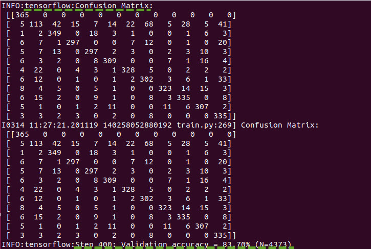

  • Confusion Matrix
    After four hundred steps, this information will be logged:
    The first section is a confusion matrix. To understand what it means, you first need to know the labels being used, which in this case are "silence", "unknown", "zero", "one", "two", "three", "four", "five", "six", "seven", "eight", and "nine". Each column represents a set of samples that were predicted to be each label, so the first column represents all the clips that were predicted to be silence, the second all those that were predicted to be unknown words, the third "zero", and so on.
    Each row represents clips by their correct, ground truth labels. The first row is all the clips that were silence, the second clips that were unknown words, the third "zero", etc.
    This matrix can be more useful than just a single accuracy score because it gives a good summary of what mistakes the network is making. In this example you can see that all of the entries in the first row are zero (Figure 5), apart from the initial one. Because the first row is all the clips that are actually silence, this means that none of them were mistakenly labeled as words, so we have no false negatives for silence. This shows the network is already getting pretty good at distinguishing silence from words.
    If we look down the first column though, we see a lot of non-zero values. The column represents all the clips that were predicted to be silence, so positive numbers outside of the first cell are errors. This means that some clips of real spoken words are actually being predicted to be silence, so we do have quite a few false positives.
    A perfect model would produce a confusion matrix where all of the entries were zero apart from a diagonal line through the center. Spotting deviations from that pattern can help you figure out how the model is most easily confused, and once you've identified the problems you can address them by adding more data or cleaning up categories.
                                                           Fig 5

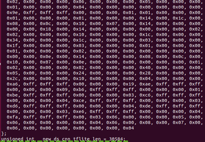

Create a C array
We’ll use the xxd command to convert a TensorFlow Lite model into a C array in the following.
xxd -i ./ds_cnn.tflite > ./ds_cnn.h
cat ./ds_cnn.h‍‍‍‍‍‍‍‍
The final part of the output is the file’s contents, which are a C array and an integer holding its length, as follows:
Fig 7
Next, we’ll integrate this newly trained model with the tensorflow_lite_kws project.

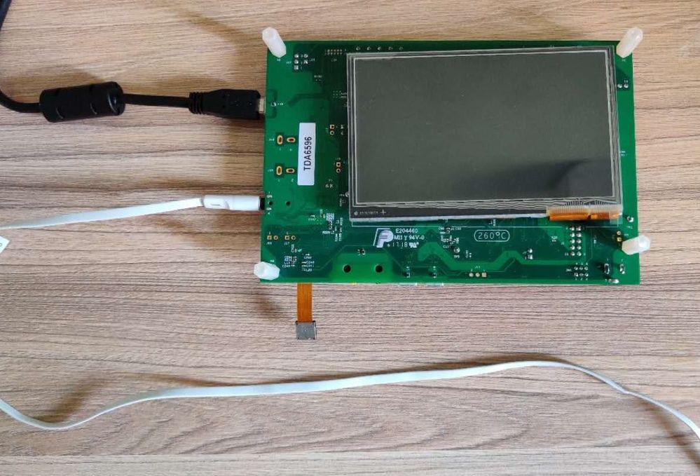

Before running the model in the EVKB-IMXRT1050 board (Figure 8), please refer to the readme.txt to do the preparation, in further, the file also demonstrates the steps of testing, please follow them.
Fig 8

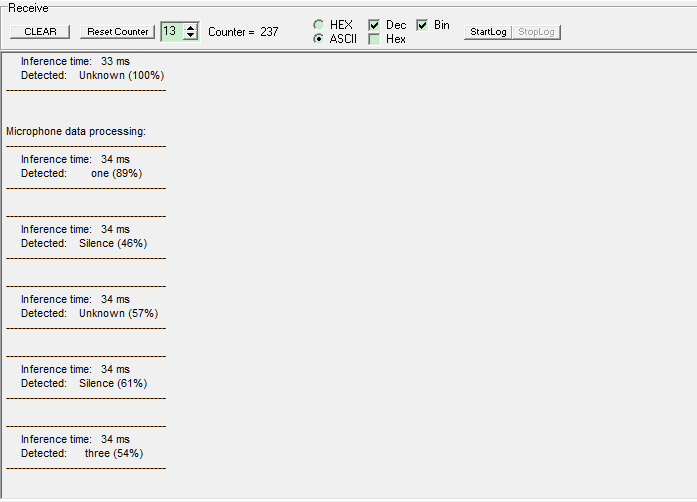

Figure 9 shows the testing I did, I've attached the model file, please give a try by yourself.
Fig 9
