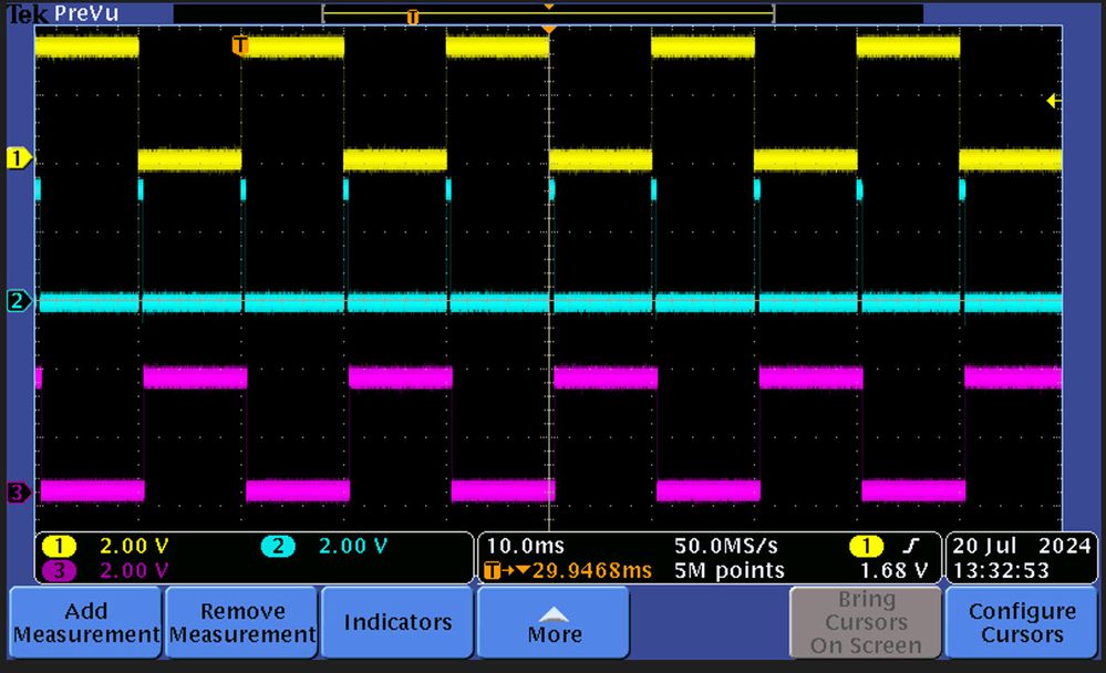

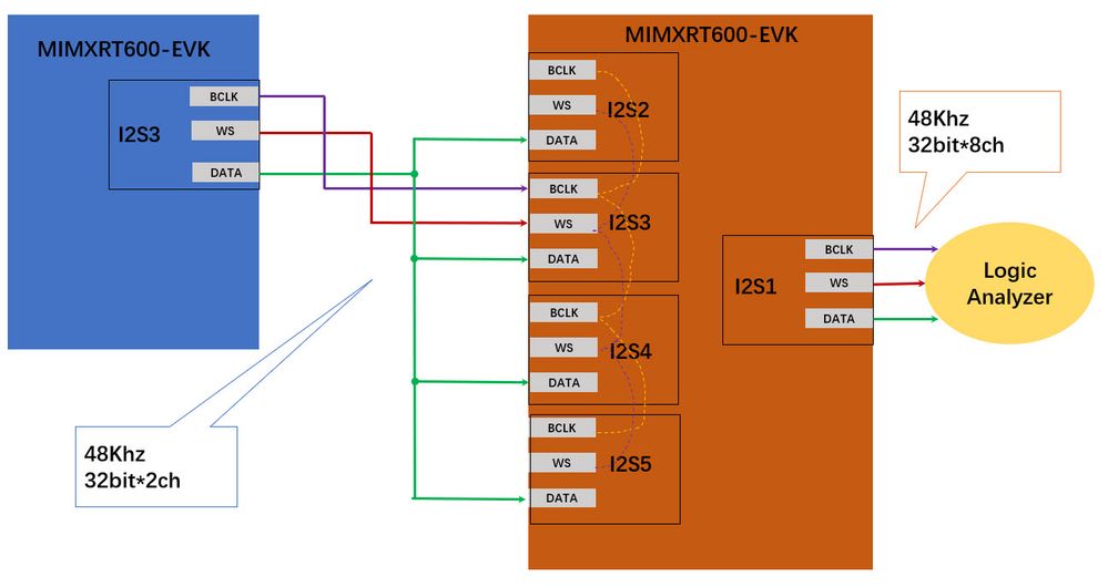

The following is the block diagram of this application platform:
Figure 1 System Block Diagram

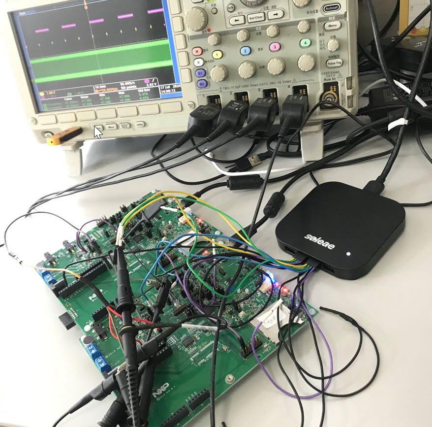

In the above figure, a MIMXRT685-EVK implements the function of outputting 48Khz, 32bit*2ch, and sends data in a loop: 0X00, 0X01….0XFF.
Another MIMXRT685-EVK is the focus of this article, which implements 4 groups of I2S to receive data at a sampling rate of 48khz and 32bit*2ch, and then assembles the received data into audio data with a sampling rate of 48Khz and 32bit*8ch and sends it out.
In the above figure, in order to reduce the connection of external lines, for BCLK and WS signals, only one group is directly connected to I2S3, and the other I2S2, I2S4, and I2S5 share the I2S3 signal internally. Then, for DATA data, a line is made externally with 4 heads, and connected to the data pins of each group of audio interfaces respectively.
The following is a detailed description of this solution.

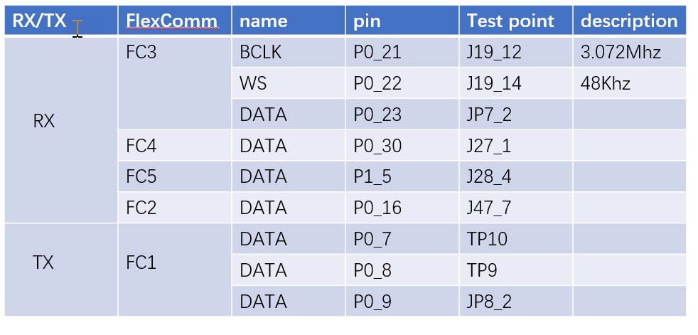

The pinouts of the two boards are given below. Because the platform uses many pins, specific allocation is required.
2.1 Audio source board
A MIMXRT685-EVK is used as an audio source, and the pinouts for sending 48Khz 32bit*2ch are as follows:
Figure 2 Pinout of audio source board
2.2 Audio transceiver board
Another MIMXRT685-EVK is used as an audio transceiver board to receive 4-channel audio synchronization data sent by the audio source and assemble it into a 48Khz 32bit*8ch waveform for transmission.
Figure 3 Pin assignment of audio transceiver board

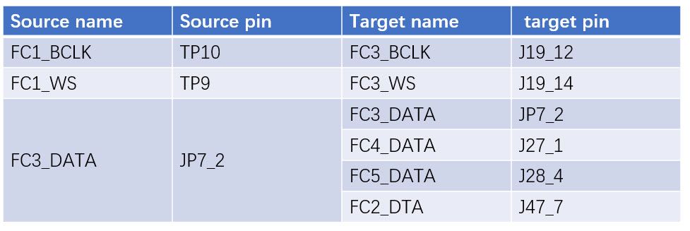

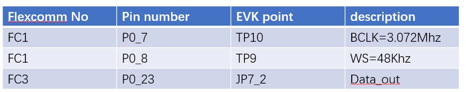

2.3 Dual-board hardware connection
The source and target connections of the two boards are as follows:
Figure 4 Two board pin connection
Figure 5 two board connection
After the hardware is ready, the software solution and code are provided.

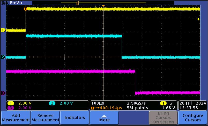

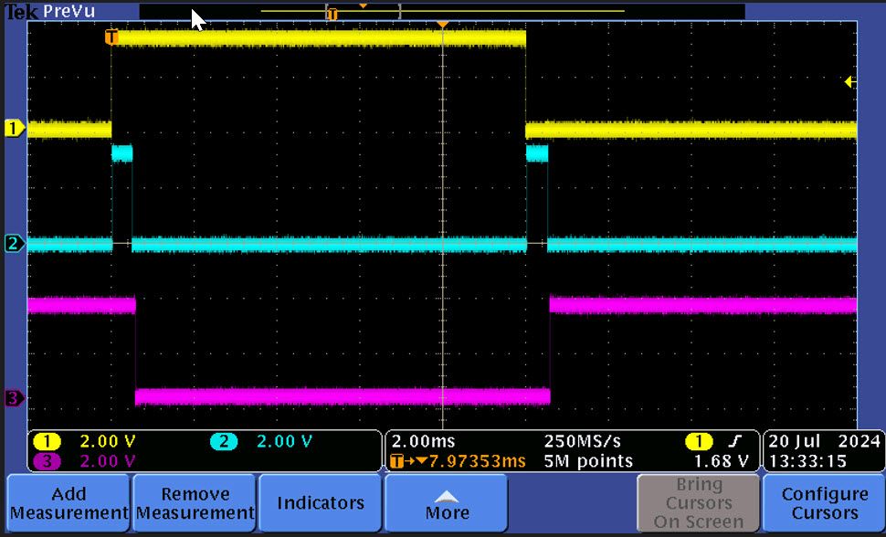

Several solutions have been described above. Finally, we choose to use 4 audio channels to receive audio data and cache 10ms audio data buffer. The conversion from receiving buffer to sending buffer adopts memcpy method, and test whether this copy time can meet the actual needs, to ensure that the buffer pool of receiving buffer is greater than this copy time, which is enough to prepare the sending buffer.
The solution for receiving data transfer is as follows:
Figure 6 Data buffer transfer
The above is 4 groups of I2S receiving their own 10ms data respectively. The buffer is actually prepared for 20ms. A single DMA receives a frame for 10ms, and the other 10ms is used for pingpong buffer. The sending buffer is used to copy the received 4 groups of I2S buffers into a 32bit*8ch array in TDM format, and then two groups of ping-pong buffers are also made.
In fact, it is to cache 10ms data. The buffer prepares two groups of 10ms. When the first 10ms frame is received, the second buffer is used to receive it. At the same time, the data of the first buffer is copied to the first buffer of the sending buffer, and the first buffer is used for sending. After the sending is completed, it is transferred to the second buffer to receive and send.
In this way, as long as the time is controlled well, there will be no data error problem.
The data volume of 10ms is 3840Byte, because the receiving frequency is 48Khz, that is, there are 48000 frames in 1s, and each frame is 32bit*2=8Byte, then 10ms=>4800*8Byte=38400Byte.

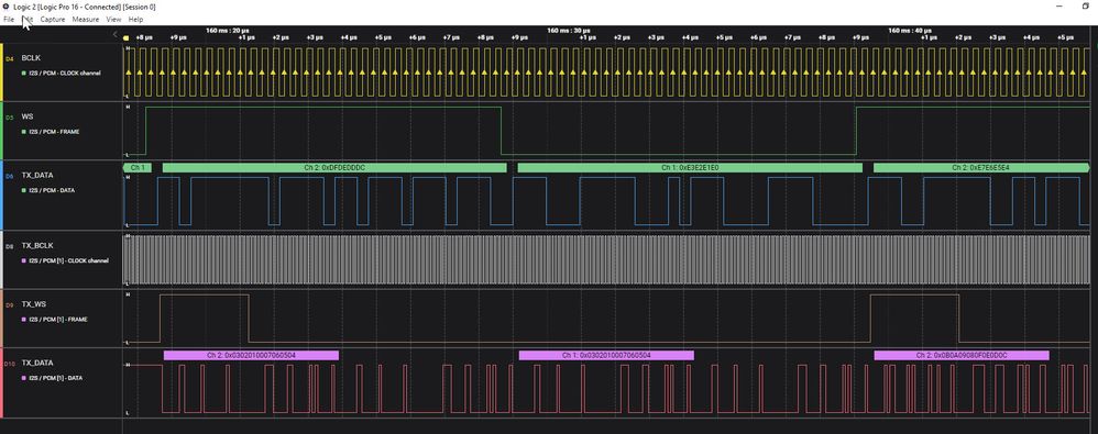

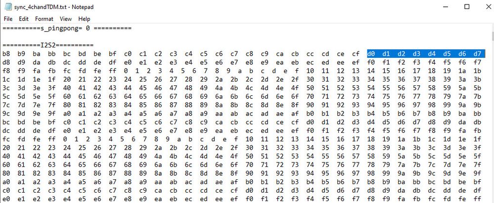

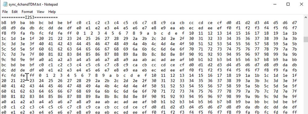

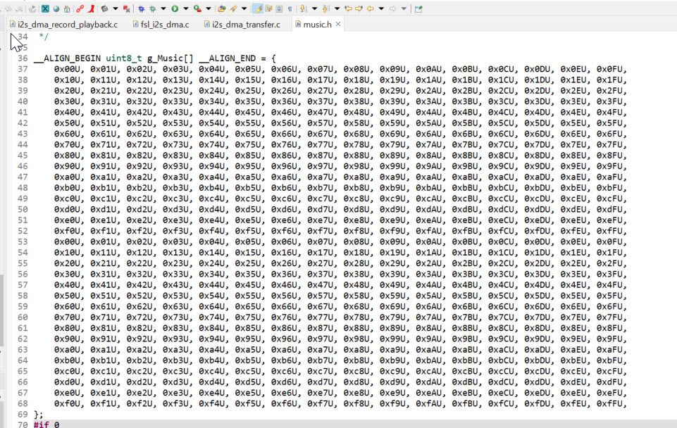

3.2.3 Audio data received and transferred
Because when receiving, each audio interface takes turns to receive its own 2ch data, but when sending, it is necessary to send 4-channel received audio dual-channel data, that is, 32bit*8ch data, so after receiving ping, the ping data needs to be transferred to the sending ping buffer. The code for transfer is as follows:
#define I2S_BUFFER_SIZE 3840 //10ms
SDK_ALIGN(static uint8_t I2S2_s_Buffer[2][I2S_BUFFER_SIZE],   sizeof(uint32_t));
SDK_ALIGN(static uint8_t I2S3_s_Buffer[2][I2S_BUFFER_SIZE],   sizeof(uint32_t));
SDK_ALIGN(static uint8_t I2S4_s_Buffer[2][I2S_BUFFER_SIZE],   sizeof(uint32_t));
SDK_ALIGN(static uint8_t I2S5_s_Buffer[2][I2S_BUFFER_SIZE],   sizeof(uint32_t));
SDK_ALIGN(static uint8_t I2S1_s_Buffer[2][I2S_BUFFER_SIZE*4], sizeof(uint32_t));
if( s_pingpong ==  1)
             for(ch = 0;ch < 480; ch++) //480=I2S_BUFFER_SIZE(3840)/8
                 memcpy(&I2S1_s_Buffer[0][0  + (32*ch)], &I2S2_s_Buffer[0][8*ch], 8);
                 memcpy(&I2S1_s_Buffer[0][8  + (32*ch)], &I2S3_s_Buffer[0][8*ch], 8);
                 memcpy(&I2S1_s_Buffer[0][16 + (32*ch)], &I2S4_s_Buffer[0][8*ch], 8);
                 memcpy(&I2S1_s_Buffer[0][24 + (32*ch)], &I2S5_s_Buffer[0][8*ch], 8);
         else
                 memcpy(&I2S1_s_Buffer[1][0  + (32*ch)], &I2S2_s_Buffer[1][8*ch], 8);
                 memcpy(&I2S1_s_Buffer[1][8  + (32*ch)], &I2S3_s_Buffer[1][8*ch], 8);
                 memcpy(&I2S1_s_Buffer[1][16 + (32*ch)], &I2S4_s_Buffer[1][8*ch], 8);
                 memcpy(&I2S1_s_Buffer[1][24 + (32*ch)], &I2S5_s_Buffer[1][8*ch], 8);

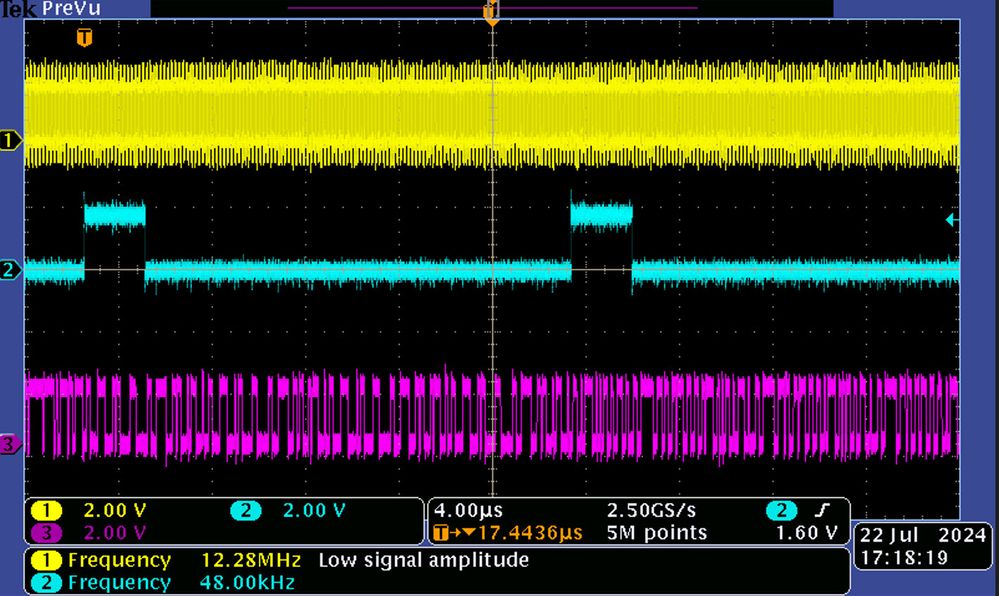

3.2.4 Send TDM audio code
The sending code also uses the I2S DMA method, but because there is no need to send multiple channels at the same time, only a single channel, there is no need to consider the synchronization problem, and no DMA descriptor is used. After the sending buffer is ready, the I2S_TxTransferSendDMA method is used. The code is as follows:
I2S_TxGetDefaultConfig(&I2S1_s_TxConfig);
    I2S1_s_TxConfig.divider     = DEMO_I2S1_CLOCK_DIVIDER;
    I2S1_s_TxConfig.masterSlave = kI2S_MasterSlaveNormalMaster;
    I2S1_s_TxConfig.wsPol       = true;
    I2S1_s_TxConfig.mode        = kI2S_ModeDspWsLong;//kI2S_ModeDspWsShort;
    I2S1_s_TxConfig.dataLength  = 32U;
    I2S1_s_TxConfig.frameLength = 32 * 8U;
    I2S1_s_TxConfig.position    = DEMO_TDM_DATA_START_POSITION;
    I2S1_s_TxConfig.pack48      = true;
	I2S_TxInit(DEMO_I2S1_TX, &I2S1_s_TxConfig);
	I2S_EnableSecondaryChannel(DEMO_I2S1_TX, kI2S_SecondaryChannel1, false, 64 + DEMO_TDM_DATA_START_POSITION);
	I2S_EnableSecondaryChannel(DEMO_I2S1_TX, kI2S_SecondaryChannel2, false, 128 + DEMO_TDM_DATA_START_POSITION);
	I2S_EnableSecondaryChannel(DEMO_I2S1_TX, kI2S_SecondaryChannel3, false, 192 + DEMO_TDM_DATA_START_POSITION);

Audio data buffer:
Figure 7 Audio source sends buffer
The corresponding test results are given:
Figure 8 Audio source sending data test
It can be seen that the data sent by the audio source is cyclical and can be sent in an increasing loop.

4.1 4 I2S audio 10ms data pool
This verification is very simple. Define a pin GPIO, initialize the output to 0, and then reverse it in the received callback interrupt. This article chooses to reverse it in the I2S5 callback. The test results are as follows:
Figure 9 ch1 10ms duration
Channel 1 is the exact 10ms because of the callback reversal received.
Here is a general picture of the test:
Figure 10 Time test overview
Ch1: I2S5 callback entry frequency
Ch2: memory copy time
Ch3: Send callback entry frequency
It can be seen that the frequency of sending and receiving is 10ms, because the sending frequency is also 48Khz, but because it is 8ch, the data volume is 4 times that of receiving, and all the data of the 4 receiving channels need to be stuffed in.
4.2 Time consumption of receiving and copying to sending buffer
For data copying, that is, assembling the data received from 4 I2S channels into 4 buffers into the sending buffer, this time test is on the second channel of the oscilloscope, and the results are as follows:
Figure 11 copy data time
It can be seen that the copying time is less than 500us, which is much shorter than the 10ms of the audio receiving data pool. Therefore, you can use memcpy casually without worrying about the copying time being too long. This also makes up for the regret that I wanted to use DMA for memory to memory copying before, but it could not be realized due to DMA performance issues.
4.3 Verification of the synchronization of the data received on the 4 I2S
In order to verify the synchronization, this article closes the 4 I2S receiving channel after receiving 100times 10ms, and prints out the corresponding 4 I2S audio receiving buffer. The results of the 4 I2S buffer are as follows:
Figure12 I2S2 receive buffer
Figure 13 I2S3 receive buffer
Figure 14 I2S4 receive buffer
Figure 15 I2S5 receive buffer
It can be seen that the receive buffer data of the 4 I2S are completely synchronized, and all start from 0XB8.
4.4 Send buffer corresponding to 4-channel audio TDM
The send buffer is printed after 100 receptions, and then memcpy is performed to the send buffer, and the printout of the send buffer data is as follows:
Figure 16 I2S1 transfer buffer
It can be seen that the buffer also starts from 0XB8, and the 4 groups of received data are copied to the send buffer and assembled into 32bit*8ch data. It can be seen that the TDM send buffer is also correct.
4.5 Sending 48Khz 32bit 8ch audio data waveform
Figure 17 Transmitting and receiving audio waveforms
The upper group is the waveform of the audio source, and the lower group is the waveform of TDM transmission.
Due to the limitation of the analysis software of the logic analyzer, it can only analyze 2ch 64bit data at most, so only part of the data can be seen here, but from the waveform, it can be seen that the waveform of sending TDM can achieve 32bit*8ch, and every 8byte data in a frame is the same, which also explains the synchronization of 4-channel audio reception.
In the above figure, the data of ch2 is actually 00, 01, 02, 03, 04, 05, 06, 07, 4 groups of the same data in one frame, and the waveform can also be seen that there are 4 groups of the same data, and 4 groups of 2ch are enough to form 32bit 8ch TDM.
Finally, here is another TDM waveform tested on the oscilloscope:
Figure 18 Sending TDM waveform
It can be seen that BCLK=12.28Mhz is consistent with the expected 48khz*32bit*8=12.288Mhz.
The WS signal is also measured to be 48Khz, which meets the set 48Khz sampling rate.
DATA is also transmitting with data changes, and it can be seen that the waveform pattern within a frame is repeated by about 4 groups, which also shows that the 4 groups of received data are synchronized.
