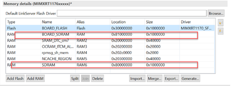

    1. Add two memory space definitions, BOARD_SDRAM and SDRAM. BOARD_SDRAM section is used for M7 to store the data, while SDRAM section is used for M4's code. It should be noted that the location of BOARD_SDRAM should be next to BOARD_FLASH where is the default data section of the project. Kan_Li_3-1733206037604.png

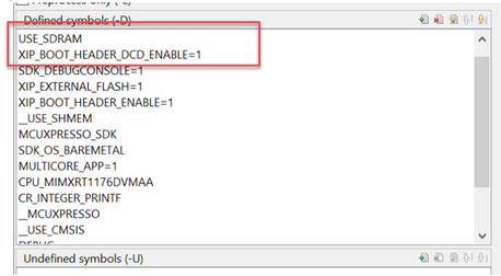

    2. Add macro definition to enable SDRAM initialization code Kan_Li_4-1733206070263.png

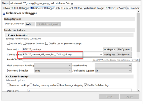

    5. Replace the startup script in the debugger configuration with the version with SDRAM initialization support.  Kan_Li_7-1733206208506.png

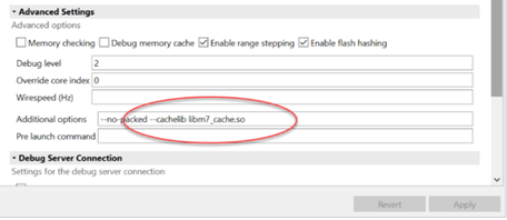

    6. And add the following debug option:
      --cachelib libm7_cache.so

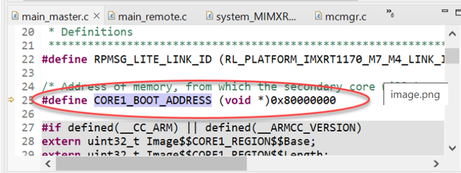

    7. Finally, update the M4 core startup address in the M7 code to the starting address of the SDRAM section defined previously: Kan_Li_9-1733206267899.png

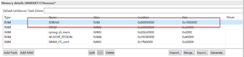

    1. Add SDRAM memory space definition. The starting address and size should be consistent with the SDRAM space definition in the M7 project.  Kan_Li_10-1733206454697.png

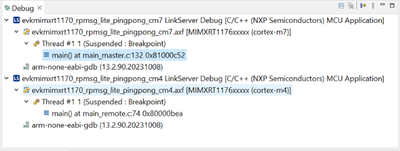

  3. With the above steps, you can debug the code of M7 and M4 in SDRAM at the same time!  Kan_Li_11-1733206476981.pngKan_Li_12-1733206499843.png
