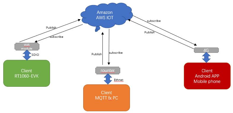

   With the quick development of science and technology, the Internet of Things(IoT) is widely used in various areas, such as industry, agriculture, environment, transportation, logistics, security, and other infrastructure. IoT usage makes our lives more colorful and intelligent. The explosive development of the IoT cannot be separated from the cloud platform. At present, there are many types of cloud services on the market, such as Amazon's AWS, Microsoft's Azure, google cloud, China's Alibaba Cloud, Baidu Cloud, OneNet, etc.
   Amazon AWS Cloud is a professional cloud computing service that is provided by Amazon. It provides a complete set of infrastructure and cloud solutions for customers in various countries and regions around the world. It is currently a cloud computing with a large number of users. AWS IoT is a managed cloud platform that allows connected devices to easily and securely interact with cloud applications and other devices.
   NXP crossover MCU RT product has launched a series of AWS sample codes. This article mainly explains the remote_control_wifi_nxp code in the official MIMXRT1060-EVK SDK as an example to realize the data interaction with AWS IoT cloud, Android mobile APP, and MQTTfx client. The cloud topology of this article is as follows:

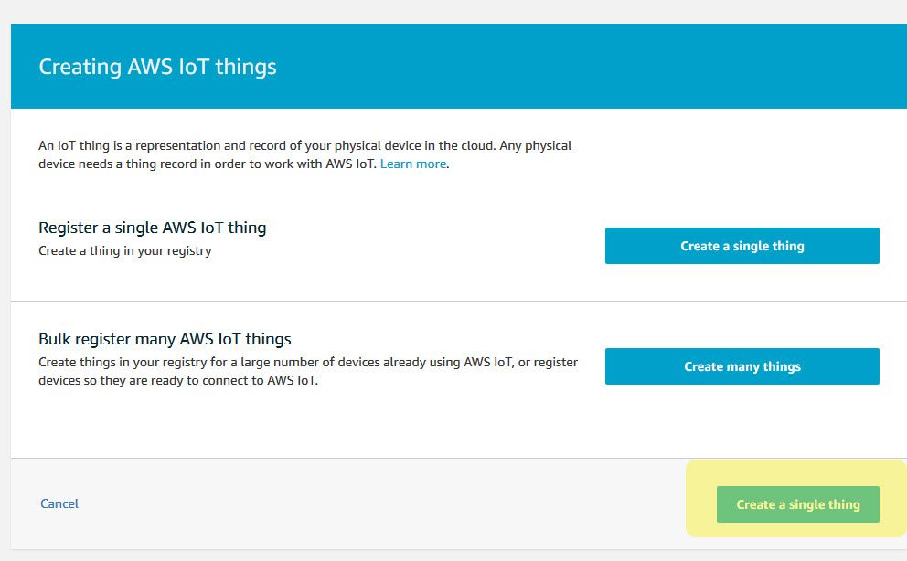

2.2 Create a Thing

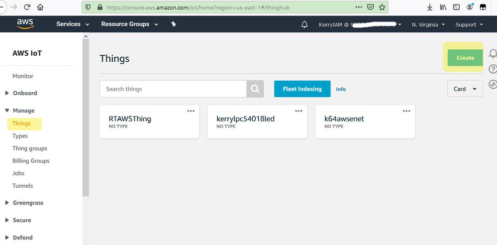

   Open the AWS IOT link:
https://console.aws.amazon.com/iot
   Choose the Things item under manage, if it is the first time usage, customer can choose “register a thing” to create the thing. If it is used in the previous time, customers can click the “create” button in the right corner to create the thing. Choose “create a single thing” to create the new thing, more details check the following picture.
Fig. 2-1
Fig.2-2
Fig.2-3

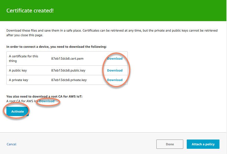

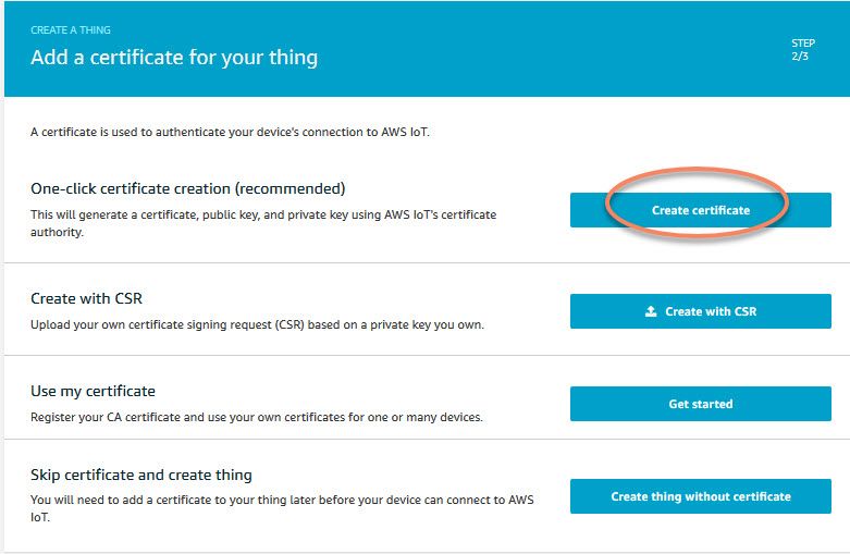

   Create a certificate for the newly created thing, click the “create certificate” button under the following picture:
Fig.2-4
   After the certificate is built, it will have the information about the certificate created, it means the certificate is generated and can be used.
Fig. 2-5

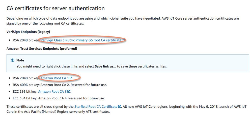

Please note, download files: certificate for this thing, public key, private key.
It will be used in the mqttfx tool configuration. Click “A root CA for AWS for Download”, download the root CA for AWS IoT, the mqttfx tool setting will also use it.
Open the root CA download link, can download the CA certificate.
RSA 2048 bit key: VeriSign Class 3 Public Primary G5 root CA certificate
Fig. 2-6
At last, we can get these files:
7abfd7a350-certificate.pem.crt
7abfd7a350-private.pem.key
7abfd7a350-public.pem.key
AmazonRootCA1.pem
Save it, it will be used later.
Click “active” button to active the certificate, and click “Done” button. The policy will be attached later.

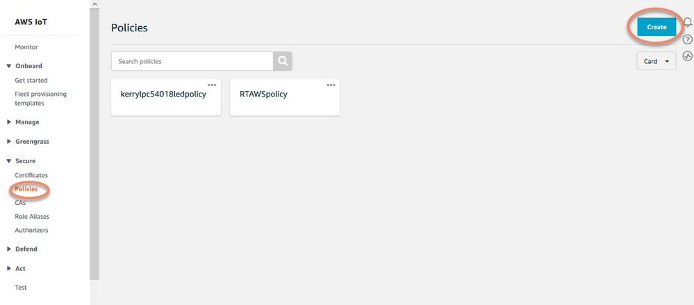

2.4 Create Policies
    Back to the iot view page:
https://console.aws.amazon.com/iot/
    Select the policies under Secure item, to create the new policies.
Fig. 2-7

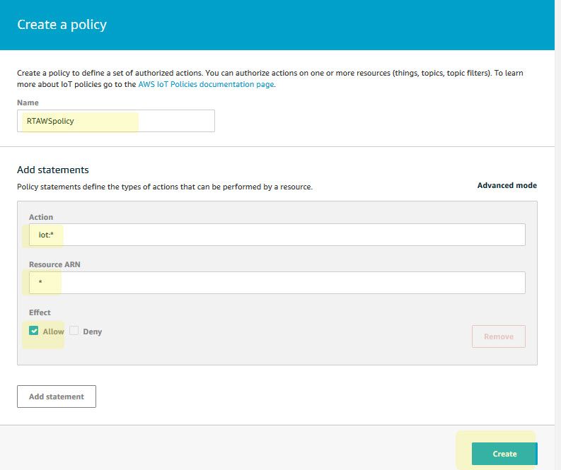

Input the policy name, in the action area, fill: iot:*, Resource ARN area fill: *
Check Allow item, click the create button to finish the new policy creation.
Fig. 2-8

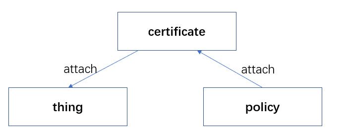

2.5 Things attach relationship
    After the thing, certificate, policies creation, then will attach the policy to the certificate, and attach the certificate to the Things.
Fig. 2-9

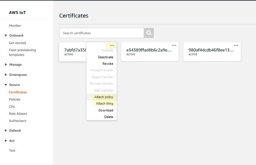

Choose the certificates under Secure item, in the related certificate item, choose “…”, you will find the down list, click “attach policy”, and choose the newly created policy. Then click attach thing, choose the newly created thing.
Fig. 2-10
Fig. 2-11
Fig. 2-12

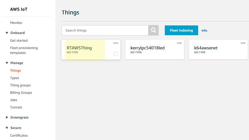

Now, open the Things under Mange item, check the detail things related information.
Fig.2-13
Double click the thing, in the Interact item, we can find the Rest API Endpoint, the RT code and the mqttfx tool will use this endpoint to realize the cloud connection.

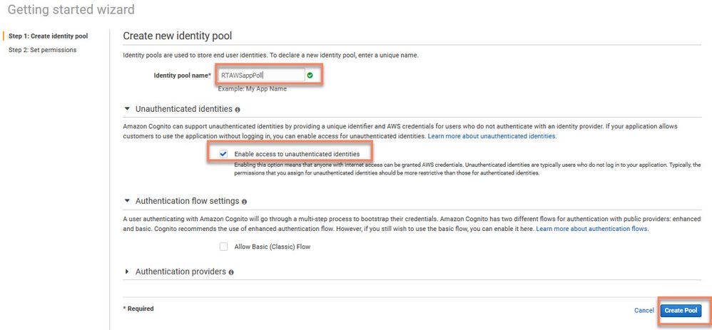

Click “manage Identity pools”, after enter it, then click “create new identity pool”
Fig. 3-2
Fig. 3-3
Fig. 3-4
Here, it will generate two Roles
Cognito_PoolNameAuth_Role
Cognito_PoolNameUnauth_Role
Click Allow, to finish the identity pool creation.

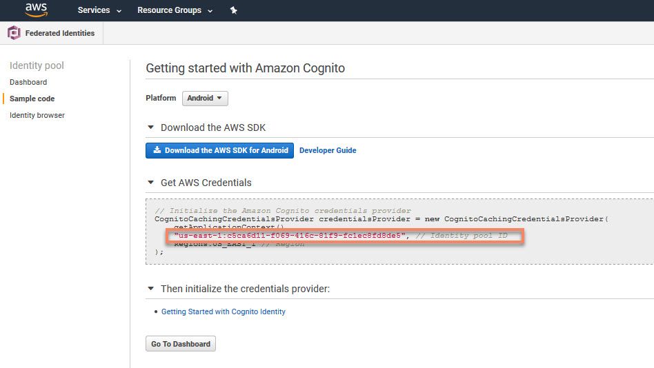

Please record the related Identity pool ID, it will be used in the Android app .properties configuration files.

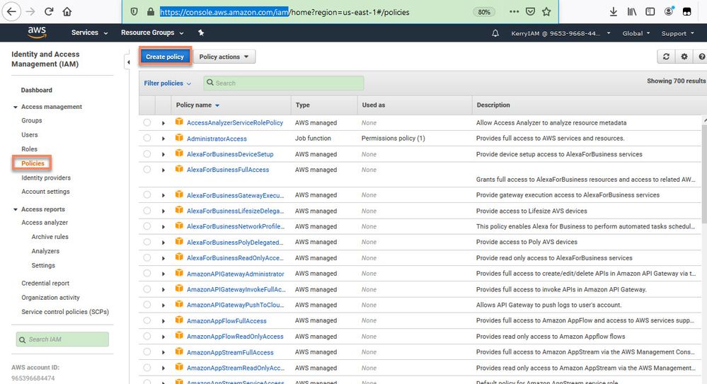

  Click the “policies” item under “access management”
Fig. 3-6

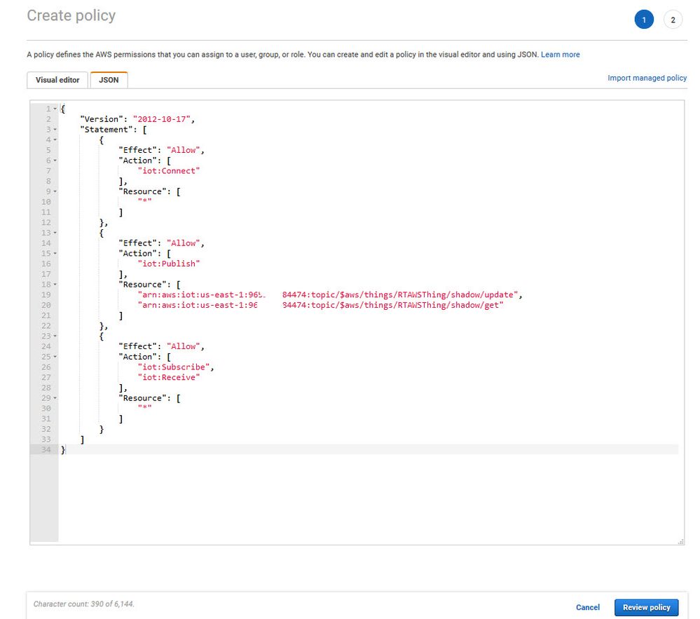

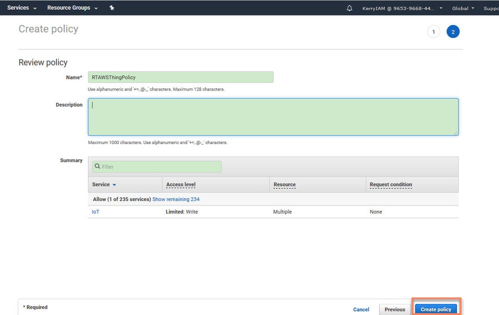

Choose “create policy”, create a IAM policies, in the Policy JSON area, write the following content:
Fig. 3-7
 "Version": "2012-10-17",
 "Statement": [
 "Effect": "Allow",
 "Action": [
 "iot:Connect"
 "Resource": [
 "Effect": "Allow",
 "Action": [
 "iot:Publish"
 "Resource": [
 "arn:aws:iot:us-east-1:965396684474:topic/$aws/things/RTAWSThing/shadow/update",
 "arn:aws:iot:us-east-1:965396684474:topic/$aws/things/RTAWSThing/shadow/get"
 "Effect": "Allow",
 "Action": [
 "iot:Subscribe",
 "iot:Receive"
 "Resource": [
Please note, in the JSON content:
"arn:aws:iot:<REGION>:<ACCOUNT ID>:topic/$aws/things/<THING NAME>/shadow/update",
"arn:aws:iot:<REGION>:<ACCOUNT ID>:topic/$aws/things/<THING NAME>/shadow/get"

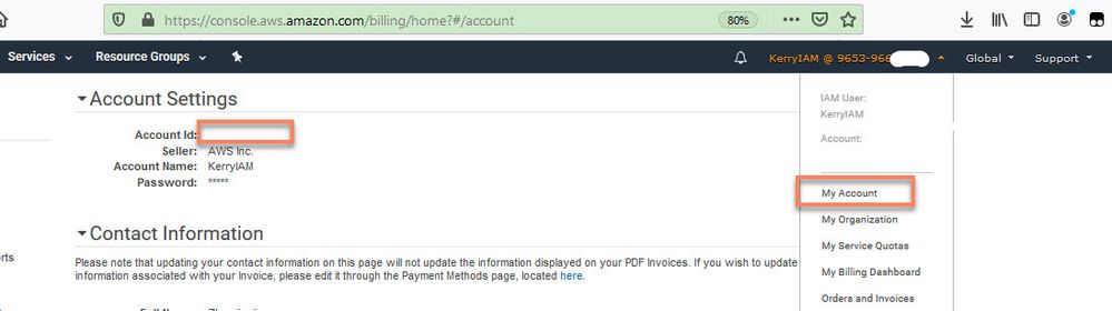

Regionthe us-east-1 inFig. 3-5
ACCOUNT ID, it can be found in the upper right corner my account side.
Fig 3-8
Fig 3-9

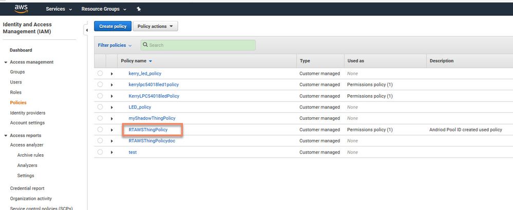

After finished the IAM policy creation, then back to IAM policies page, choose Filter policies as customer managed, we can find the new created customer’s policy.
Fig. 3-10

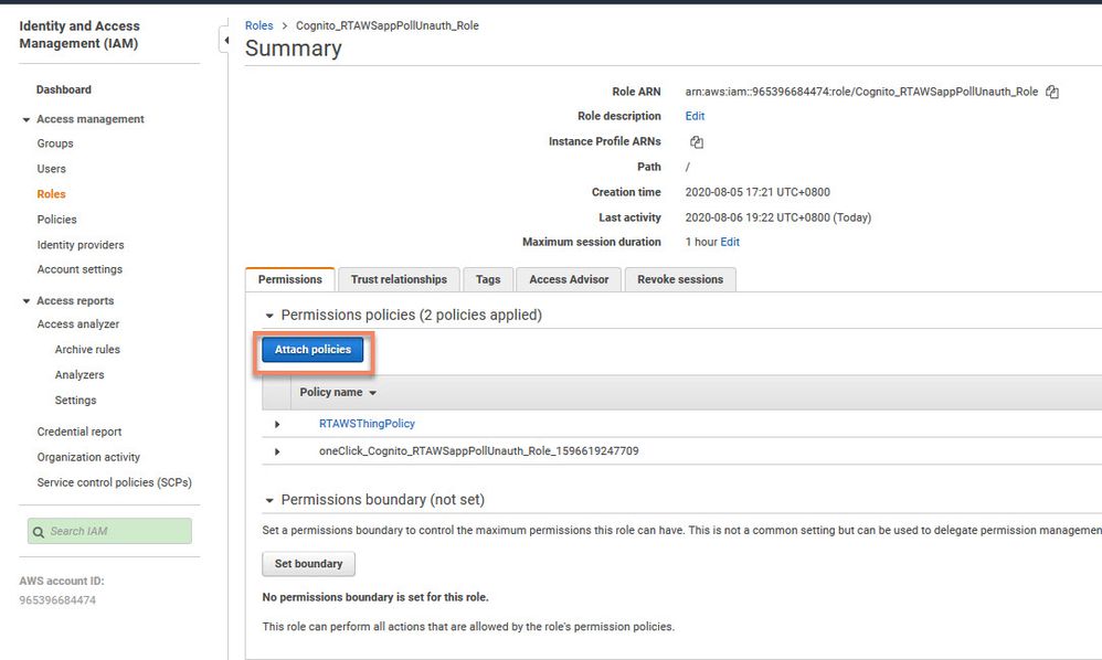

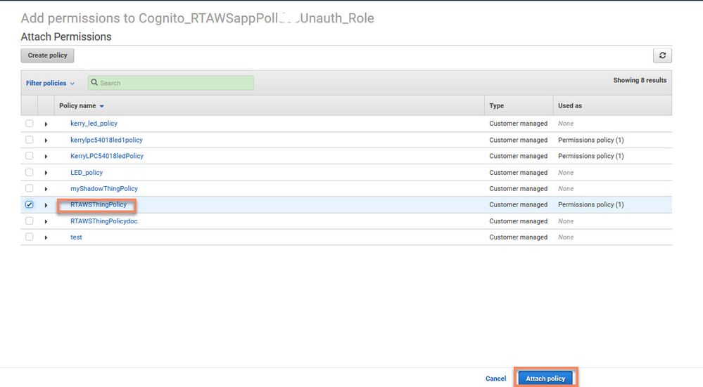

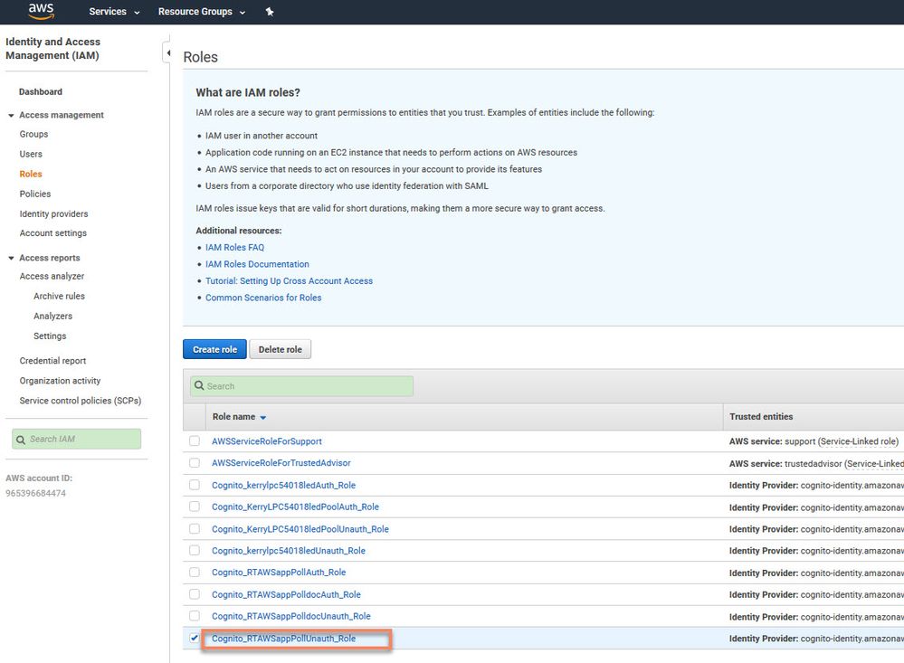

3.3 Attach policy for the cognito role in IAM
  In IAM, choose roles item:
Fig. 3-11
Double click the cognito_PoolNameUnauth_Role which is generated when creating the pool in cognito, click attach policies, select the new created policy.
Fig. 3-12
Fig. 3-13

REST API ENDPOINTFig 2-14
COGNITO POOL IDfig 3-5
THING NAMEfig 2-14upper left corner
REGIONFig 3-5, the region data in COGNITO POOL ID

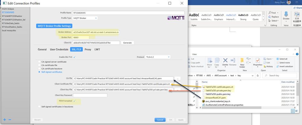

4.1 MQTT.fx configuration
    Choose connect configuration button, then enter the connection configuration page:
Fig. 4-1
Profile Name: Enter the configuration name
Broker Address: it is REST API ENDPOINT
Broker Port:8883
Client ID: generate it freely
CA file: it is the downloaded CA certificate file
Client Certificate File: related certificate file
Client key File: private key file
Check PEM formatted
Click apply and OK to finish the configuration.

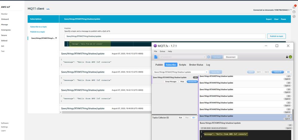

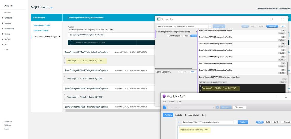

4.2 Use the AWS cloud to test connection
  In order to test whether it can be connected to the event cloud, a preliminary connection test can be performed.
Open the aws page https://console.aws.amazon.com/iot
here is a Test button under this interface, which can be tested by other clients or by itself.Both AWS cloud and MQTTfx subscribe topic: $aws/things/RTAWSThing/shadow/update

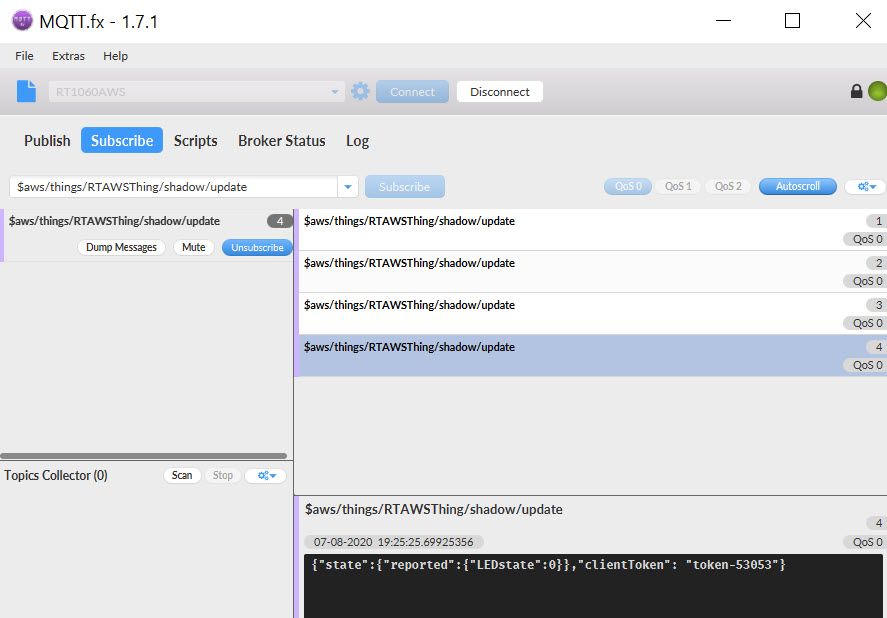

MQTTfx publishes data to the topic: $aws/things/RTAWSThing/shadow/update
It can be found that both the cloud test port and the MQTTfx subscribe can receive data:
Fig. 4-2
Below, the Publish data is tested by the cloud, and then you can see that both the MQTTFX subscribe and the cloud subscribe can receive data:
Fig. 4-3
Until now, the AWS cloud can transfer the data between the AWS iot cloud and the client.

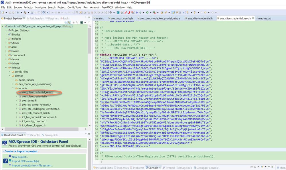

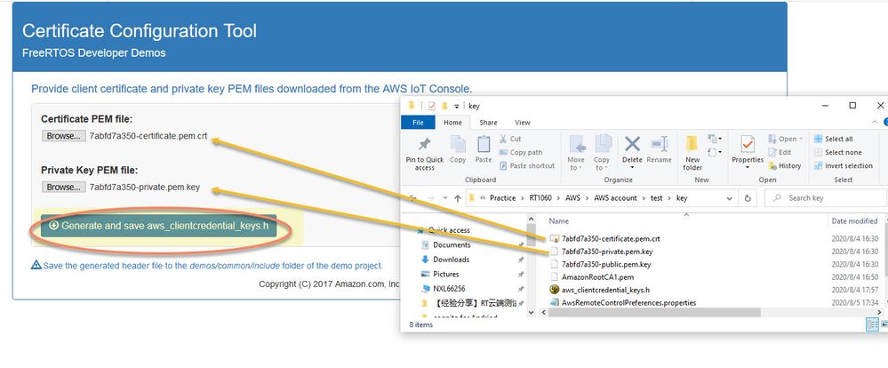

5.2 certificate and the key configuration
Open the SDK following link:
SDK_2.8.0_EVK-MIMXRT1060\rtos\freertos\tools\certificate_configuration\CertificateConfigurator.html
Fig. 5-1
Generate the new aws_clientcredential_keys.h, and replace the old one. Take the MCUXPresso IDE project as an example, the file location is:
Fig. 5-2

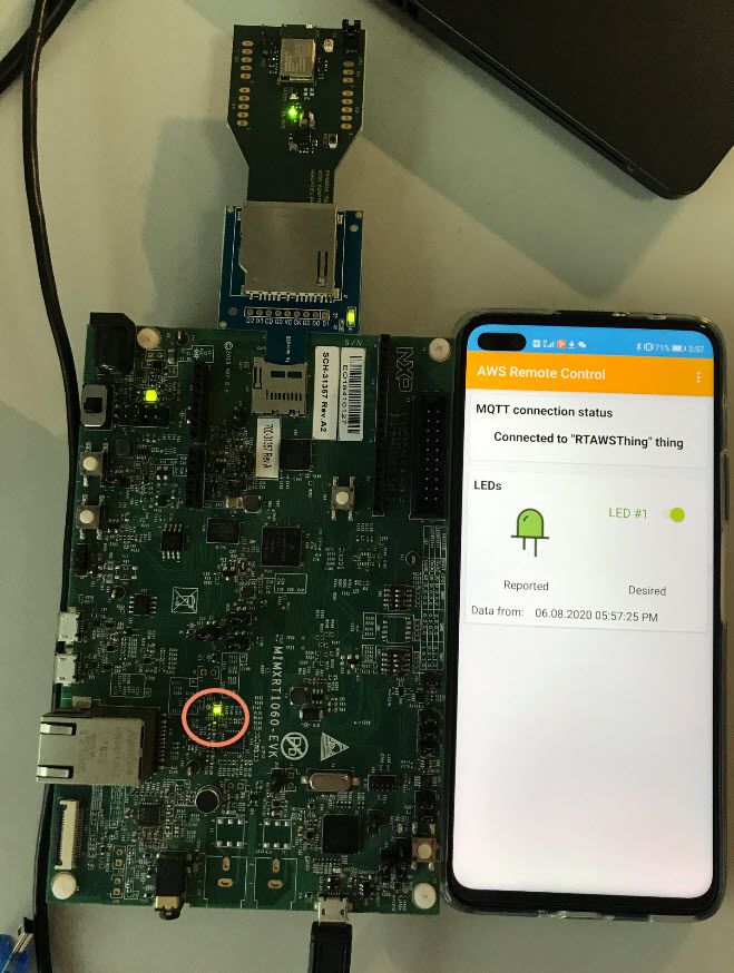

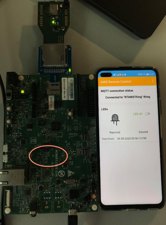

Then, we can use the Android app to remote control the RT EVK on board LED, the test result is
6.1 APP and EVK test result
MIMXRT1060-EVK printf information
Fig. 6-1
Turn on and turn off the led:
Fig. 6-2
                                 Fig. 6-3

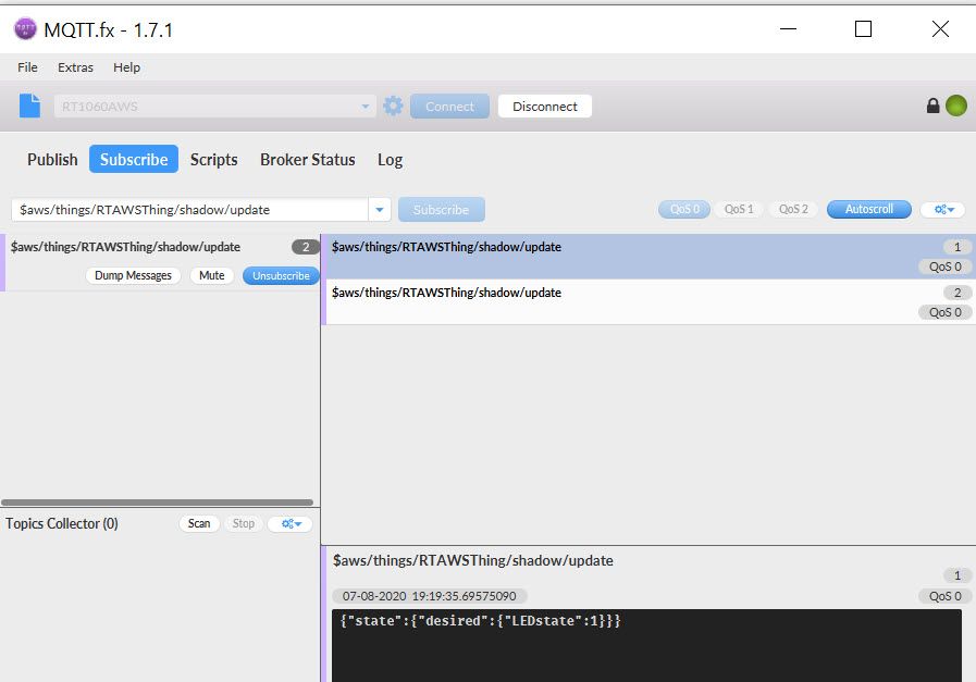

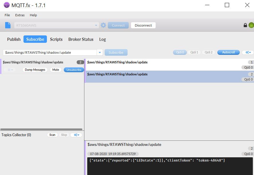

6.2 MQTTfx subscribe result
MQTTfx subscribe data
Turn on the led, we can subscribe two messages:
Fig. 6-4
Fig. 6-5
Turn off the led, we also can subscribe two messages:
Fig. 6-6
Fig. 6-7
In the two message, the first one is used to set the led status. The second one is the EVK used to report the EVK led information.
MQTTfx also can use the publish page, publish this data:
{"state":{"desired":{"LEDstate":1}}} or {"state":{"desired":{"LEDstate":0}}}
To topic: $aws/things/RTAWSThing/shadow/update
It also can realize the on board LED turn on or off.

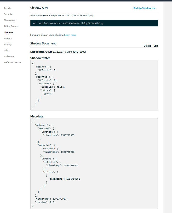

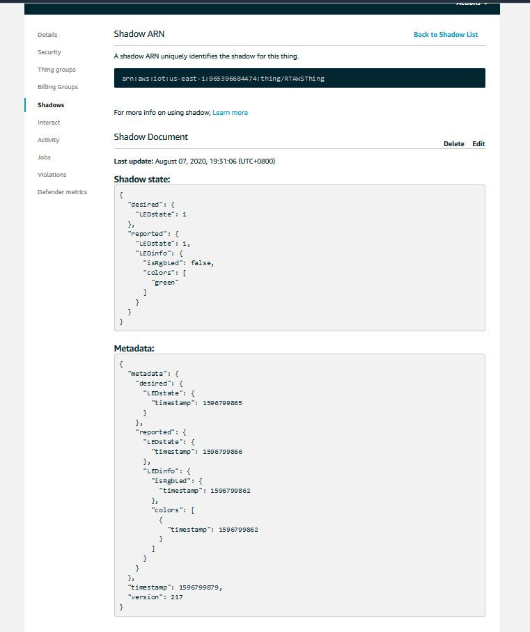

6.3 AWS cloud shadows display result
Turn on the led:
Fig. 6-8
Turn off the led:
Fig. 6-9
