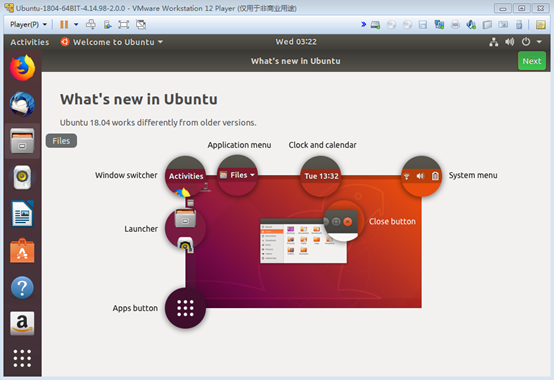

1. Installation of Ubuntu 18.04

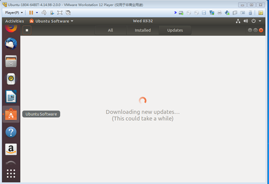

2.Update software

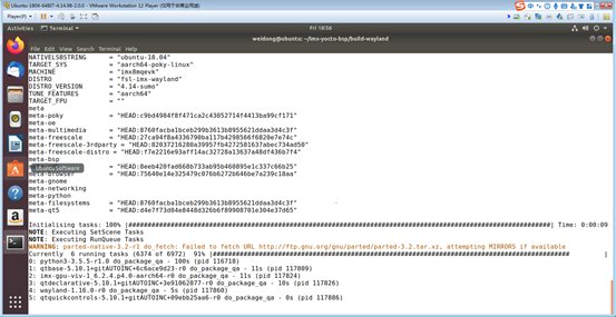

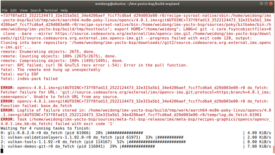

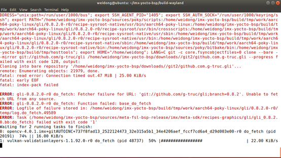

In the process of compilation, there have been many "fetch errors", which are caused by disconnection or timeout of network connection.
We just need to run the bitmake command again in the build Wayland subdirectory to continue the compilation.
# bitbake fsl-image-qt5-validation-imx
         Fetching errors below were what I encountered:

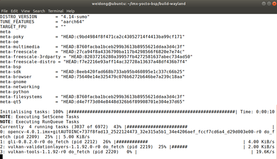

         The following picture is to re-run “bitbake fsl-image-qt5-validation-imx” after fetch errors occurred.
         In order to improve the speed of compilation , I re-configured vmware player, assigning 6 CPU cores for Ubuntu.
         Compilation is a long and arduous process. It took 4 days to compile normally with error handling. Finally, the compilation was completed.
So it means there is no any problem to compile L4.14.98-2.0.0 fsl-imx-waylan image on ubuntu 18.04 platform.
