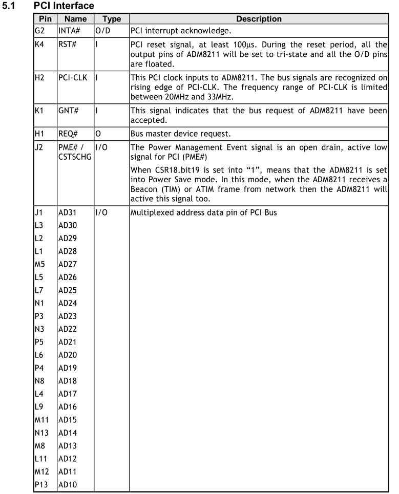

In imx8mq-evk platform,we test wifi use qca6174 model.But now we want to make product,but due to module import problem,we need each other to replace.how about adm8211 or what would you think about?
I checked ADM8211  datasheet, the WIFI module uses PCI interface, which is not supported by i.MX8MQ. So you can't select it.
>>Inferface of I.MX8MQ for WIFI module
---SDIO interface
---PCIe interface
---USB interface
The WIFI module you select must support one of above interface. Actually you have many choice , such as NXP's wifi , Broadcomm, QCA, Realtek etc.

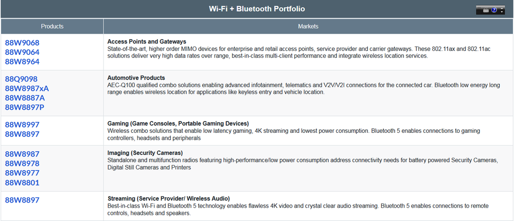

1. NXP's WIFI
Wi-Fi&reg + Bluetooth | NXP
2. Others

Hi wigros Sun:
Actually,we want to find wifi+ble model(wifi模组),not wifi chip ,because we dont want to do RF section.
Do you have any recommendations?
