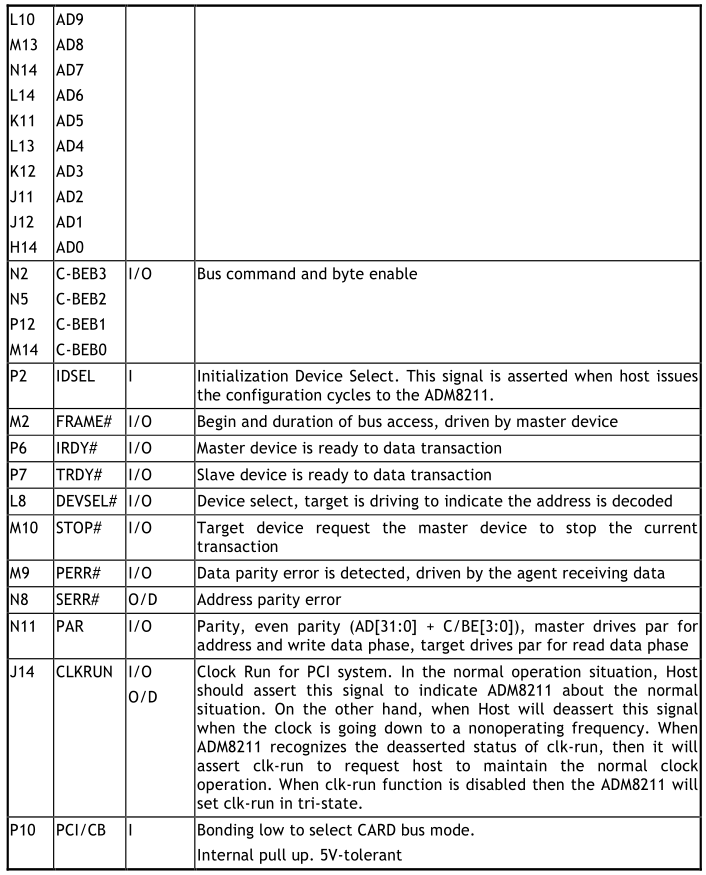

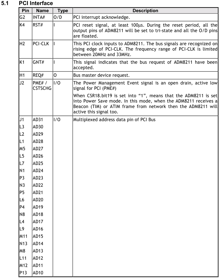

In imx8mq-evk platform,we test wifi use qca6174 model.But now we want to make product,but due to module import problem,we need each other to replace.how about adm8211 or what would you think about?
thinks!
3,602 Views
weidong_sun
Dear Gao bo,
I checked ADM8211  datasheet, the WIFI module uses PCI interface, which is not supported by i.MX8MQ. So you can't select it.

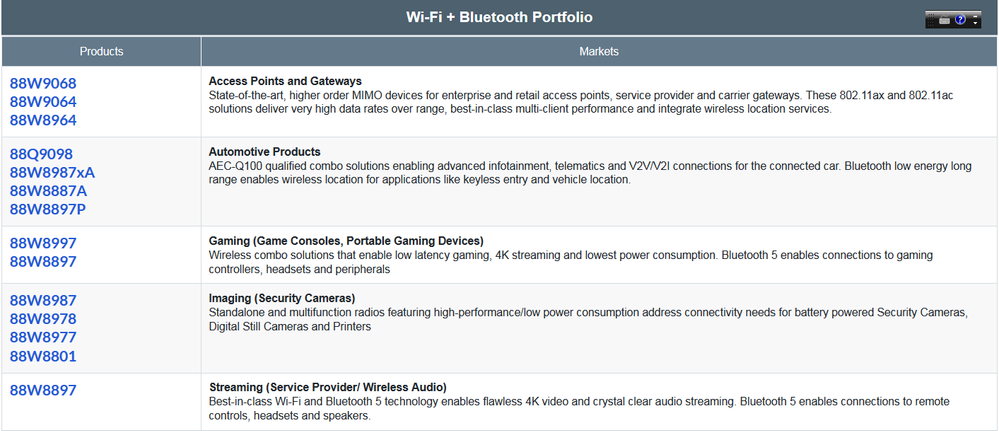

The WIFI module you select must support one of above interface. Actually you have many choice , such as NXP's wifi , Broadcomm, QCA, Realtek etc.
1. NXP's WIFI
Wi-Fi&reg + Bluetooth | NXP
2. Others
----QCA9880 with PCIe interface
----INTEL9260 with PCIe interface
Some customers have successfully used them.
----LBEE5KL1PJ based on QCA9377 with SDIO interface
the module is supported by i.MX8M Mini.
