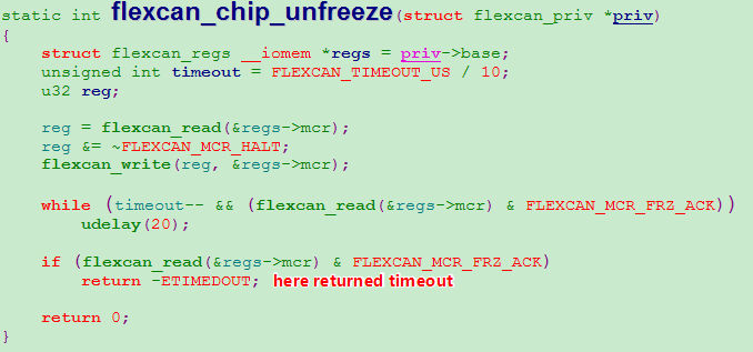

I get some problems when development with imx6ul processer, that i can't set the bitrate with 5000bps;
what i have done:
1. ifconfig can0 down
2. canconfig can0 bitrate 5000
3. ifconfig can0 up
the kernel logs;
flexcan 2090000.can can0: writing ctrl=0xf93e2057
flexcan 2090000.can can0: flexcan_set_bittiming: mcr=0x5980000f ctrl=0xf93e2057
flexcan 2090000.can can0: flexcan_chip_start: writing mcr=0x7de20209
flexcan 2090000.can can0: flexcan_chip_start: writing ctrl=0xf93eac57
bitrate details:
2: can0: <NOARP,ECHO> mtu 16 qdisc pfifo_fast state DOWN mode DEFAULT group default qlen 10
link/can promiscuity 0
can state STOPPED (berr-counter tx 0 rx 0) restart-ms 0
bitrate 5000 sample-point 0.708
tq 8333 prop-seg 8 phase-seg1 8 phase-seg2 7 sjw 1
flexcan: tseg1 4..16 tseg2 2..8 sjw 1..4 brp 1..256 brp-inc 1
clock 30000000
re-started bus-errors arbit-lost error-warn error-pass bus-off
0 0 0 0 0 0
RX: bytes packets errors dropped overrun mcast
0 0 0 0 0 0
TX: bytes packets errors dropped carrier collsns
0 0 0 0 0 0

one can look at patch below
can: flexcan: fix timeout when set small bitrate - Patchwork

thanks for your help!
