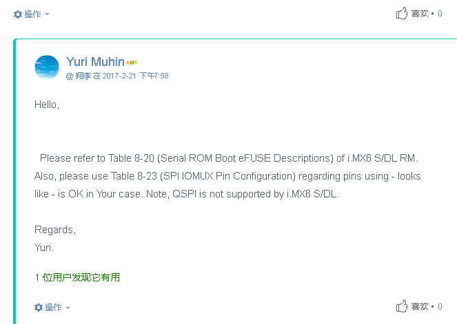

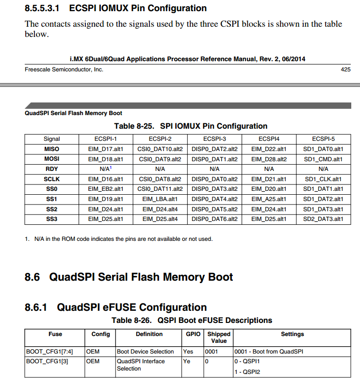

Also,I find that solo's RM pdf only has SPI IOMUX PIN configuration table,it is not show solo do not support dual or quad spi.but imx6-quad has quadspi chapter and do not show it support dual spi. I am missing.
