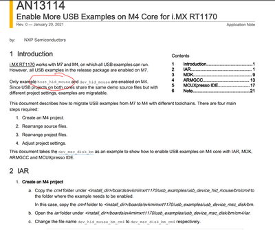

we need an example code for usb application by using RT1170 EVK
Now we found an application note (see below), but we dont know where can we get the example code, can anyone help?
we are using the SDK2.9.0  (MCUXpresso IDE v11.5.0 [Build 7232] )

The host_hid_mouse is inside the SDK.  I can see it in my side.
SDK_2_13_0_MIMXRT1170-EVK\boards\evkmimxrt1170\usb_examples\usb_host_hid_mouse
There should be a same demo under SDK2.9
