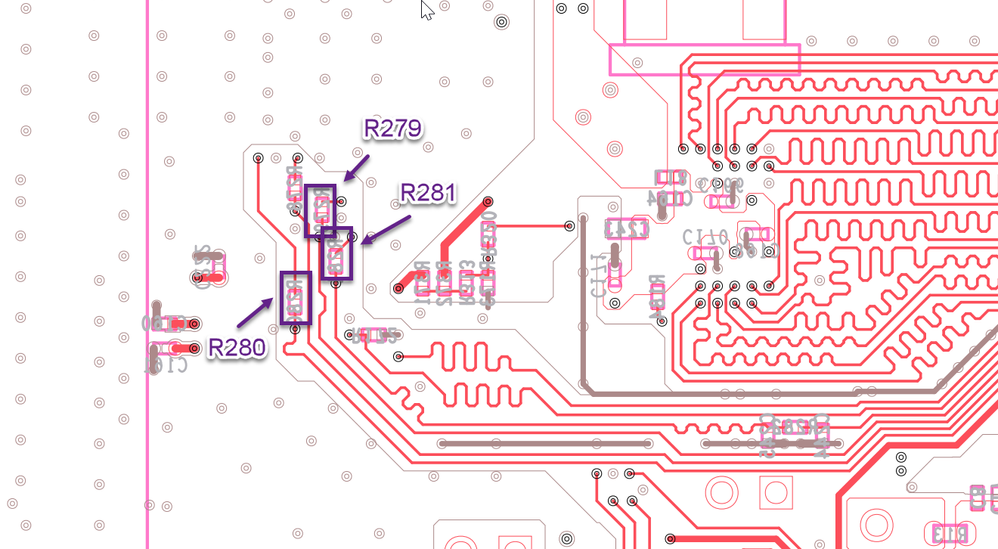

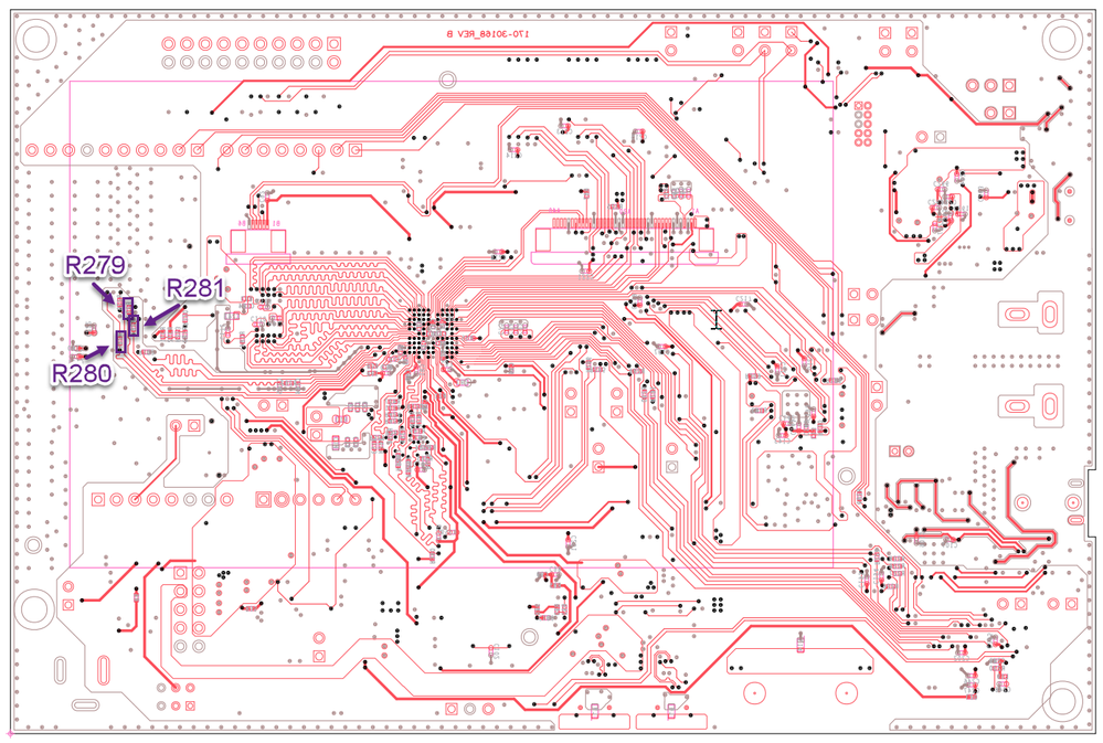

I am running NXP SDK pwm demo.  I do not see the pwm output.  A note says to put 0 Ohm resistors in those 3 locations to see the PWM output.  But, the RT1050EVK silk screen does not show any of those locations.  Where are they?
1,161 Views
EdwinHz
Hi @RABrisk,
From the Layout PDF found on the RT1050-EVKB Design Files:
BR,
Edwin.
