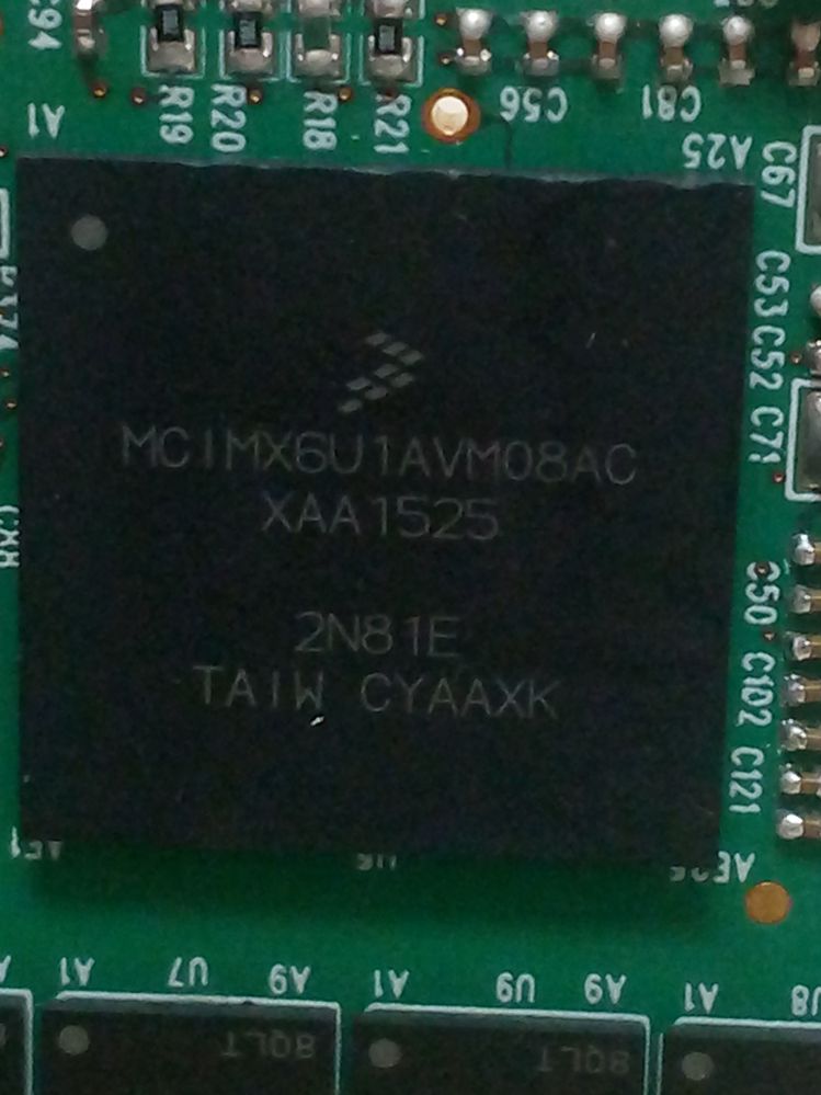

1. we have brought i.mx6  samples from Freescale part no is MCIMX6D6AVM08 which default frequency is 792Mhz
2. we purchased from vendors some Soc's, part no is MCIMX6D1AVM08 which default frequency is 396Mhz
how to configure it default to 792Mhz ? except writing to  CCM PLL registers

Actually it is not i.MX6D processor but i.MX6DL one.
As you see its Part Number begins from MCIMX6U not MCIMX6D.
Here is the description of MCIMX6U1AVM08 signs:
MCIMX6U -- i.MX6DL
1 -- Automotive with MLB and without EPDC, VPU and GPU
A -- Temperature : -40 to + 125C
VM -- MAPBGA 21x21 0.8mm
08 -- 800 (792) MHz
Please note that i.MX 6 Dual and DualLite processors are not the same.
You can refer i.MX 6Solo/6DualLite Applications Processor Reference Manual for the details.
Victor

I am confused with "1" after "MCIMX6D" in the Part Number.
Officially we have only these options:
4 -- Automotive, with GPU, without VPU
5 -- Consumer, with VPU and GPU
6 -- Automotive, with VPU and GPU
7 -- Industrial, with VPU and GPU, without MLB
Please make a clear picture of the chip with the Part Number
for I forward it to clarify which processor it is.
Victor

Thank your reply my chip part number is MCIMX6U1AVM08
i attaching picture of it please verify and giveme reply
thanks
