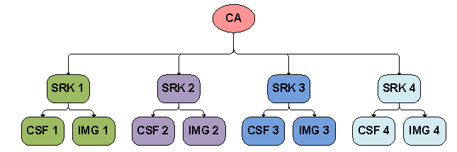

However, it fails to load the kernel and it works when I signed both images csf1/img1 or csf3/img3.
what should be take care on CSF text file?

Yuri
   Below is Figure 2 (HABv4 PKI tree) of AN4581 Application Note, Rev. 2, 05/2018
SRK1 signs CSF1 / IMG1 pair, SRK3 signs CSF3/IMG3, but in the note: "The same SRK must be used
when extending the root of trust beyond the initial boot image."
Yuri
