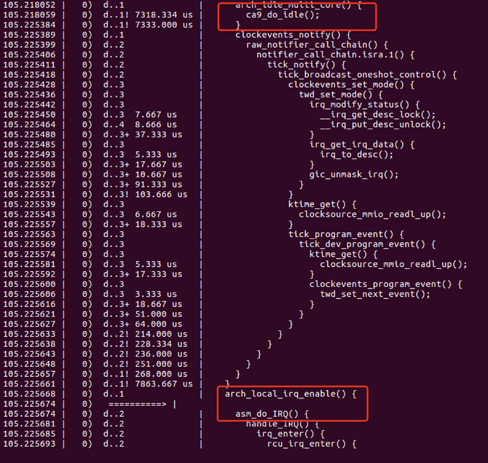

I'm debugging UART receive buffer overflow issue om iMX.6Q,  I found that wfi wakeup latency is more than 1ms, is this meets the iMX6's parameter?
SW version: linux-3.0.35
Method: ftrace with almost all function_graph
work flows:
tick 105.225384:  arch_idle_multi_core -> ca9_do_idle()    exit wfi sleep due to interrupt
tick 105.225389: start wakeup process
tick 105.225668: arch_local_irq_enable() .

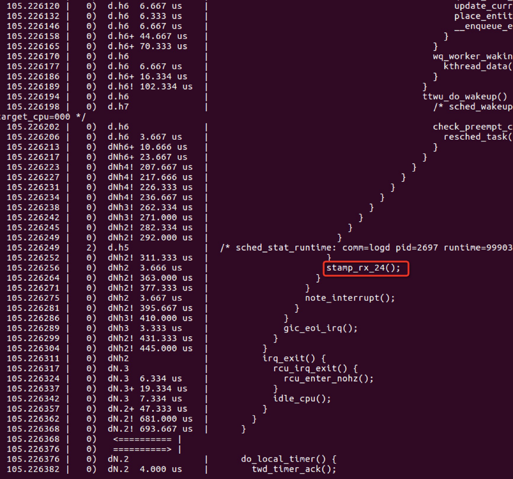

tick 105.225674: asm_do_IRQ() { .       ;UART IRQ routines
tick 105.226256:    stamp_rx_24()   } .  ;here received 24 byte from UART buffer
UART config:115200@8N1  UART IRQ trigger threshold:1byte
For 24 byte transfer, the least time is 1000 * 24 * (1start + 8bit + 1stop) / 115200 = 2.083ms
So I guess the first byte received tick is 105.226256 - 2.083ms = 105.224173s
From the ftrace result, the wakeup tick is 105.225384s;
WFI wakeup latency: 105.225384s - 105.224173s = 1.211ms

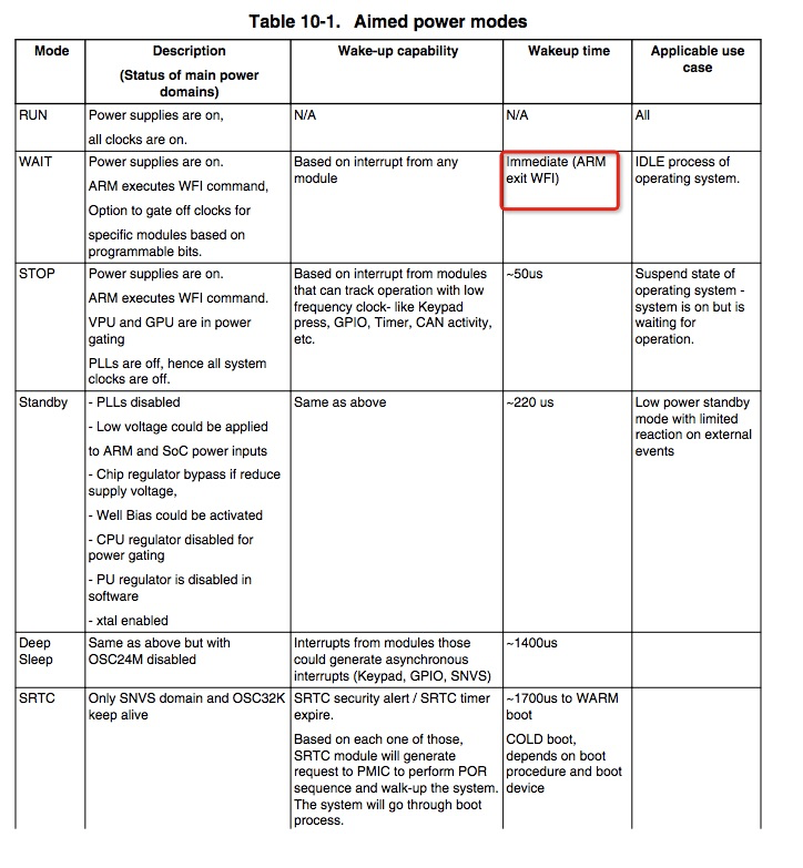

for wake up times one can look at Table 10-1. Aimed power modes
i.MX6SDL Reference Manual.
However depending of processor loading times may be bigger.
https://www.nxp.com/webapp/Download?colCode=IMX6SDLRM
igor

  Thanks for your reply, I've seem the IMX6SDLRM and it shows that WFI wakeup time is "immediate". This value didn't match my test result(>1ms), can you help to explain it ?

latencies may be caused by software, Table 10-1 gives theoretical values.

  WFI-->CPU waiting for interrupt-->wakeup & continue to exec the following code.  According to my calculation, the "wakeup" point has been delay 1.211ms.
   Can you read my detailed derivation process?
