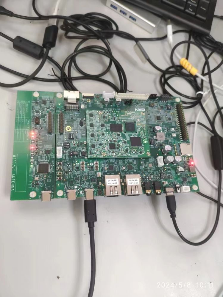

I had an error while upgrading mcimx93.As shown in attachment.Can you see what's going on?There is no problem with the imx8mm upgrade.

Latest images are not supported on A0 silicon revision, the latest working release on that silicon revision is Linux 6.1.22_2.0.0.

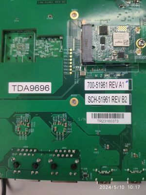

Could you please help me with the next information?
- i.MX93 silicon revision.
- Linux version.
Best regards.

U-Boot 2023.04-lf_v2023.04+gaf7d004eaf (Jun 06 2023 - 14:59:40 +0000)
CPU: i.MX93(52) rev1.0 1700 MHz (running at 1692 MHz)
CPU: Consumer temperature grade (0C to 95C) at 36C
Reset cause: POR (0x1)
Model: NXP i.MX93 11X11 EVK board
DRAM: 1.7 GiB
TCPC: Vendor ID [0x1fc9], Product ID [0x5110], Addr [I2C2 0x52]
LF_v6.6.3-1.0.0_images_IMX93EVK
