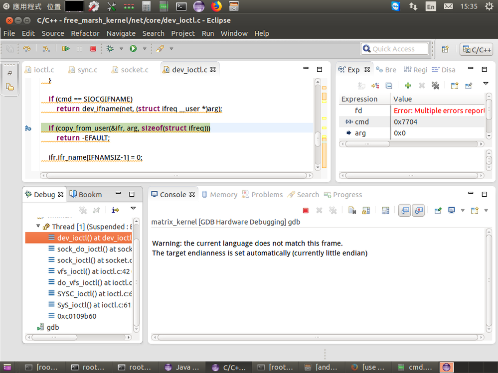

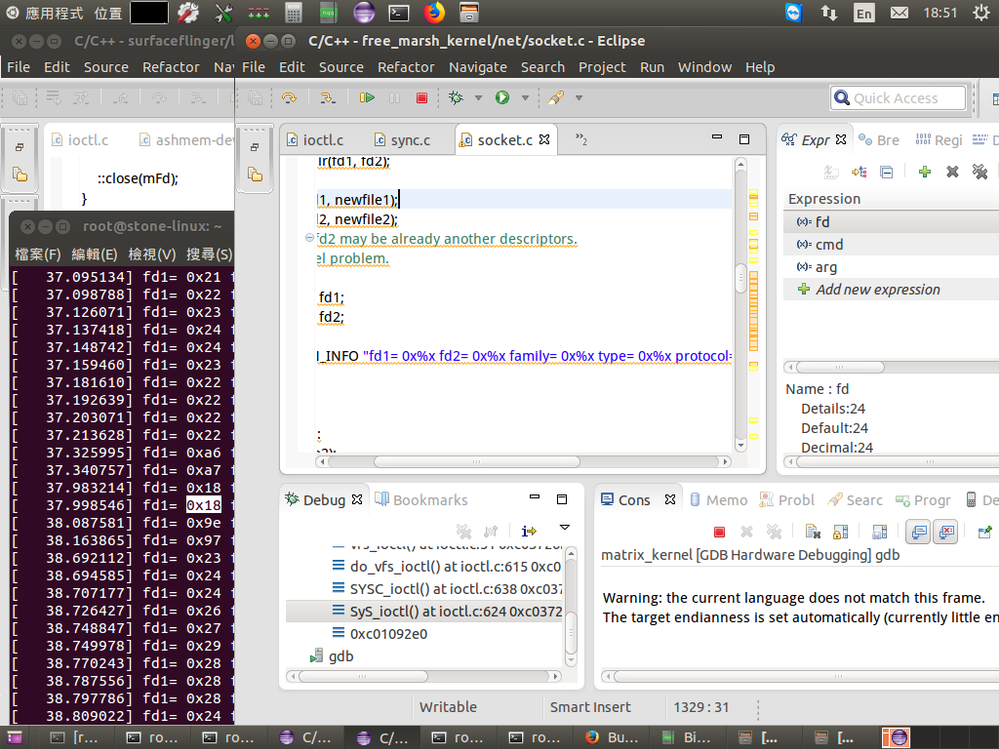

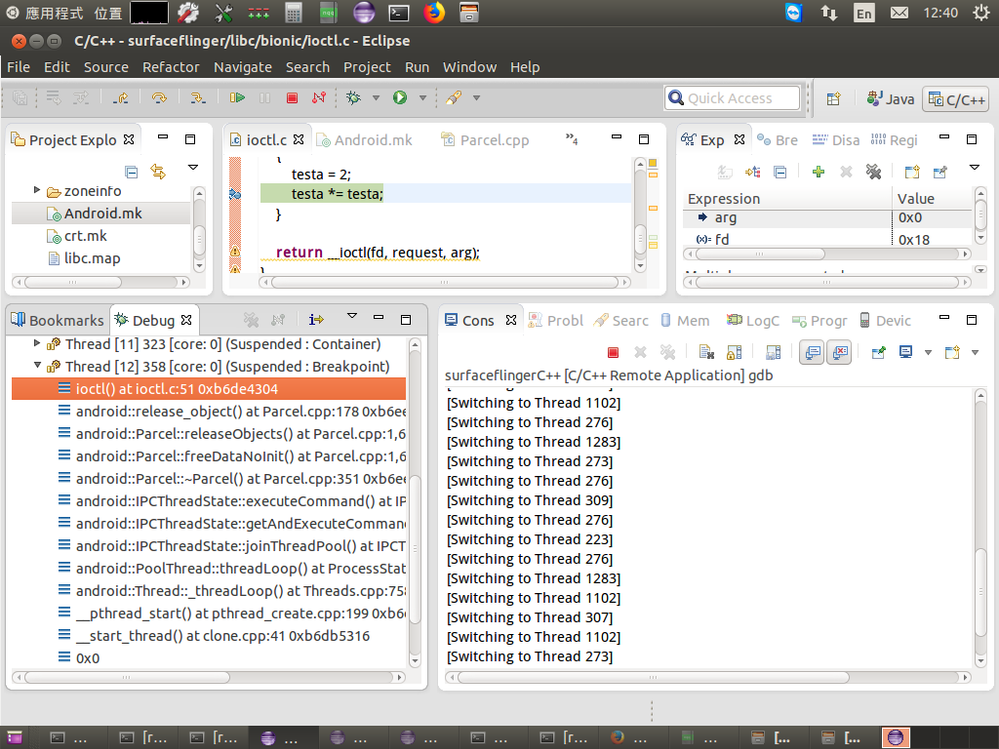

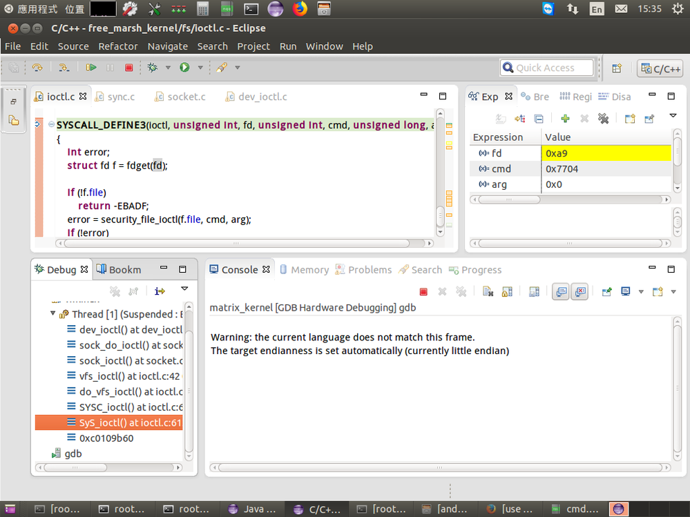

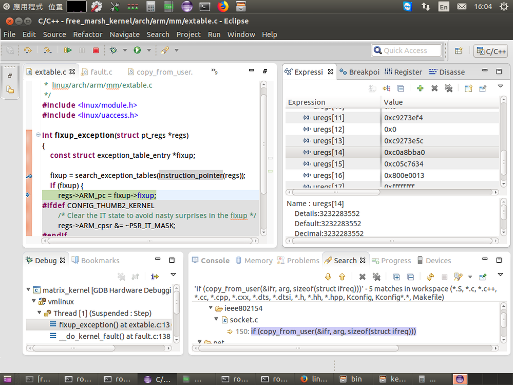

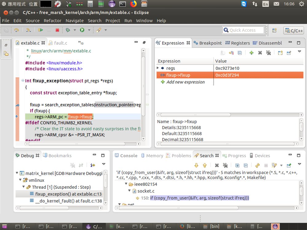

use sock can api will crash in kernel
22,859 Views
fatalfeel
Contributor V

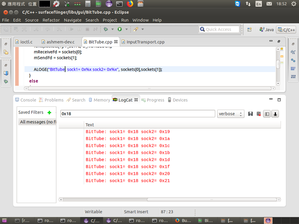

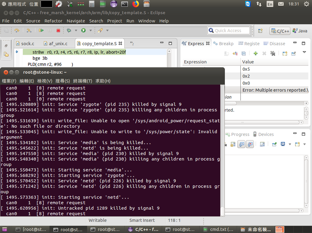

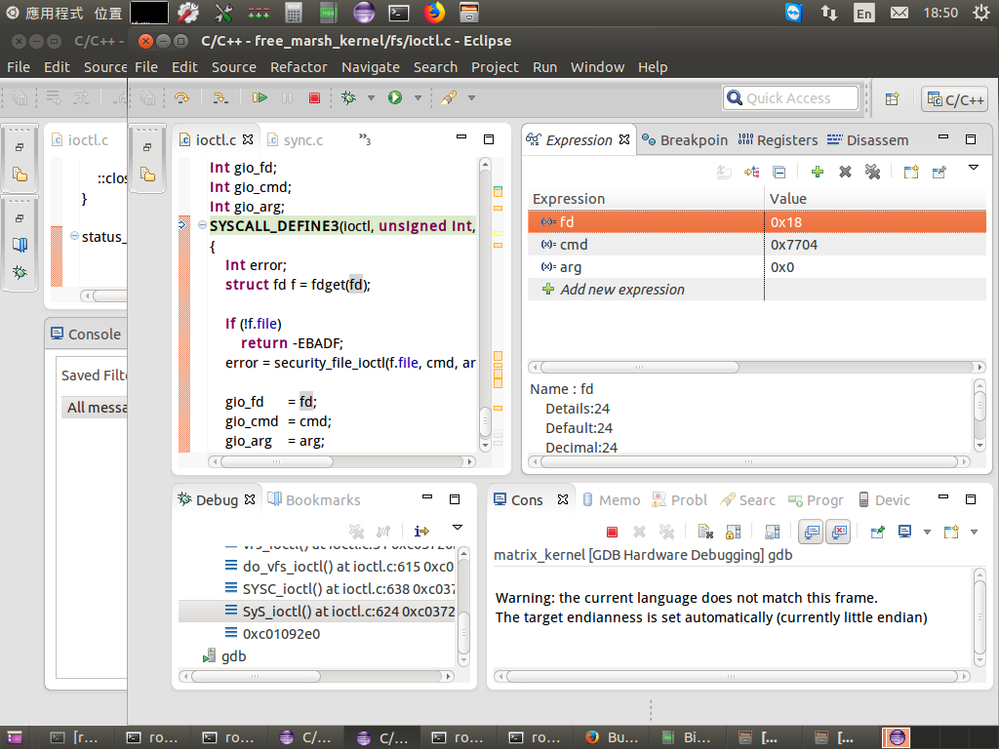

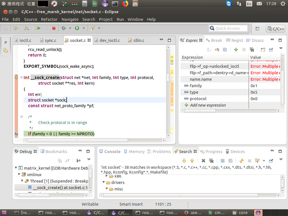

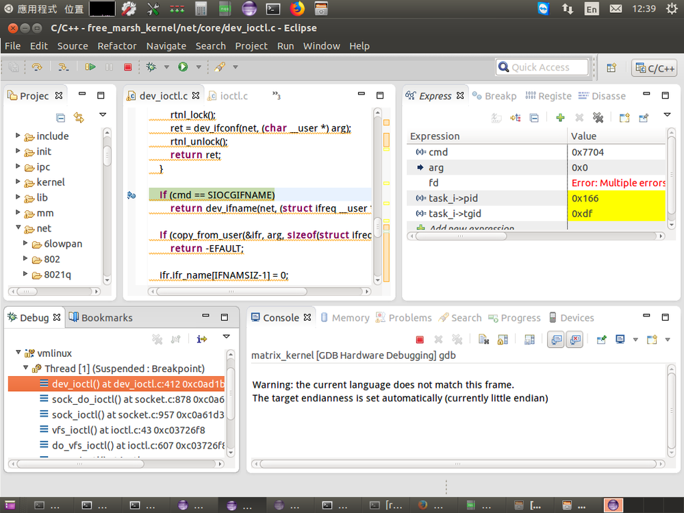

in canutils/candump.c
socket(PF_CAN, SOCK_RAW, CAN_RAW);
nbytes = recvmsg(s[i], &msg, 0);
sometimes crash in linux kernel

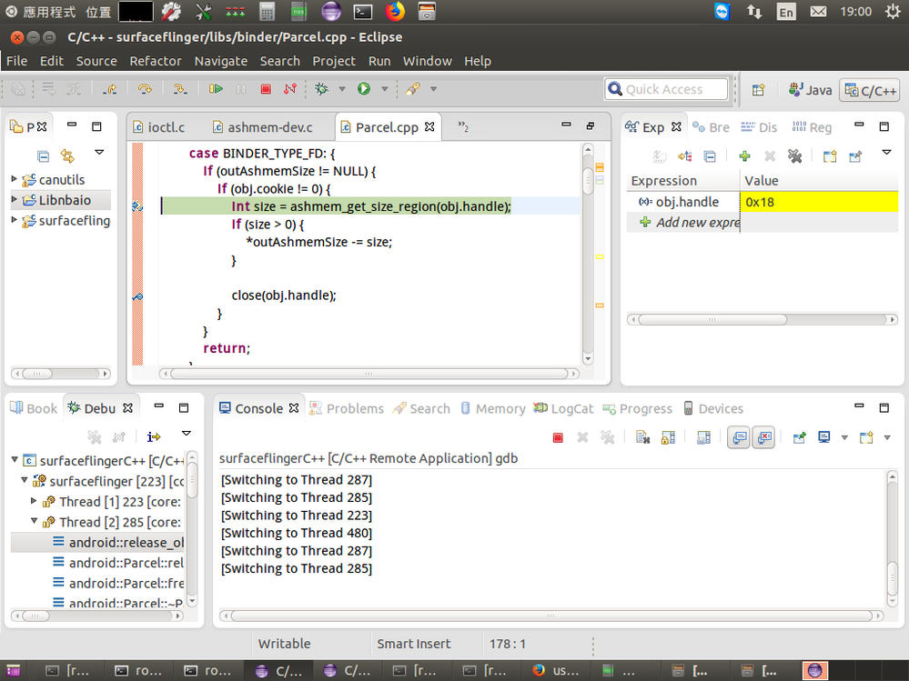

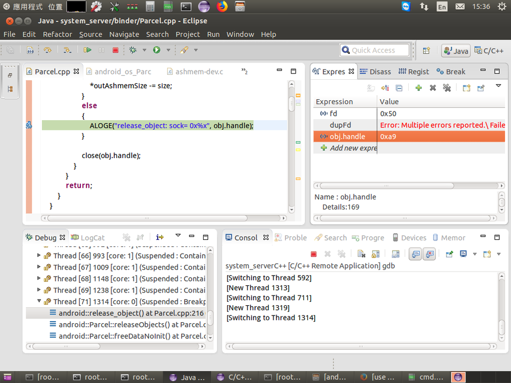

//new link dup fd, ASHMEM_GET_SIZE=0x7704 arg = NULL;
//will cause kernel crash
case BINDER_TYPE_FD:
    if (outAshmemSize != NULL)
        if (obj.cookie != 0)
            int size = ashmem_get_size_region(obj.handle); //here crash
            if (size > 0)
                *outAshmemSize -= size;
            else
                ALOGE("release_object: sock= 0x%x", obj.handle);
            close(obj.handle);
    return;
int ashmem_get_size_region(int fd)
  return ioctl(fd, ASHMEM_GET_SIZE, NULL);
20,624 Views

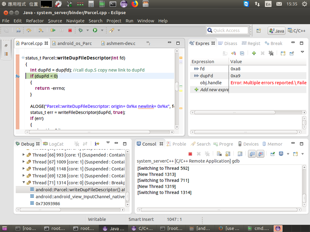

Contributor V
myandroid/frameworks/native/libs/binder/Parcel.cpp
status_t Parcel::writeDupFileDescriptor(int fd)
    int dupFd = dup(fd); //call dup.S
//~myandroid/bionic/libc/arch-arm/syscalls/dup.S
ENTRY(dup)
    mov        ip, r7            /*ip=r12*/
    ldr        r7, =__NR_dup     /*__NR_dup=41*/
    swi        #0
    mov         r7, ip
    cmn        r0, #(MAX_ERRNO + 1)
    bxls        lr
    neg         r0, r0
    b           __set_errno_internal
END(dup)
//disassembly to c
unsigned int __fastcall dup(unsigned int a1)
  unsigned int result;        //result use r0
  result = sys_dup(a1);    //__NR_dup=sys_dup
  if ( result > 0xFFFFF000 )
    result = _set_errno_internal(-result);
  return result;
//~myandroid/kernel_imx/fs/file.c
SYSCALL_DEFINE1(dup, unsigned int, fildes)
    int ret = -EBADF;
    struct file *file = fget_raw(fildes);
    if (file)
        ret = get_unused_fd_flags(0);
        if (ret >= 0)
            fd_install(ret, file);
        else
            fput(file);
    return ret;
sys_dup
1.use fildes to get the struct [file]
2.get unused file desc assign to [ret]
3.[ret] link to [file]
20,624 Views
fatalfeel
Contributor V
the [fd] of int ashmem_get_size_region(int fd)
should come from fd = open(ASHMEM_DEVICE, O_RDWR);
if the [fd] of int ashmem_get_size_region(int fd)
from the socketpair(AF_UNIX, SOCK_SEQPACKET, 0, sockets) //sockets[fd1] sockets[fd2]
when meet BINDER_TYPE_FD -> int size = ashmem_get_size_region(obj.handle);  will be wrong
20,625 Views

//in system_server process the andorid [binder] bug
//the socketpair fd should not use ashmem_get_size_region with arg=Null
InputTransport.h
inline int getFd() const { return mFd; }
InputTransport.cpp
InputChannel::InputChannel(const String8& name, int fd) :
mName(name), mFd(fd)
#if DEBUG_CHANNEL_LIFECYCLE
    ALOGD("Input channel constructed: name='%s', fd=%d",
            mName.string(), fd);
#endif
    int result = fcntl(mFd, F_SETFL, O_NONBLOCK);
    LOG_ALWAYS_FATAL_IF(result != 0, "channel '%s' ~ Could not make socket "
            "non-blocking.  errno=%d", mName.string(), errno);
status_t InputChannel::openInputChannelPair(    const String8& name,
                                                                                    sp<InputChannel>& outServerChannel,
                                                                                    sp<InputChannel>& outClientChannel)
    int sockets[2];
    if (socketpair(AF_UNIX, SOCK_SEQPACKET, 0, sockets)) //here
        status_t result = -errno;
        ALOGE("channel '%s' ~ Could not create socket pair.  errno=%d", name.string(), errno);
        outServerChannel.clear();
        outClientChannel.clear();
        return result;
    int bufferSize = SOCKET_BUFFER_SIZE;
    setsockopt(sockets[0], SOL_SOCKET, SO_SNDBUF, &bufferSize, sizeof(bufferSize));
    setsockopt(sockets[0], SOL_SOCKET, SO_RCVBUF, &bufferSize, sizeof(bufferSize));
    setsockopt(sockets[1], SOL_SOCKET, SO_SNDBUF, &bufferSize, sizeof(bufferSize));
    setsockopt(sockets[1], SOL_SOCKET, SO_RCVBUF, &bufferSize, sizeof(bufferSize));
    String8 serverChannelName = name;
    serverChannelName.append(" (server)");
    outServerChannel = new InputChannel(serverChannelName, sockets[0]);
    String8 clientChannelName = name;
    clientChannelName.append(" (client)");
    outClientChannel = new InputChannel(clientChannelName, sockets[1]); //here
    return OK;
android_view_InputChannel.cpp
static void android_view_InputChannel_nativeWriteToParcel(JNIEnv* env, jobject obj, jobject parcelObj)
    Parcel* parcel = parcelForJavaObject(env, parcelObj);
    if (parcel)
        NativeInputChannel* nativeInputChannel = android_view_InputChannel_getNativeInputChannel(env, obj);
        if (nativeInputChannel)
            sp<InputChannel> inputChannel = nativeInputChannel->getInputChannel();
            parcel->writeInt32(1);
            parcel->writeString8(inputChannel->getName());
            parcel->writeDupFileDescriptor(inputChannel->getFd()); //here save fd
        else
            parcel->writeInt32(0);
Parcel.cpp
status_t Parcel::writeFileDescriptor(int fd, bool takeOwnership)
    flat_binder_object obj;
    obj.type = BINDER_TYPE_FD;
    obj.flags = 0x7f | FLAT_BINDER_FLAG_ACCEPTS_FDS;
    obj.binder = 0;
    obj.handle = fd; //here save fd
    obj.cookie = takeOwnership ? 1 : 0;
    return writeObject(obj, true);
    if (dupFd < 0)
        return -errno;
    status_t err = writeFileDescriptor(dupFd, true); //here save fd
    if (err)
        close(dupFd);
    return err;
static void release_object(const sp<ProcessState>& proc,
                                                 const flat_binder_object& obj,
                                                 const void* who,
                                                 size_t* outAshmemSize)
                    if (size > 0)
                    close(obj.handle);
            return;
ashmem-dev.c
  return ioctl(fd, ASHMEM_GET_SIZE, NULL); //use socketpair fd call kernel with arg = NULL so kernel crash
20,626 Views

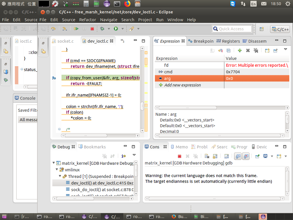

how android create fd and use arg = 0
20,627 Views
fatalfeel
Contributor V
android open socket to kernel socketpair -> __sock_create AF_UNIX, SOCK_SEQPACKET, 0
and use this fd to ioctl and arg = 0; so it crash
20,627 Views
fatalfeel
Contributor V
android wrong fd call arg = NULL
ashmem_get_size_region call ioctl(int fd, int request, ...)
~myandroid/bionic/libc/bionic/ioctl.c
kernel should go sync_fence_ioctl
~myandroid/kernel_imx/drivers/staging/android/sync.c
but go wrong to sock_ioctl
~myandroid/kernel_imx/net/socket.c
~myandroid/frameworks/native/libs/binder/Parcel.cpp
Line 178:
case BINDER_TYPE_FD: {
            if (outAshmemSize != NULL) {
                if (obj.cookie != 0) {
                    int size = ashmem_get_size_region(obj.handle);  //->here
                    if (size > 0) {
                    close(obj.handle);
            return;
20,627 Views
fatalfeel
Contributor V

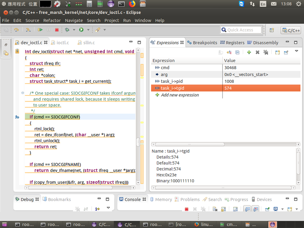

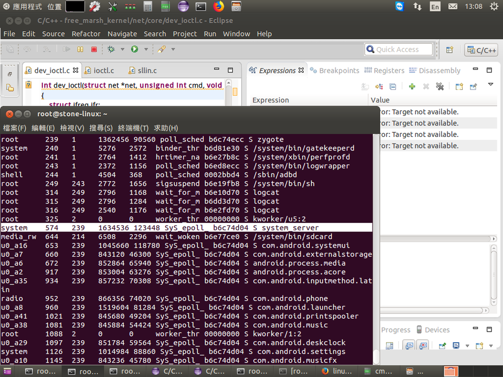

the system_server call socket ioctl(fd, 0x7704, NULL)
so the kernel crash
20,627 Views

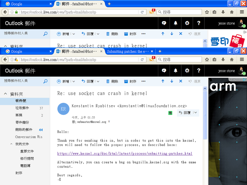

fatalfeel
Contributor V
linux developer reponse
21,507 Views

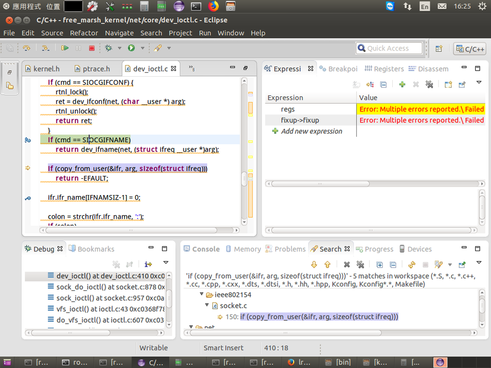

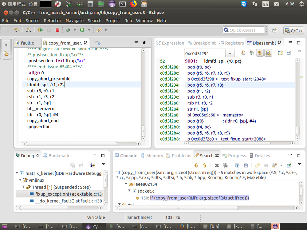

modify here
1.
~myandroid/kernel_imx/arch/arm/include/asm/uaccess.h
static inline unsigned long __must_check copy_from_user(void *to, const void __user *from, unsigned long n)
    if (access_ok(VERIFY_READ, from, n))
        /*** begin: issue #: avoid arg crash in copy_from_user ***/
        if ( from )
            n = __copy_from_user(to, from, n);
        /*** end: issue #: avoid arg crash in copy_from_user ***/
    else /* security hole - plug it */
        memset(to, 0, n);
    return n;
2.
~myandroid/kernel_imx/arch/arm/lib/copy_from_user.S
ENDPROC(__copy_from_user)
    /*** begin: issue #5404: socket can ***/
    /*.pushsection .fixup,"ax"*/
    .pushsection .text.fixup,"ax"
    /*** end: issue #5404 ***/
    .align 0
    copy_abort_preamble
    ldmfd    sp!, {r1, r2}
    sub    r3, r0, r1
    rsb    r1, r3, r2
    str    r1, [sp]
    bl    __memzero
    ldr    r0, [sp], #4
    copy_abort_end
    .popsection
3.
~myandroid/kernel_imx/drivers/scsi/mac_scsi.c
search all .fixup
change to
.text.fixup
20,627 Views
fatalfeel
Contributor V
// how to make __ex_table with .text.fixup table
.config
#CONFIG_THUMB2_KERNEL is not set
//get [usracc] define
~myandroid/kernel_imx/arch/arm/include/asm/assembler.h
.macro    usracc, instr, reg, ptr, inc, cond, rept, abort, t=TUSER()
    .rept    \rept
9999:
    .if    \inc == 1
    \instr\cond\()b\()\t \reg, [\ptr], #\inc
    .elseif    \inc == 4
    \instr\cond\()\t \reg, [\ptr], #\inc
    .else
    .error    "Unsupported inc macro argument"
    .endif
    .pushsection __ex_table,"a"
    .align    3
    .long    9999b, \abort
    .popsection
    .endr
    .endm
labelf = label forward
labelb = label backward
9999b - >
9999:
///get [ldrusr] define
    .macro    ldrusr, reg, ptr, inc, cond=al, rept=1, abort=9001f
    usracc    ldr, \reg, \ptr, \inc, \cond, \rept, \abort
    .endm
The 'abort' argument is used for fixup tables
///get [ldr8w] define
    .macro ldr8w ptr reg1 reg2 reg3 reg4 reg5 reg6 reg7 reg8 abort
    ldr4w \ptr, \reg1, \reg2, \reg3, \reg4, \abort
    ldr4w \ptr, \reg5, \reg6, \reg7, \reg8, \abort
    .endm
    .macro ldr4w ptr reg1 reg2 reg3 reg4 abort
    ldr1w \ptr, \reg1, \abort
    ldr1w \ptr, \reg2, \abort
    ldr1w \ptr, \reg3, \abort
    ldr1w \ptr, \reg4, \abort
    .endm
    .macro ldr1w ptr reg abort
    ldrusr    \reg, \ptr, 4, abort=\abort
    .endm
///get [copy_abort_preamble]
19:    ldmfd    sp!, {r5 - r9}
    b    21f
20:    ldmfd    sp!, {r5 - r8}
21:
//get [copy_abort_end]
ldmfd    sp!, {r4, pc}
~myandroid/kernel_imx/arch/arm/lib/copy_template.S
ldr8w    r1, r3, r4, r5, r6, r7, r8, ip, lr, abort=20f
expand ldr8w command:
c05d0034:   ldr r3, [r1], #4
c05d0038:   ldr r4, [r1], #4
c05d003c:   ldr r5, [r1], #4
c05d0040:   ldr r6, [r1], #4
c05d0044:   ldr r7, [r1], #4
c05d0048:   ldr r8, [r1], #4
c05d004c:   ldr r12, [r1], #4
c05d0050:   ldr lr, [r1], #4
abort = 20f
ENTRY(__copy_from_user)
 #include "copy_template.S"
    .align 0
    copy_abort_preamble
    ldmfd    sp!, {r1, r2}
 line 116: ldr8w    r1, r3, r4, r5, r6, r7, r8, ip, lr, abort=20f  in  0xc05d0034
 0xc05d0034 -> to data is 34005dc0
 find 34005dc0 and next data a47cd4c0
 a47cd4c0 to address is 0xc0d47ca4
 0xc0d47ca4 in line 102: copy_abort_preamble
 when run into myandroid/kernel_imx/arch/arm/mm/extable.c
 int fixup_exception(struct pt_regs *regs)
search_exception_tables will input 0xc05d0034
and find fixup section 0xc0d47ca4
then  regs->eip = 0xc0d47ca4

fatalfeel
Contributor V
arg = 0 then r1 = 0 will go .text.fixup
    if (copy_from_user(&ifr, arg, sizeof(struct ifreq)))
        return -EFAULT;
and  can not find .text.fixup go crash

fatalfeel
Contributor V
refert to http://visualgdb.com/gdbreference/commands/disassemble
make sure enable CONFIG_DEBUG_INFO=y CONFIG_FRAME_POINTER=y in config
in myandroid/kernel_imx/arch/arm/mm/fault.c
static void __do_kernel_fault(struct mm_struct *mm, unsigned long addr, unsigned int fsr, struct pt_regs *regs)
printlog(regs->uregs14); //get LR last function call
printlog(regs->uregs15); //get PC last crash address
if (fixup_exception(regs))
      return;
get
LR = reg14= 0xc0a8bba0
PC = reg15= 0xc05c7634
//use arm gdb in console
/mnt/projects/marsh_mnt/myandroid/prebuilts/gcc/linux-x86/arm/arm-linux-androideabi-4.9/bin/arm-linux-androideabi-gdb /mnt/projects/marsh_mnt/out/matrix_io/kernel/vmlinux
(gdb) disassemble /m 0xc0a8bba0,0xc0a8bba0+0x32
Dump of assembler code from 0xc0a8bba0 to 0xc0a8bbd2:
413 if (copy_from_user(&ifr, arg, sizeof(struct ifreq)))
0xc0a8bba0 <dev_ioctl+652>: cmp r0, #0

*(gdb) disassemble /m address,address+0x32
*If dump empty then change [0x32] to any other value like 0x16 0x64 0x128
(gdb) info line *0xc0a8bba0
Line 413 of "/mnt/projects/marsh_mnt/myandroid/kernel_imx/net/core/dev_ioctl.c"
   starts at address 0xc0a8bba0 <dev_ioctl+652>
   and ends at 0xc0a8bbac <dev_ioctl+664>.
//and
(gdb) info line *0xc05c7634
Line 135 of "/mnt/projects/marsh_mnt/myandroid/kernel_imx/arch/arm/lib/copy_from_user.S" starts at address 0xc05c7634 <__copy_from_user+76>
   and ends at 0xc05c7654 <__copy_from_user+108>.
find source dev_ioctl.c -> if (copy_from_user(&ifr, arg, sizeof(struct ifreq)))        is last call
find source copy_template.S -> ldr8w r1, r3, r4, r5, r6, r7, r8, ip, lr, abort=20f                is last crash
https://fatalfeel.blogspot.tw/2013/09/use-gdb-find-crash-source-line.html#more
20,627 Views
fatalfeel
Contributor V
myandroid/kernel_imx/arch/arm/lib/copy_from_user.S + myandroid/kernel_imx/arch/arm/lib/copy_template.S
4:        ldr8w    r1, r3, r4, r5, r6, r7, r8, ip, lr, abort=20f  --> this line error and go find text.fixup
r0    0xcbaabea8
r1    0x0
r2    0xffffffa0
r3    0x0
r4    0x7704
r5    0xc13bc840
r6    0x0
r7    0x0
r8    0x7704
r9    0xa8
r10    0x0
r11    0xcbaabef4
r12    0x0
sp    0xcbaabe5c
lr    0xc0a8bba0
pc    0xc05c7634
20,627 Views
fatalfeel
Contributor V
i am so sure it's a kernel bug!!!
~myandroid/kernel_imx/arch/arm/include/uapi/asm/ptrace.h
#ifndef __KERNEL__
struct pt_regs {
    long uregs[18];
#endif /* __KERNEL__ */
#define ARM_cpsr    uregs[16]
#define ARM_pc        uregs[15]
#define ARM_lr        uregs[14]
#define ARM_sp        uregs[13]
#define ARM_ip        uregs[12]
#define ARM_fp        uregs[11]
#define ARM_r10        uregs[10]
#define ARM_r9        uregs[9]
#define ARM_r8        uregs[8]
#define ARM_r7        uregs[7]
#define ARM_r6        uregs[6]
#define ARM_r5        uregs[5]
#define ARM_r4        uregs[4]
#define ARM_r3        uregs[3]
#define ARM_r2        uregs[2]
#define ARM_r1        uregs[1]
#define ARM_r0        uregs[0]
#define ARM_ORIG_r0    uregs[17]
int dev_ioctl(struct net *net, unsigned int cmd, void __user *arg)
        return -EFAULT;
    .align 0
    copy_abort_preamble
    ldmfd    sp!, {r1, r2}
    sub    r3, r0, r1
    rsb    r1, r3, r2
    str    r1, [sp]
    bl    __memzero
    ldr    r0, [sp], #4
    copy_abort_end
    .popsection
20,627 Views
fatalfeel
Contributor V
if  CONFIG_ARM_UNWIND=n
and
and
use error section .pushsection .fixup,"ax"
the kernel will crash in random and often in SCHED and LOCK code
//can do this and i test pass and ok
1.
For full backtrace and jtag call stack view
CONFIG_ARM_UNWIND=n in default config
and
~/myandroid/kernel_imx/arch/arm/Kconfig.debug
config ARM_UNWIND
    bool "Enable stack unwinding support (EXPERIMENTAL)"
    depends on AEABI
### begin: issue : aviod warning: unwinding may not work because EXIDX ###
    # default y
    default n
### end: issue  ###
 aviod warning: unwinding may not work because EXIDX  in build code
https://lists.linaro.org/pipermail/linaro-dev/2014-December/017686.html
2.
myandroid/kernel_imx/include/asm-generic/vmlinux.lds.h
#define TEXT_TEXT               \
        ALIGN_FUNCTION();       \
        *(.text.hot)                      \
        /* *(.text .text.fixup) */  \  /* modify here */
        *(.text)                         \  /* keep .text */
        *(.ref.text)                       \
    MEM_KEEP(init.text)           \
    MEM_KEEP(exit.text)           \
        *(.text.unlikely)
kernel_imx/arch/arm/kernel/vmlinux.lds.S
.text : {            /* Real text segment        */
        _stext = .;        /* Text and read-only data    */
            IDMAP_TEXT
            __exception_text_start = .;
            *(.exception.text)
            __exception_text_end = .;
            IRQENTRY_TEXT
            TEXT_TEXT
            SCHED_TEXT
            LOCK_TEXT
            KPROBES_TEXT
/*** begin: issue #add this: why use align refer to TEXT_TEXT of vmlinux.lds.h ***/
#ifdef CONFIG_MMU
            ALIGN_FUNCTION(); \
            *(.text.fixup)
#endif
/*** end: issue #add this ***/
            *(.gnu.warning)
            *(.glue_7)
            *(.glue_7t)
        . = ALIGN(4);
        *(.got)            /* Global offset table        */
            ARM_CPU_KEEP(PROC_INFO)
    /*.pushsection .fixup,"ax"*/     /*section error*/
    .pushsection .text.fixup,"ax"  /*change .fixup to .text.fixup*/
    .align 0
    copy_abort_preamble
    ldmfd    sp!, {r1, r2}
    sub    r3, r0, r1
    rsb    r1, r3, r2
    str    r1, [sp]
    bl    __memzero
    ldr    r0, [sp], #4
    copy_abort_end
    .popsection

service  media and zygote re
