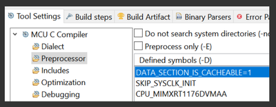

Hello, I am using the USB_CDC_VCOM_BM_CM7 code, but I have not been able to trigger the receive and send interrupt. I used my own development board with the usb3.0 driver and RT1170 as the slave. The enumeration can be successful, but it has been unable to reach the data transmission stage. Trigger the interrupt of RT1170. Can CDC_VCOM_BM_CM7 be used directly? Is there anything that needs to be modified?

Please refer below feedback:
If data section is cacheable, need to check two point:
1. DATA_SECTION_IS_CACHEABLE=1 must be added into project.
2. Heap used by USB stack should be placed into non-cacheable region.
Please refer to picture below, after apply the two change, it now works.
Wish it helps.

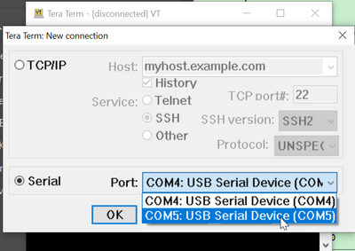

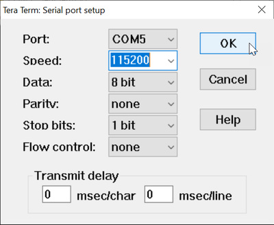

Hui_Ma
Please refer the <readme.pdf> file, which located at ..\SDK_2_12_0_MIMXRT1170-EVK\boards\evkmimxrt1170\usb_examples\usb_device_cdc_vcom\bm\cm7 folder.
Related driver could be found at \SDK_2_12_0_MIMXRT1170-EVK\boards\evkmimxrt1170\usb_examples\usb_device_cdc_vcom\inf folder.
Wish it helps.

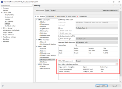

Thanks, I found 2 problems,
1. When I debug the usb example, it can run normally, but when I burn the code into norflash, it cannot be started, and the usb is abnormal.
2. When I change the memory position in mcuxpressIDE, the usb cannot run normally. I put the SRAM_DTC_CM7 at the back and SRAM OC1 and OC2 at the front, and the usb cannot run normally. What is the reason?

Hui_Ma
Please place USB stack used data into non-cacheable region.
Wish it helps.

eao
I found a question, can usb run only on SRAM_DTC_CM7? I just put the code other areas will not run, for example, to SRAM_OC will not run
9,103 Views
Wish it helps.
9,090 Views
eao
Thank you very much, this answer solves my problem.
