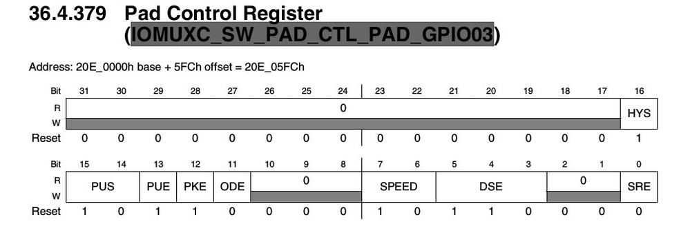

We are working on imx6q processor board and want to understand iopin muxing in detail. for this we have refereed to imx6q-pinfun.h file
for example: it states:
#define MX6QDL_PAD_CSI0_MCLK__IPU1_CSI0_HSYNC   0x25c 0x62c 0x000 0x0 0x0
#define MX6QDL_PAD_CSI0_MCLK__CCM_CLKO1         0x25c 0x62c 0x000 0x3 0x0
#define MX6QDL_PAD_CSI0_MCLK__GPIO5_IO19        0x25c 0x62c 0x000 0x5 0x0
#define MX6QDL_PAD_CSI0_MCLK__ARM_TRACE_CTL     0x25c 0x62c 0x000 0x7 0x0
where it staed that  the pin function ID is a tuple of
<mux_reg      conf_reg      input_reg      mux_mode       input_val>
if i take one example from above let's say :
if i look the reference manual, then mux-reg for CSI0_MCLK is IOMUXC_SW_MUX_CTL_PAD_CSI0_HSYNC (Address: 20E_0000h base + 25Ch offset = 20E_025Ch) offset is 0x25c
conf_reg for CSI0_MCLK is IOMUXC_SW_PAD_CTL_PAD_CSI0_HSYNC (Address: 20E_0000h base + 62Ch offset = 20E_062Ch), so offset is 0x62c
MUX-Mode i need select from IOMUXC_SW_MUX_CTL_PAD_CSI0_HSYNC whose value 011 (0x3)
So
in above macro i got 0x25c 0x62c 0x3 but what about values of  input_reg (0x000) and input_val (0x0) ??????? how to get them correctly?????

I would like understand briefly how to get the values for io pin muxing like
For ex:
I take taken dts file of some reference design where they are using :
MX6QDL_PAD_GPIO_3__CCM_CLKO2   0x000b0
from the above ,
HYS=0  CMOS input, How we will come to know whether we require CMOS input or schmitt trigger input (or by trial error method)
PUS=00       100K Ohm pull-down  (how to get this value from schematic, whether we require Pull up or pulldown and choose between 100 K PU, 100 K PD, 22K PU, 47K PU ????)
PUE = 0 (how choose between keeper and puller)
PKE= 0  (pull /keeper enable  disable. how choose ????)
Speed =(how to choose the correct speed required?????
DSE (Drive Strength how to choose correct values????)
whether they have arrived at 0x000b0 by trial and error method or how to derive it exactly ????

igorpadykov
Hi Srinivasa
input_reg and input_val are address offsets for daisy chain register (IOMUXC_xxx_SELECT_INPUT)
and its value (if it presents for that signal). Regarding SW_PAD_CTL_PAD value you should check
description in RM and choose appropriate for your needs value.
