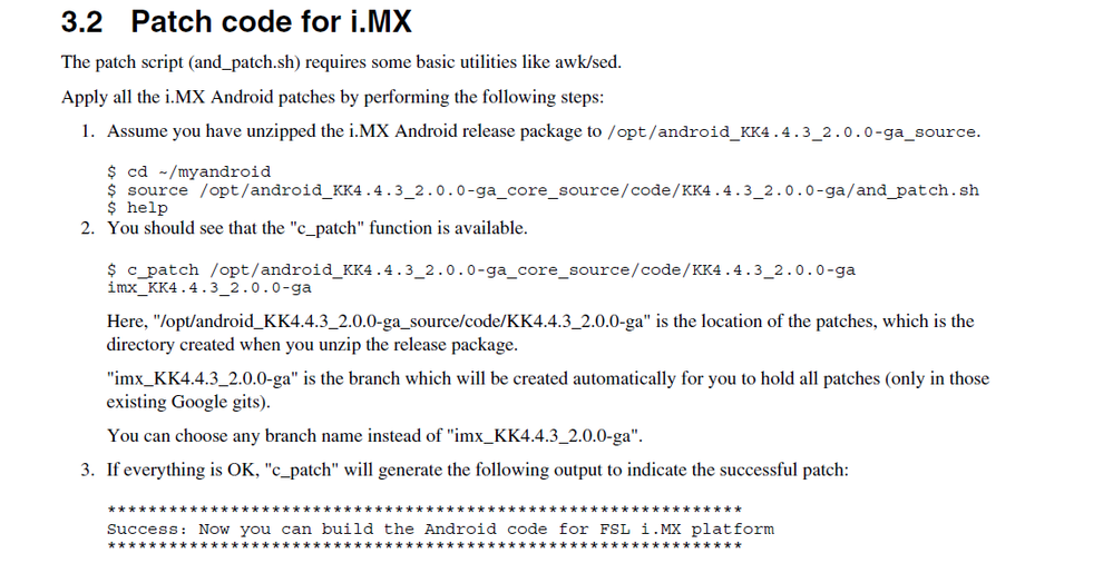

What i suggest that please build default android source code as per mention in "Android_user_guild.pdf".
Once that build complete you can modify according to your requirement.

I suggest that you follow the Android_User's_Guide.pdf.
