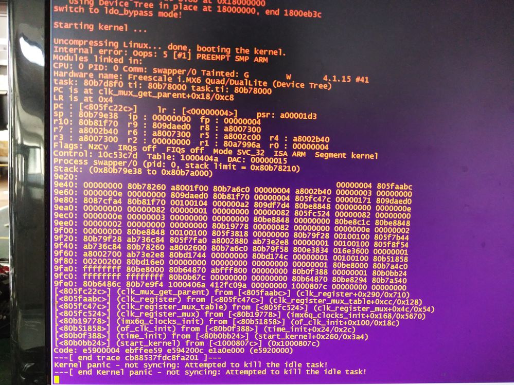

uboot201603 boot zImage(4.1.15) hangs on Uncompressing Linux... done, booting the kernel.it's print error message occasionally,seems it's crashed at clk_mux_get_parent().I‘ll paste log later
zImage boots okay with uboot201404
my board file config

igorpadykov
had you tried ddr test for board
https://community.freescale.com/docs/DOC-105652
and rebuilt uboot with new calibration coefficients in
uboot../board_name/*.cfg file.
igor
