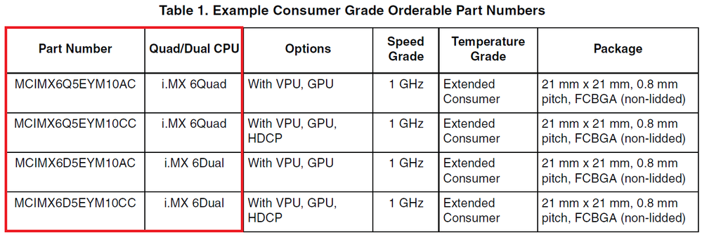

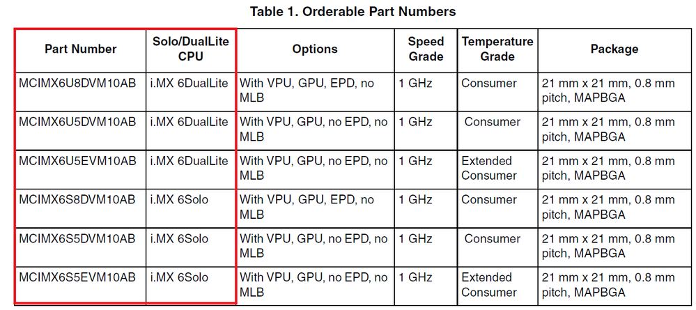

weidong_sun
Hello,venkatesh,
      The simple way is to check partnumber on top side of CPU, the following is just an example.
you can check partnumber and compare it with that of in datasheet.
(1)i.MX6DL & i.MX6S
(2)i.MX6DQ(D: 2-CORE; Q: 4-CORE),following is for consumer

6,704件の閲覧回数
venkatesh_raika
Thanks Weidong,
The problem is i cant see the top side of CPU as it is covered with the heat sink.
Any other way i can get  the info by looking on to the board ?
