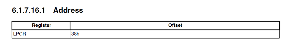

xrztech_wen
 HI,Mike Susen,
     Thanks,I had seen the page 956, and found the LPCR Address:
     but, I want to know the SNVS base Address,like "MX6Q_SNVS_BASE_ADDR",I want to add one define like this:
          #define MX7D_SNVS_BASE_ADDR  0xXXXX
    Then,I can use this address to poweroff,so can you tell me where to find this address?
    Thanks very much!
6,284 Views
mike_susen
Here you have complete definition tree
#define AIPS1_ARB_BASE_ADDR          0x02000000
#define ATZ1_BASE_ADDR               AIPS1_ARB_BASE_ADDR
#define AIPS1_OFF_BASE_ADDR          (ATZ1_BASE_ADDR + 0x80000)
#define MX6Q_SNVS_BASE_ADDR          (AIPS1_OFF_BASE_ADDR + 0x4C000)
Michal
