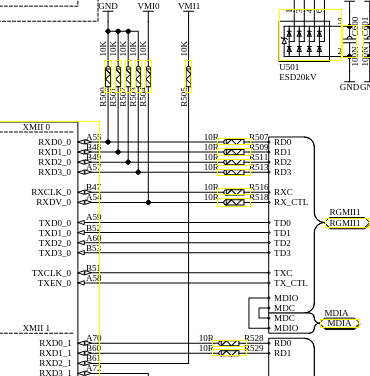

883 Views
joanxie
how did you connect qca8337 with your imx91 on HW? pls share the HW connection, let me double check it

DavidFlir
The first important measurement was on the MDIO line where the configuration steps take place of the Phy.  There was no data and a terrible clock signal.
We did not have a pull-up resistor on MDIO, adding a 1k5 resistor initiated the communication.
Now I see some terrible communication... which fails every 2nd try.

So the data 0x7949 is correct, but only every 2nd read... So there is still something wrong there. The data should be always readable without a retry!
834 Views

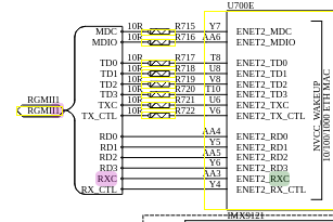

DavidFlir
Attached you can see the qca8337 and the imx91 connecting part...  No idea if this would give you any additional insight.
What I can add is that I measured the `RX_CLK0` on the qca8337 chip and there is not coming anything in... so communication is impossible. On the other hand the clock for the qca is 25Mhz oscillator and is ok (As well as the Reset signal is not pulled low and measures ok).
