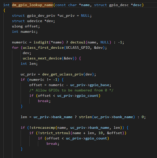

For an imx91 based project I am stuck with defining my first GPIO as output.
I have read several posts where examples towards the device trees are explained but I am still getting the `-22` return value.
Defined in device tree:
	gpio_reset: gpio-reset {
		compatible = "gpio-reset";
		pinctrl-names = "default";
		reset-gpios = <&gpio1 8 GPIO_ACTIVE_LOW>;
		status = "okay";
		label = "RSTO";
		gpio-name = "RSTO";
		line-name = "RSTO";
Here I tried adding label,gpio-name and line-name. Not sure which one is needed.
Then in function
static void board_gpio_init(void){
	struct gpio_desc desc;
	int ret;
	/* De-assert RSTO */
	ret = dm_gpio_lookup_name("RSTO", &desc);
	if (ret) {
		printf("%s lookup 'RSTO' failed ret = %d\n", __func__, ret);
		return;
This always returns -22 and it's the first pin to look up.
Then I thought let's try a proven example code based on leds,
	gpio-leds {
		compatible = "gpio-leds";
		pinctrl-0 = <&pinctrl_gpio_led>;
		led-0 {
			gpios = <&gpio3 26 GPIO_ACTIVE_HIGH>;
			default-state = "on";
		led-1 {
			gpios = <&gpio3 27 GPIO_ACTIVE_HIGH>;
Then
	ret = dm_gpio_lookup_name("led-1", &desc);
also returns -22

I did find a missing _defconfig setting called
CONFIG_IMX_RGPIO2P=y
with this setting I am able to do a succesful
ret = dm_gpio_lookup_name("gpio1_8", &desc);
But I still did not figure out how I can use the names defined in the .dts file instead of this gpio1_8.

The dm_gpio_lookup_name() function does not parse gpio-name, or line-name from the device tree. It only understands the format "gpioX_Y" where
X is the GPIO controller
Y is the pin number.

Ok so finding out which ports are actual available just requires a print like,
		len = uc_priv->bank_name ? strlen(uc_priv->bank_name) : 0;
		printf("%s: lookup %s\n", __func__,uc_priv->bank_name);
		if (!strncasecmp(name, uc_priv->bank_name, len)) {
And then I get to see the available&correct names on my console!
file location is `uboot/drivers/gpio/gpio-uclass.c`
