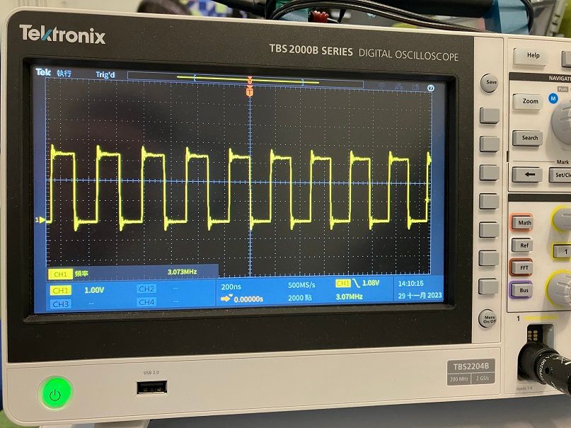

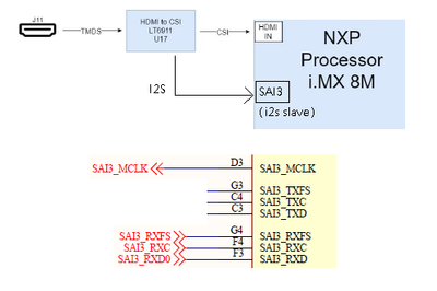

we use a hdmi-csi convertor LT6911.
LT6911 play I2S master. we connect to SAI3 of i.mx8mq.
hdmi plug to pc and playing youtube.

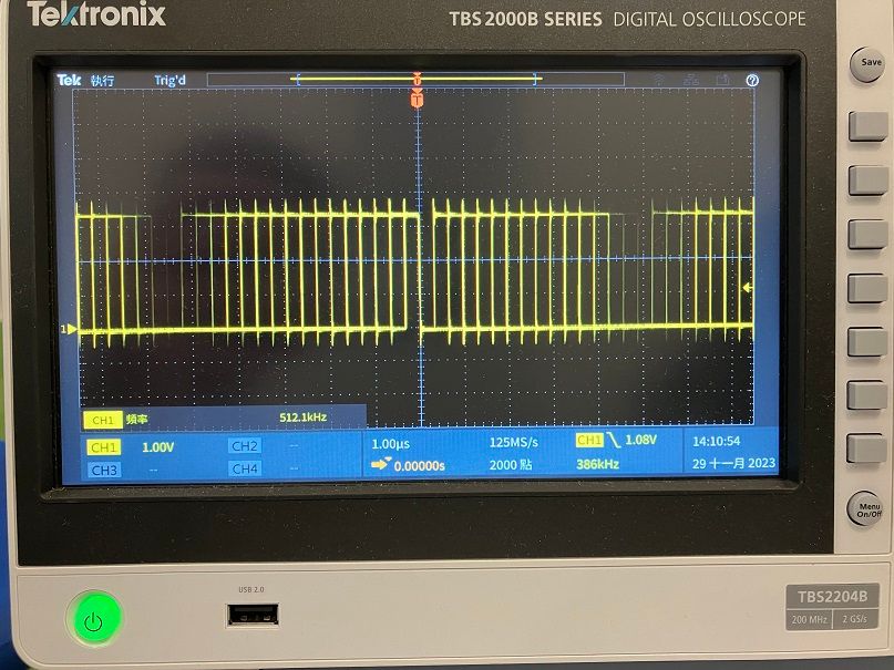

we can measure I2S signal. ( RXD0 , RXC, RXFS ) .
LT6911 have external osc, so the MCLK is not connect.
RXC = 48kHz (RXFS) x 32 x2 = 3.072MHz
RXD0RXD0RXCRXCRXFSRXFS
