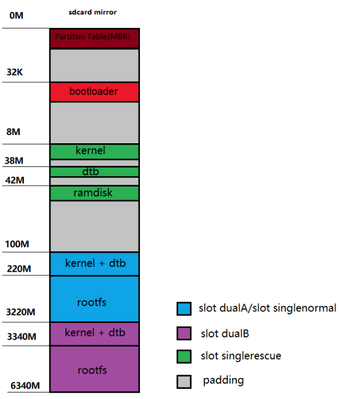

Hi team,
I'm following  swupdate-scripts in AN13872 Enabling SWUpdate on i.MX 6ULL and https://community.nxp.com/t5/i-MX-Processors-Knowledge-Base/SWUpdate-OTA-i-MX8MM-EVK-i-MX8QXP-MEK/ta...
It mentioned the ramdisk of partition table need to fill into 42M:100M
But after Yocto build, my swupdate-image-imx8mm-XXXX.rootfs.cpio.gz.u-boot include some package and tools and the size up to 120M, so I shift the table in cfg_imx8mm_base.cfg.
And then the device cannot work.
Here is my question :
  1. Can I shift the table ?
  2. Is the boot start address is a hardcore address (100M) ?
    I can not find the configuration or wks.in file descript it.
  3.  Slot A and slot B can flexibly define larger sizes to prevent upgrades to new files from exceeding space ?

Please also modify here and other PT table address referring your image layout.
Your image layout like this:
250:370
370:3370
3370:3490
3490:6490
Zhiming

Did you use -m to regenerate the MBR?
2,692 Views
DennisTseng
$ ./assemble_base_image.sh -d -m -b imx8mm
No output image name specified! Use default name!
Output image name is: swu_doublecopy_rescue_imx8mm_sd_20250415.sdcard
Delete existing swu_doublecopy_rescue_imx8mm_sd_20250415.sdcard...DONE
>>>> Check partition table file...>>>> Regenerate or overwrite partition table...

yes, but no effect
2,666 Views
Zhiming_Liu
I did a quick test on i.MX93(emmc), just modify the image layout, can work.
diff --git a/boards/cfg_imx93_base.cfg b/boards/cfg_imx93_base.cfg
index 07f5891..422f4c4 100644
--- a/boards/cfg_imx93_base.cfg
+++ b/boards/cfg_imx93_base.cfg
@@ -21,10 +21,10 @@ IMAGE_PT_TBL_LENGTH=512
 # Numbers and fs type in this struct will be passed to command directly.
 # sudo parted <PARTITION_NAME> unit MiB mkpart primary <Filesystem Type> <OFFSET_START> <OFFSET_END>
 IMAGE_PT_TABLE_STRUCT="
-1:SLOTA_BOOT_PT:120:240:fat32
-2:SLOTA_ROOTFS:240:3240:ext4
-3:SLOTB_BOOT_PT:3240:3360:fat32
-4:SLOTB_ROOTFS:3360:6360:ext4
+1:SLOTA_BOOT_PT:150:300:fat32
+2:SLOTA_ROOTFS:300:3300:ext4
+3:SLOTB_BOOT_PT:3300:3450:fat32
+4:SLOTB_ROOTFS:3450:6450:ext4
 # Header of a image.
@@ -32,7 +32,7 @@ IMAGE_PT_TABLE_STRUCT="
 # Format: [FILEPATH:<OFFSET_START>:<OFFSET_END>]
 IMAGES_HEADER="
 ${IMAGE_PT_TBL_PATH}:0:32K
-${WRK_DIR}/slota/imx-boot-imx93evk-sd.bin-flash_singleboot:32K:8M
+${WRK_DIR}/slota/imx-boot-imx93-11x11-lpddr4x-evk-sd.bin-flash_singleboot:32K:8M
 # SWUpdate image.
@@ -41,7 +41,7 @@ ${WRK_DIR}/slota/imx-boot-imx93evk-sd.bin-flash_singleboot:32K:8M
 IMAGES_SWUPDATE="
 ${WRK_DIR}/slota/Image:8M:50M
 ${WRK_DIR}/slota/imx93-11x11-evk.dtb:50M:54M
 ${SLOTA_ROOTFS}
@@ -67,8 +67,8 @@ ${WRK_DIR}/slotb/Image
 # SLOTB images
 # Contains boot partition and rootfs.
-SLOTB_BOOT_PT="${WRK_DIR}/common/slotb_boot_pt_120M.mirror:3220M:3340M"
-SLOTB_ROOTFS="${WRK_DIR}/slotb/core-image-base-imx93evk.ext4:3340M:6340M"
+SLOTB_BOOT_PT="${WRK_DIR}/common/slotb_boot_pt_150M.mirror:3300M:3450M"
+SLOTB_ROOTFS="${WRK_DIR}/slotb/core-image-base-imx93-11x11-lpddr4x-evk.ext4:3450M:6450M"
 SLOTB_IMAGES="
 ${SLOTB_BOOT_PT}
 ${SLOTB_ROOTFS}
Zhiming
