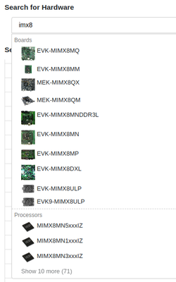

Ahelion
Thank you.
Quick question:
Background: I downloaded the binary for mcuexpresso for linux and installed it, in the sdk download window it does not have the imx8, so I had to use the SDK builder, and it gave me a .zip package with some files, what is this zip file for?

JorgeCas
I.MX8MP is not supported on MCUXpresso IDE, you need to compile the code using GCC or IAR.
Once you downloaded the SDK from MCUXpresso SDK builder, you need to compile it using IAR or GCC to generate the files that needs to be uploaded to the board.
One alternative that could be helpful is MCUXpresso for VS Code that supports SDKs for i.MX.
