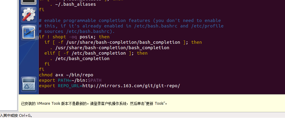

I do it as up following,but always fault,
i wander why.

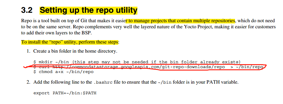

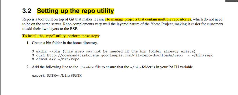

Please try the following steps:
1. Save the attachment in ~/bin
2. $ chmod a+x ~/bin/repo
3. Add the following line to the ~/.bashrc file
   export PATH=~/bin:$PATH
4.$ source ~/.bashrc
12,981 Views

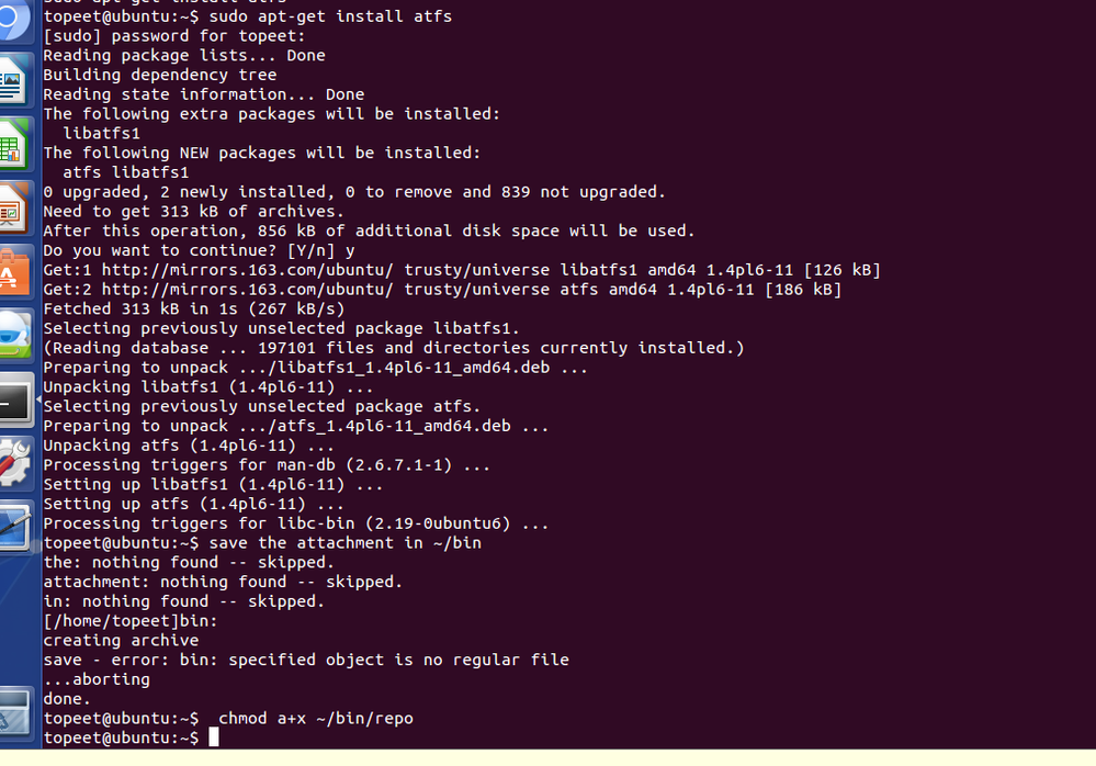

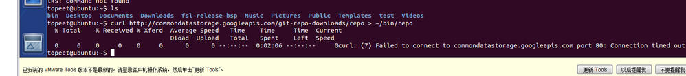

zhangbaobing
Executeing this instruction which is fault
so the back instructon still fault.

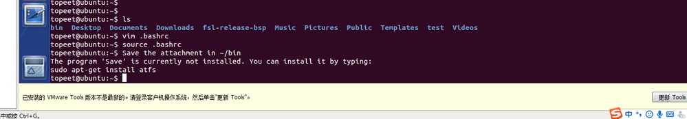

iris_wen
Do you really follow the steps I provided?
The first step is to save the attachment in ~/bin. Then the repo is already in your computer. You don't need to download again.
Remember to unzip the attachment...ONLY copy the file repo in ~/bin...

zhangbaobing
first ,what is attachment?
12,976 Views
zhangbaobing
where is the attachment?
and can you give me specfications ?

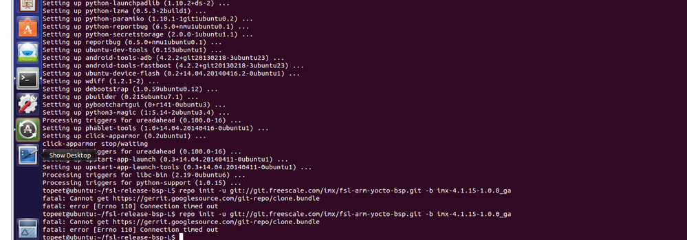

joanxie
maybe you can refer to the link as below, get the repo from tsinghua
"https://mirrors.tuna.tsinghua.edu.cn/help/git-rep"
I suggest that you can update to the latest version, some packages in the git.freescale.com are removed, if you build the 3.14.28, maybe you will get the connection error even if you can repo sync successfully, I have built 4.14.52 successfully before, but I don't know if you can get 3.14.28 source package or not

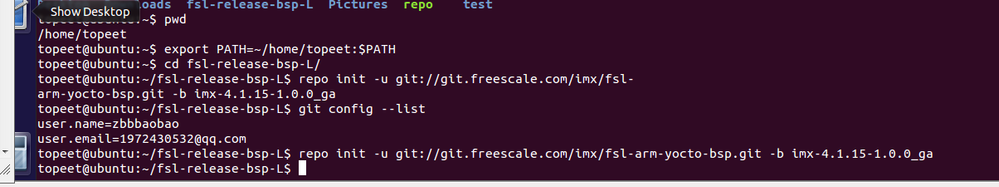

zhangbaobing
i download L4.1.15 still fault

joanxie
as I mentioned before, the source code was removed from git.freescale.com, maybe you can refer to my another document
https://community.nxp.com/docs/DOC-346089

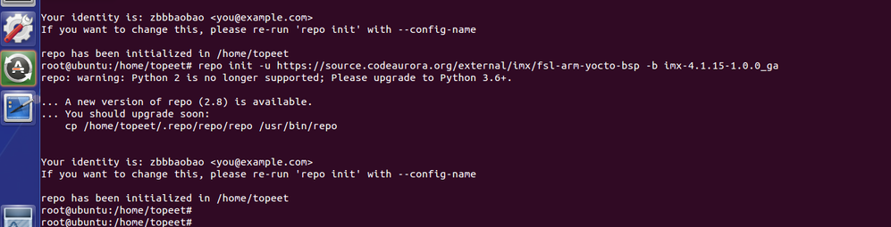

joanxie
do you mind reading my document again? as I mentioned,  you couldn't use git.freescale.com, try to use the new command as my document mentions

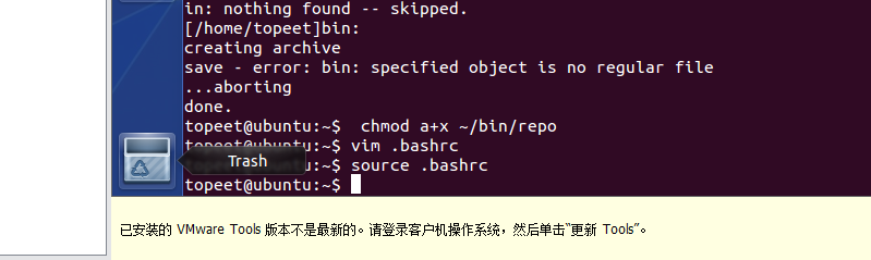

zhangbaobing
pastedImage_1.pngstill fault
12,976 Views
joanxie
I don't find any error according to the pic you attached
12,981 Views
iris_wen
Hi Baobing,
Did you reboot or source the .bashrc file by the following command?
$ source ~/.bashrc

zhangbaobing
hi ,that is still false
12,981 Views
iris_wen
Could you please share the log?
