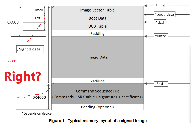

Hi, NXP engineers
     i make secure boot in i.mx6ull refer to https://www.nxp.com/docs/en/application-note/AN4581.pdf . i miss understand the 3 params  "877ff400 0x000 0x48000"  in below section, which is in chapter “3.5. Create the CSF descriptionfile
[AuthenticateData]
# Key slot index used to authenticatethe image data
Verification index = 2
# Address Offset Length  DataFilePath
Blocks = 877fb000 0x000 0x48000 “/<path_to_u-boot_dir>/u-boot-dtb.imx"
## param 1: The first value is the address on the target where HAB expects the signed image data to begin.
## param 2: The second value is the offset into the file where CST will begin signing. (always offset 0 ???)
## param 3: The third value is length in bytes of the data to sign starting from the offset. (should it be the size of u-boot.imx ???)
While I compile the u-boot source, i get:
 ./tools/mkimage -n board/freescale/mx6ullevk/imximage.cfg.cfgtmp -T imximage -e 0x87800000 -d u-boot.bin u-boot.imx
Image Type:   Freescale IMX Boot Image
Image Ver:    2 (i.MX53/6/7 compatible)
Mode:         DCD
Data Size:    442368 Bytes = 432.00 kB = 0.42 MB
Load Address: 877ff420
Entry Point:  87800000
HAB Blocks:   877ff400 00000000 00067c00
What should i replace those 3 params "Blocks = 877fb000 0x000 0x48000" with in CSF according to my u-boot.imx?

  use IVT header information:
the first parameter (Address) of [AuthenticateData] section is IVT address, ivt.self field of the header;
the second (Offset) - usually is zero;
the third (Length): is  ivt.csf – ivt.self from the IVT.

changbaoma
Hi,Yuri
   Thinks for your Reply.
   is it what you mean,see the follow picture:
   As you know the u-boot.imx has padded IVT&BootData&DCD-Table by default.
Now i have 3 quetion?
  1. How can i get the ivt.self and ivt.csf address in i.mx6ull ?
  2. Should i need to align u-boot.imx size to 0x1000?  00067c00 padded to 00068000, as you see there is a Padding after Image Data in the picture above.
  3. Should “Blocks = ”  3params of [Authenticate Data]  section  in Command Sequence File be equal to u-boot build.log "HAB Blocks: 877ff400 00000000 00067c00"  mention above?

  An example  below show how to get the IVT structure from u-boot.imx and do the signature.
 Dump u-boot.imx IVT structure:
    $ od -x -N 64 u-boot.imx
    0000000 00d1 4020 0000 1780 0000 0000 f42c 177f
    0000020 f420 177f f400 177f a000 1785 0000 0000
    0000040 f000 177f d000 0005 0000 0000 02d2 40f8
    0000060 02cc 04f4 0e02 9807 0c00 0000 0e02 5807
    0000100
    U-boot.imx header layout is
0ivt_header_t header
4uint32_t entry
8uint32_t reserved1
12uint32_t dcd_ptr
16uint32_t boot_data_ptr
20uint32_t self
24uint32_t csf
28uint32_t reserved2
32uint32_t start
36uint32_t size
40uint32_t plugin
    IVT address:  IVT.self = 0x177ff400.
    Image length: IVT.csf – IVT.self = 0x1785a000 - 0x177ff400 = 0x5AC00
    u-boot.imx need to be padded to 0x5AC00.
    So the [Authenticate Data] of csf file is
    Blocks = 0x177FF400 0x0 0x5AC00 "u-boot-pad.bin"
Yuri.
