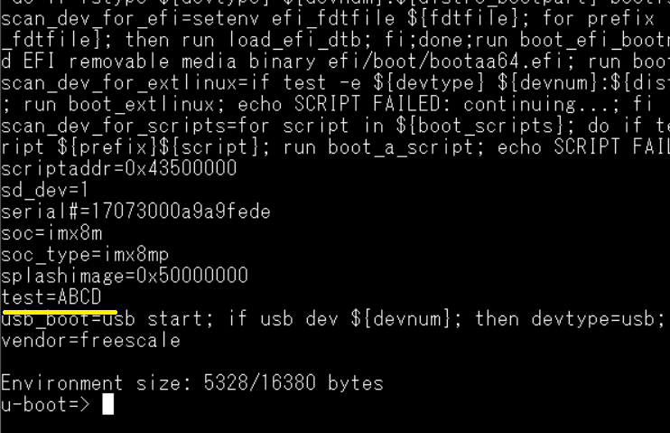

BiyongSUN
I had provided the command two years ago.
Today, I have to give a demo.
Using uuu to send uboot command is exactly the same as you using uart to type uboot command to saveenv.
But you need to make sure the configuration. Because there are default settings. Or you may lose some settings.
Once you get error, please check such as emmc dev is correct or not.
HW: i.MX8MM EVK
SW: LF_v5.15.71-2.2.0_images_IMX8MMEVK
uuu_setenv.uuu(uuu_setenv.zip attached):
uuu_version 1.2.39
# This command will be run when i.MX6/7 i.MX8MM, i.MX8MQ
SDP: boot -f imx-boot-imx8mmevk-sd.bin-flash_evk
# This command will be run when ROM support stream mode
# i.MX8QXP, i.MX8QM
SDPS: boot -f imx-boot-imx8mmevk-sd.bin-flash_evk
# These commands will be run when use SPL and will be skipped if no spl
# SDPU will be deprecated. please use SDPV instead of SDPU
SDPU: delay 1000
SDPU: write -f imx-boot-imx8mmevk-sd.bin-flash_evk -offset 0x57c00
SDPU: jump
# if (SPL support SDPV)
SDPV: delay 1000
SDPV: write -f imx-boot-imx8mmevk-sd.bin-flash_evk -skipspl
SDPV: jump
FB: ucmd setenv mmcdev ${emmc_dev}
FB: ucmd setenv ABC test
FB: ucmd saveenv
FB: ucmd setenv mmcdev 1
FB: ucmd saveenv
FB: done
Log:
uuu log
dev 2 is emmc and dev 1 is sdcard/tf card.
The script saves the env to the emmc first. Then it switches to the sdcard and save again.
boot and check

The idea is to use fw_setenv to set the sdcard mirror as the operation on a real emmc/sdcard.
Here is the demo.
I add test=ABCD for test purpose.
And use fw_printenv to check and use hexdump to double confirm it.
The uboot env is already written into sdcard mirror(imx-image-multimedia-imx8mpevk.wic).
Those operations are on the host x86/x64 PC.

Then,
I flash the sdcard mirror into i.MX8MP evk  board  emmc to check
uuu -b emmc_all imx-boot-imx8mp-lpddr4-evk-sd.bin-flash_evk  imx-image-multimedia-imx8mpevk.wic
The first time boot, the env is already there.

Now, you can run
./fw_setenv -c fw_env.config -f u-boot-initial-env

gnulux
Hi BiyongSUN
It works fine. Many thanks
Indeed I will use this method for mass production instead of setenv from UUU.
