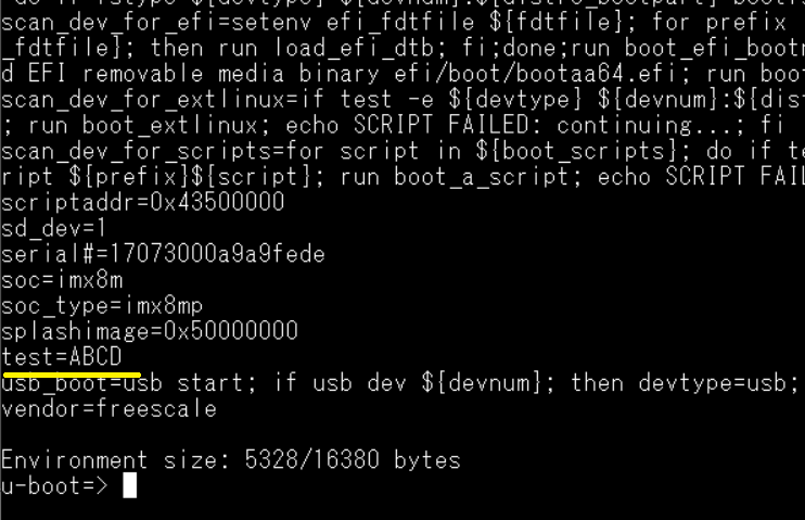

BiyongSUN
What you can do with uboot command through uart, you can do the exactly the same through uuu.
The difference I had told two years ago.
The u-boot has mmcautodetect, it can  detect boot from  the emmc(for example) and make the u-boot environment save to that device regardless the u-boot environment.
But boot from usb, uboot will think it is not from emmc or sd or any usdhc interface.
When you use "uuu -v FB: ucmd env default -a", the mmcdev will become 1.
That is why you saveenv will get fail.
uuu -b spl imx-boot-imx8mm-lpddr4-evk-sd.bin-flash_evk
uuu -v FB: ucmd print mmcdev
uuu -v FB: ucmd saveenv
uuu -v FB: ucmd print emmc_dev
uuu -v FB: ucmd setenv mmcdev ${emmc_dev}
## Checking Image at 43800000 ...
Unknown image format!
Run fastboot ...
## Resetting to default environment
Detect USB boot. Will enter fastboot mode!
mmcdev=1
Saving Environment to MMC... MMC: no card present
No block device
Failed (1) fastboot mode!
Saving Environment to MMC... Writing to MMC(2)... OK

BiyongSUN
It is very simple reason.
so the mmcdev=1, not match the hardware.
even you don't issue the command uuu -v FB: ucmd env default -a. you could not saveenv, either.
You have to manually set the mmc device.
By the way, uuu flash use the emmc_dev and sd_dev to do flash.
21,026 次查看
BiyongSUN
I had provided the command two years ago.
Today, I have to give a demo.
Using uuu to send uboot command is exactly the same as you using uart to type uboot command to saveenv.
But you need to make sure the configuration. Because there are default settings. Or you may lose some settings.
Once you get error, please check such as emmc dev is correct or not.
HW: i.MX8MM EVK
SW: LF_v5.15.71-2.2.0_images_IMX8MMEVK
uuu_setenv.uuu(uuu_setenv.zip attached):
uuu_version 1.2.39
# This command will be run when i.MX6/7 i.MX8MM, i.MX8MQ
SDP: boot -f imx-boot-imx8mmevk-sd.bin-flash_evk
# This command will be run when ROM support stream mode
# i.MX8QXP, i.MX8QM
SDPS: boot -f imx-boot-imx8mmevk-sd.bin-flash_evk
# These commands will be run when use SPL and will be skipped if no spl
# SDPU will be deprecated. please use SDPV instead of SDPU
SDPU: delay 1000
SDPU: write -f imx-boot-imx8mmevk-sd.bin-flash_evk -offset 0x57c00
SDPU: jump
# if (SPL support SDPV)
SDPV: delay 1000
SDPV: write -f imx-boot-imx8mmevk-sd.bin-flash_evk -skipspl
SDPV: jump
FB: ucmd setenv ABC test
FB: ucmd saveenv
FB: ucmd setenv mmcdev 1
FB: ucmd saveenv
FB: done
Log:
uuu log
dev 2 is emmc and dev 1 is sdcard/tf card.
The script saves the env to the emmc first. Then it switches to the sdcard and save again.
boot and check

Then,
I flash the sdcard mirror into i.MX8MP evk  board  emmc to check
uuu -b emmc_all imx-boot-imx8mp-lpddr4-evk-sd.bin-flash_evk  imx-image-multimedia-imx8mpevk.wic
The first time boot, the env is already there.
How to:
a. fw_setenv/fw_printenv:
    https://github.com/sbabic/libubootenv.git
     Note: Please do not use uboot fw_setenv/fw_printenv
              Compile it on the host x86/x64 PC. It is used on host.
b. u-boot-initial-env
    Under uboot, make u-boot-initial-env
    Note: Yocto deploys u-boot-initial-env by default
c. fw_env.config
imx-image-multimedia-imx8mpevk.wic 0x400000 0x4000
  0x400000 0x4000  are from uboot-imx\configs\imx8mp_evk_defconfig
CONFIG_ENV_SIZE=0x4000
CONFIG_ENV_OFFSET=0x400000
Now, you can run
./fw_setenv -c fw_env.config -f u-boot-initial-env
20,931 次查看

Hi BiyongSUN
It works fine. Many thanks
Indeed I will use this method for mass production instead of setenv from UUU.
