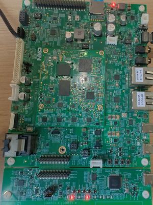

gongyaxuan
The boards we built based on 93x will reboot after poweroff, I found the issue in the forums. Here is the log and the link
root@imx93evk:~# poweroff

Board dip and led light as shown below, could you please help me see why SD card startup without any printing? I read the data you sent only described the sw1301 dip Settings, but I carefully checked the dip is no problem
10,094 Views

Chavira
Hi @gongyaxuan!
Thank you for contacting NXP Support!
Is not a normal behavior.
Please try to download our precompiled image and reflash your board.
I attached a picture with a Switch configuration to boot from an SD card
Best Regards!
