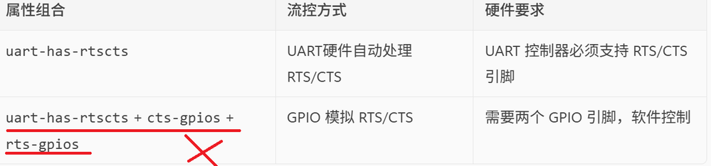

Two questions:
1. are propertys assigned-clocks & assigned-clock-parents  necessary?  What would happen if it's lacking?
2. What are the differences between the two hardware flow control methods uart-has-rtscts and uart-has-rtscts &cts-gpios&rts-gpios?

2,693件の閲覧回数
kawateb265
@Rita_Wang
There's a very serious mistake in your answer.
https://github.com/nxp-imx/linux-imx/blob/lf-6.12.y/Documentation/devicetree/bindings/serial/serial....
if:
  required:
    - uart-has-rtscts
then:
  properties:
    cts-gpios: false
    rts-gpios: false
cts-gpios:
maxItems: 1
description:
Must contain a GPIO specifier, referring to the GPIO pin to be used as
the UART's CTS line.
 rts-gpios:
    maxItems: 1
    description:
      the UART's RTS line.
 uart-has-rtscts:
    $ref: /schemas/types.yaml#/definitions/flag
    description:
      The presence of this property indicates that the UART has dedicated lines
      for RTS/CTS hardware flow control, and that they are available for use
      (wired and enabled by pinmux configuration).  This depends on both the
      UART hardware and the board wiring.
if:
  required:
    - uart-has-rtscts
then:
  properties:
    cts-gpios: false
    rts-gpios: false

kawateb265
@Rita_Wang
We came here because we trust the professional expertise of NXP engineers.
We came here because we are seeking professional support.
The trust in NXP led to @machangbao  marking an incorrect answer as the solution.
It’s obvious at a glance from your table that it was generated by AI. We are not here to get AI-rephrased answers.
If NXP engineers are also just asking AI, then why wouldn’t we just ask AI directly?
