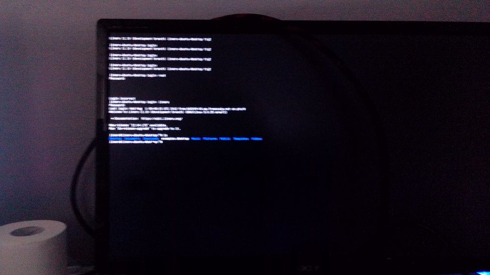

According to i.MX_6Dual6Quad_SABRE-SD_Linux_User's_Guide.pdf, I use oneiric as filesystem on my customer board.I use HDMI as displayer,system can boot well,but can not login in.
The following is my bootargs:
video=mxcfb0:dev=hdmi,1920x1080M@60,if=RGB24  root=/dev/mmcblk0p1 rootwait rw
After system boot,only part of the login UI is displayed,as my attachment login.jpg. In login  box,I can type linaro,and the enter,after a while,the display goes to all black and back to login.jpg soon.
I think HDMI driver is OK,when I enter CTRL+ALT+F1,the command line intercface is well as show in cmd.jpg.
Who can tell me what to do next?

thouswave
sorry,I forget the cmd.jpg,show as following.

thouswave
I am sorry the problem is not DDR, but the command line. I have worked it out, the correct command line is as following:
console=ttymxc1,115200 mem=2048M video=mxcfb1:dev=ldb,LDB-XGA,if=RGB24 video=mxcfb0:dev=hdmi,1920x1080M@60,if=RGB24 root=/dev/mmcblk0p2 rootwait rw ldo_active=on;bootm
Then ubuntu system can work well, but I really don't know why "video=mxcfb1:dev=ldb,LDB-XGA,if=RGB24" should be added. As I known,dev=ldb indicates that target display is LVDS. Now, I just use HDMI, but in the future, on our real product, LVDS is the main displayer. So, how to set the command line if the target display is LVDS?
