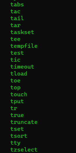

dpcivl
I'm also watching this paper..
But in my Yocto environment, no tflite is in /usr/bin.
That's why I posted this topic.
I'm doing `bitbake imx-image-full` one again, but I'm not sure that it'll work.
