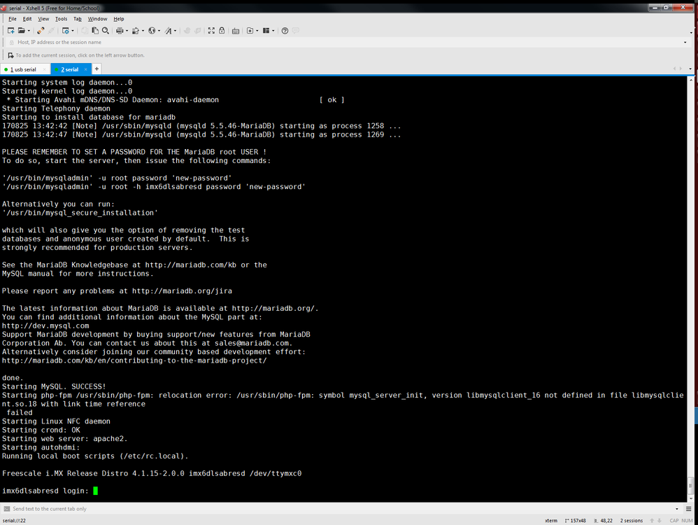

I have recently upgraded to:
git://git.freescale.com/imx/fsl-arm-yocto-bsp.git –b imx-4.1-krogoth
added my layer to the build.
my layer included a sthttpd web server and php (php-cli php-cgi php-dbg php-dev php-fpm php-pear php-phar)
all builds fine, when the image is ran I get the error:
Starting php-fpm /usr/sbin/php-fpm: relocation error: /usr/sbin/php-fpm: symbol mysql_server_init, version libmysqlclient_16 not defined in file libmysqlclient.so.18 with link time reference.
from my investigations there are several possible causes of this, each one needing an upgrade of a component with in the layers, adding them manually just brakes the build.
is this a issue you are aware of ?
have you found a solution ?

I got same problem as you can see as attached file. And when i tried solution by Stuart, I got compile error with qtwebgine_git.bb. Would you recommend any solution for me?

thanks very much for the reply, sorry but I had completely forgotten about this as I had found the solution to the issue.the solution can be found here,http://lists.openembedded.org/pipermail/openembedded-core/2016-September/126123.html
essentially this is a problem with binutils and this link has a new version to resolve this problem.
