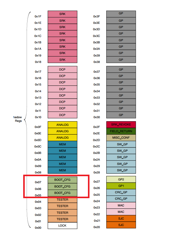

want to boot i.MX6SoloLite Custom Board From eMMC Interface, for that I need to configure the boot device selection.(BT_FUSE_SEL or eFUSE)
How can Configure the BT_FUSE_SEL value or eFUSE value. ?

Hi changyong
please check
Q&A: How to program i.MX6 eFUSE?
https://community.freescale.com/docs/DOC-95458
~igor

please check sect.8.5.2.1 Expansion Device eFUSE Configuration
IMX6SLRM  i.MX 6SoloLite Applications Processor Reference Manual
and Chapter 7 Avoiding Board Bring-up Problems
IMX6SLHDG Hardware Development Guide for i.MX 6SoloLite - User Guide
igor

Hi. igorpadykov.
I want to know to write eFUSE on iMX6SL(BOOT_CFG)

Hi changyong
please check
~igor
