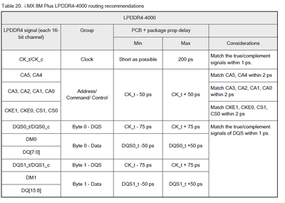

thank you very much for the detailed information. You helped me a lot to understand ddr-ram calibration. There is only one last point I would like to ask you. Is there a skew calibration for each Databit in a DQS-Group? The reason for me question is that I worder if the length match of each DQ line within a DQS-Grupe must be very precise (e.g. 2ps), or if some length differences (e.g. 50ps) are compensated by calibration.

Hi @michaelschuhmac,
I hope you are doing well.
Please accept my apologies for the delayed response.
Yes, Each DQ line is individually calibrated to compensate for the skew for both the read and write scenarios. In the Hardware Developer's Guide, for the PCB design, we allow a max skew of +/- 50 ps wrt to DQS for the DQ signals:
