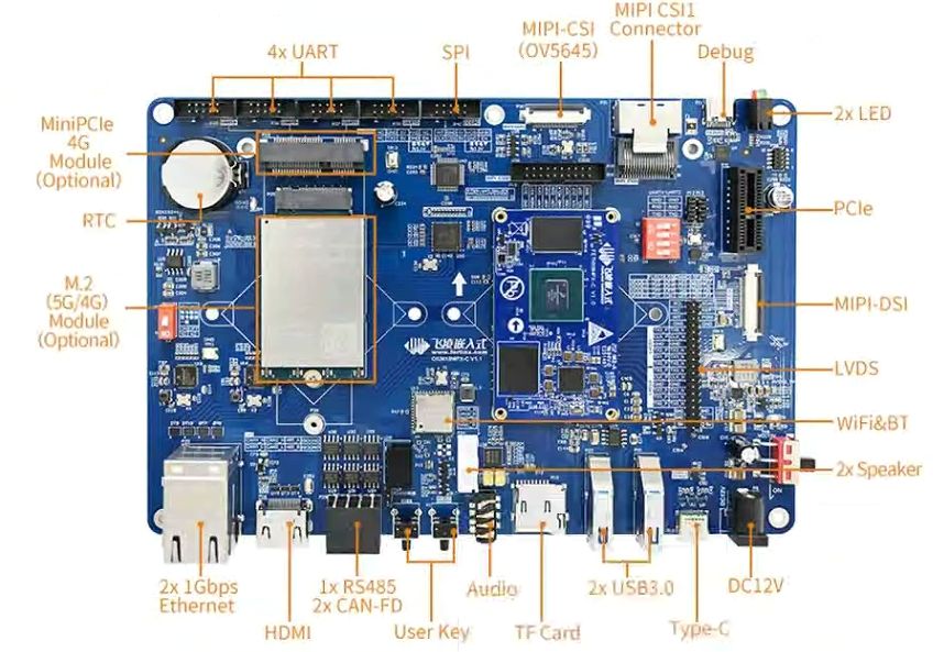

Is this feature supported by the current development board? If so, are there any related documents available? Thank you.

Hello, thank you for your response:
My PCIe interface is not connected to any device. The operating system version is Ubuntu 18.04.64, and the kernel version of the development board is Linux 5.4.7.0.
Linux OK8MP 5.4.70-2.3.0-00005-g33a263b968fb #1 SMP PREEMPT Wed Aug 25 15:03:04 HKT 2021 aarch64 aarch64 aarch64 GNU/Linux
Regarding the EVK, I am using an evaluation board from the distributor Forlinx. Their website is: https://www.forlinx.com/product/136.html.
I have previously asked their technical personnel, but they did not give me a precise answer, which is why I am seeking your help.
Best Regard.
3,381 次查看
JorgeCas
Got it, in that case you should check if the manufacturer of board has enabled that feature on their BSP.
On our EVK board the only configuration needed is that I showed before.
Best regards.
