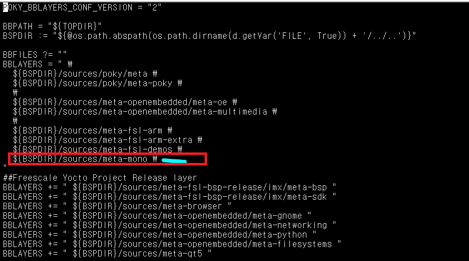

I did following things,
1. Downloaded meta-mono = git clone git://git.yoctoproject.org/meta-mono
2. Added meta-mono to the sources directory
3. Added the meta-mono layer path to conf/bblayers.conf
bblayers.conf.png4. When I try to build a image by using command "bitbake core-image-mono" , there were so many errors as below.
Could you give me any advice?
