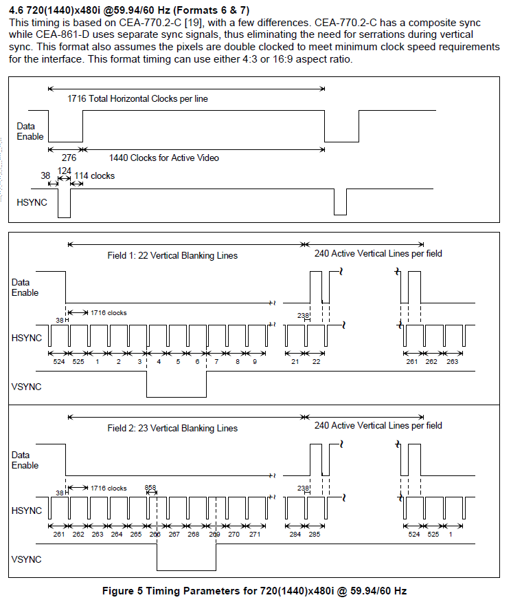

The configuration is :
setenv vidargs video=mxcfb0:dev=lcd,LCD-480I60,if=RGB24,bpp=32 video=mxcfb1:off video=mxcfb2:off video=mxcfb3:off fbmem=32M
The ADV7393 is configured with an fpga with the table 77 of his datasheet.
i2c_register_full_write(0x17,0x02); i2c_register_full_write(0x00,0x1C); i2c_register_full_write(0x01,0x00); i2c_register_full_write(0x80,0x10); i2c_register_full_write(0x82,0xCB); i2c_register_full_write(0x87,0x80); i2c_register_full_write(0x88,0x10); i2c_register_full_write(0x8A,0x0C);
Do you have any idea how i can resolve my problem.

qiang_li-mpu_se
For your 16 bits data line + HSYNC + VSYNC + pixel clock use case, I think you can use the L3.0.35_4.1.0_GA_HDMI_Interlaced_Mode_Patch. But you need select a video mode for your AD723.
For 27M pixel clock, the followed two modes can be tried:
 /* 1440x576i @ 50 Hz , pixel clk @ 27MHz */
 "LCD-576I50", 50, 1440, 576, 37037, 138, 24, 39, 4, 126, 6,
 0,
 FB_VMODE_INTERLACED,
 0,},
 /* 1440x480i @ 60 Hz , pixel clk @ 27MHz */
 "LCD-480I60", 60, 1440, 480, 37037, 114, 38, 31, 8, 124, 6,
 0,
 0,},

qiang_li-mpu_se
The current LCD-480I60 (1440*480i60) display mode is from CEA-861 specification, "720(1440)x480i @59.94/60 Hz (Formats 6 & 7)". I think you need check with adv7393 vendor and measure the signals to identify why it can't work.

qiang_li-mpu_se
In normal case, you need adjusting the timing parameters to meet your TVin chip's requirement. You'd better get the required waveform from vendor, then measure the current waveform to identify the issue.
Use CEA-861 as example:
7,709 Views
morelmathias
HI Qiang Li - Mpu Se
I take a look on the signal generated by 1440x480 and the first change i need to make is not only parameter in "mxc_lcdif.c" file
The ADV7393 datasheet "Figure 6. SD Input, 16-Bit 4:4:4 RGB, Input Mode 000" show that RBG shall be change at 13.5MHz with clock at 27MHz and HSYNC/VSYNC synchronized on this 27MHz clock.
Do you think i can change the width parameter in active pixel?

qiang_li-mpu_se
The clock repeat mode (two pixel clocks transfer one pixel data is not supported in IPU driver), but from hardware interface, it should be the same signals with 1440*480@27MHz

morelmathias
Thx for the reply,
I tried this because you write that :
        CEA format 5: 1920x1080i @60Hz
        CEA format 6&7: 720(1440)x480i @60Hz
        CEA format 20: 1920x1080i @50Hz
        CEA format 21&22: 720(1440)x576i @50Hz
i tried the LCD-NTSC mode but no video output.
i think is because the pixel clock is 13.5MHz
+ /* 720x480i @ 60 Hz , pixel clk @ 13.5MHz */
+ "LCD-NTSC", 60, 720, 480, 74074, 114, 38, 31, 8, 124, 6,
+ 0,
+ FB_VMODE_INTERLACED,
+ 0,},
For me is more an ipu stability issue.
The glitch and the error message are related.
Q1 : Which input should be the easier to generate?
Active Resolution    I/P1        Frame Rate (Hz)               Clock Input (MHz)                 Standard
720 × 480                 I                  29.97                                 27                                ITU-R BT.601/656
720 × 576                 I                    25                                    27                                ITU-R BT.601/656
640 × 480                 I                   29.97                              24.54                            NTSC square pixel
768 × 576                 I                    25                                  29.5                              PAL square pixel
I tried the first 2, but maybe the 2 others are easier to generate...
Q2 :
Do you think i can make something like this?
+ /* 1440x480i @ 60 Hz , pixel clk @ 27MHz */
+ "LCD-480I60", 60, 1440, 480, 37037, 114, 38, 31, 8, 124, 6,
+ 0,
+ 0,},
+ /* 720x480i @ 30 Hz , pixel clk @ 27MHz */
+ "LCD-480I60", 30, 720, 480, 37037, 114, 38, 31, 8, 124, 6,
+ 0,
+ 0,},
