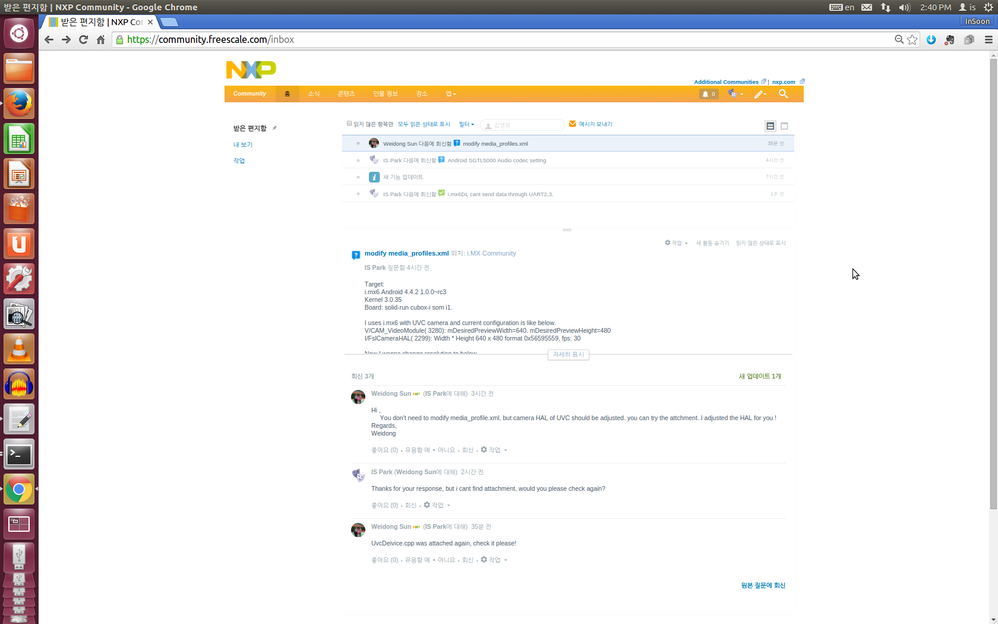

Sorry but I cant find link or attachment for UvcDeivice.cpp .
would you please let me know where should I download?
