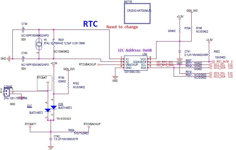

Hi,All:
imx6 rtc-ds1307.c how to make the RTC circuit can drive?
The need for additional write control code for this driver controls it?
For example: using interrupts
Please help me ,thank.
Circuit is as follows:

igorpadykov
Hi Chen
please look at attached Porting Guide sect.7.3 Using the I2C Interface
for irq example :  http://android.serverbox.ch/?p=972
igor
