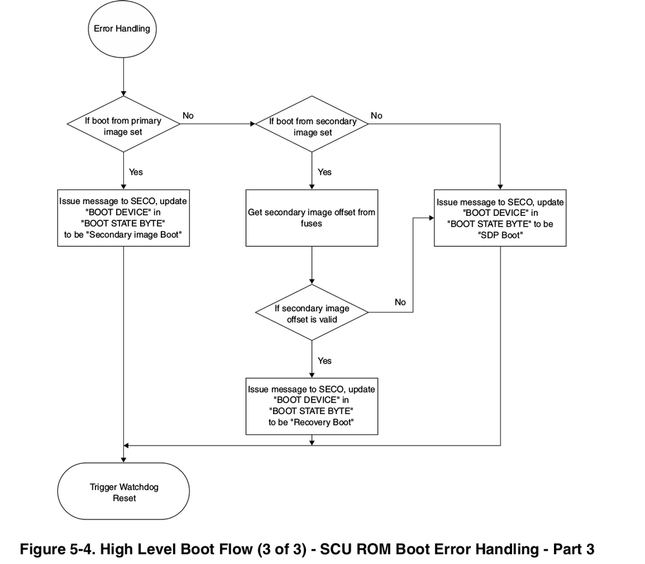

We have observed that with the SanDisk Extreme, Western Digital, Industrial, and other brand microSD cards that after strenuous use our system no longer boots up. Upon probing the SDIO bus we observe the CMD0, CMD8, and then CDM55 and ACMD41 repeatedly issued for roughly 300mS before a system reset occurs. I believe this is because these cards have not ~yet~ set their “Busy Status” bit and therefore their file system contents cannot yet be accessed. This system reset originates from a Watchdog strobe event on the i.MX 8 SCU_WDOG_OUT pin.
I read in the “SD Specifications Part 1 Physical Layer Simplified Specification Version 9.10” document in section 4.2.3 that “The host repeatedly issues ACMD41 for at least 1 second or until the busy bit are set to 1.” This reads to me like the i.MX 8 violates SD specification by not allowing 1 full second after the first ACMD41 message for the card to become ready.
We believe we've identified the source of this Watchdog event - the SECO hardware reset timer. The i.MX 8 Hardware Reference Manual states in section 5.7.3.3 that "There is a hardware reset timer enabled by default on the SECO side. The timeout of this timer is 300ms...". Since the firmware resides on the microSD card and the CPU/PMICs execute a system-wide power cycle before the microSD card is ready, our system gets caught in a boot-reset loop indefinitely.
Is there a way we can extend or suppress the SECO reset timer?

sorry for delay, your information is limited, I need more detailed information, you design your own imx8qm board, right? firstly, could you confirm if your HW design is total correct? then which stage do you get such error? it seems you stuck in the uboot stage, right? for HW WDOG, refer to the RM,
If the WDOG has been enabled, the below scenarios is when the SCU ROM will service
the WDOG:
• After loading the Image Container Set0 header.
• After loading the Image Container Set1 header, provided that the secondary boot has
not been disabled by fuse.
• After loading an image. If the image is bigger than the size which can be loaded
within the WDOG timeout, depending on the image size and the speed of the boot
interface, a WDOG timeout will occur and the chip will reset.
• After entering USB boot loop
The system controller includes watchdog hardware (WDOG) to protect the system by inducing a warm reset if the SCFW is unable to periodically service the WDOG timer. By default this is enabled by the SCFW at boot with a timeout of one second

this 300ms couldn't be changed by customer, I'm afraid you used very old chip, in the newer one, this issue has been fixed, I found errata for this issue, I think this should be your problem, you can check it
ERR050108: ROM: eMMC/SD boot failure due to ROM code timeout under certain conditions
Description
This issue is related to boot from eMMC or SD devices. On power-up, a boot monitor timer is initialized. On a successful boot, SECO firmware is loaded and run from the boot device—that is, eMMC or SD, which, after loading and verifying SCU firmware (SCFW), disables the timer. When a successful boot requires more than 300 msecs, a timeout occurs that is considered a boot failure, and therefore generates a warm reset, which results in a looping boot failure.
Typically, the initialization time for most eMMC/SD devices is about 100 to 200 msecs, however, the eMMC/SD specification allows up to 1 second for this initialization time.
Any eMMC/SD device that exceeds the timeout to initialization will fail to boot. Sudden power loss or power cycle stress testing to eMMC/SD devices can cause data corruption, which can force the eMMC/SD device to run an internal data check on the next
power up, which results in a longer initialization time, forcing a timeout and a looping boot failure.
Workaround
Generally reducing eMMC/SD initialization time under 300 msecs is the most effective way to avoid this looping boot failure.
For the data corruption case, change the boot mode to serial download mode then load and run an image via USB. This image can initialize the eMMC/SD device and exit out of the internal data check state.
In future silicon releases, ROM will consider this case and wait 1 second to avoid the boot failure.
