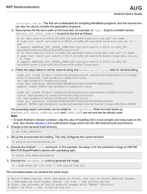

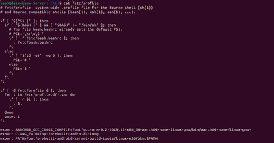

unable to run menu config
With the user guide i have set /etc/profile/

Hi @MJD
Thank you for contacting NXP Support.
Can you point out the exact part that you are following from the Android User's Guide?
Android User's Guide (nxp.com)
Have a great day!
1,675 Views
MJD
Hi @brian14
This is user guide followed.
AUG
Rev. android-13.0.0_2.0.0 — 31 July 2023
1,656 Views
brian14
Hi @MJD
Thank you for your reply.
It seems that the toolchain is not set correctly.
You can try removing the project and installing correctly the packages described in the same manual for the host.
Also, I couldn't find the part of "make menuconfig" in the manual. Could you explain the reason for building this? Usually, Android complete image is built using the command "lunch".
